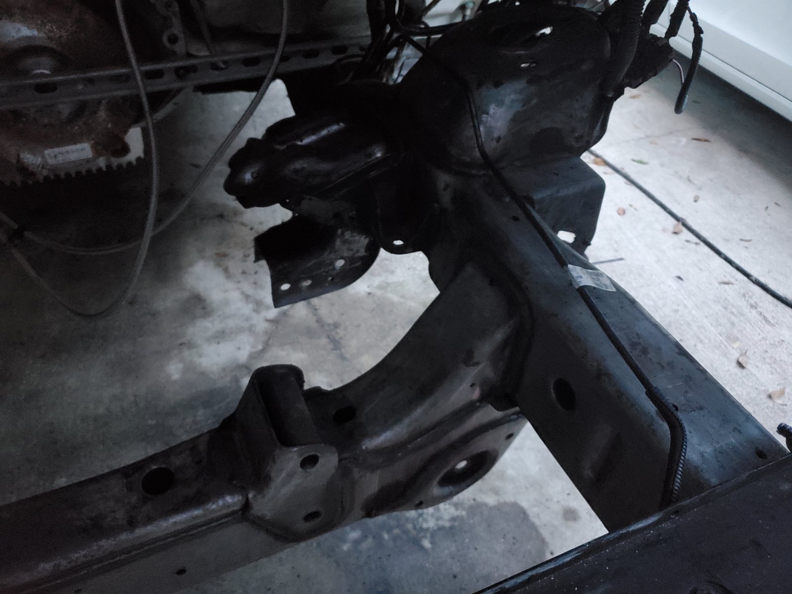

Scraping frame wax off to paint it i guess.
It sucks.

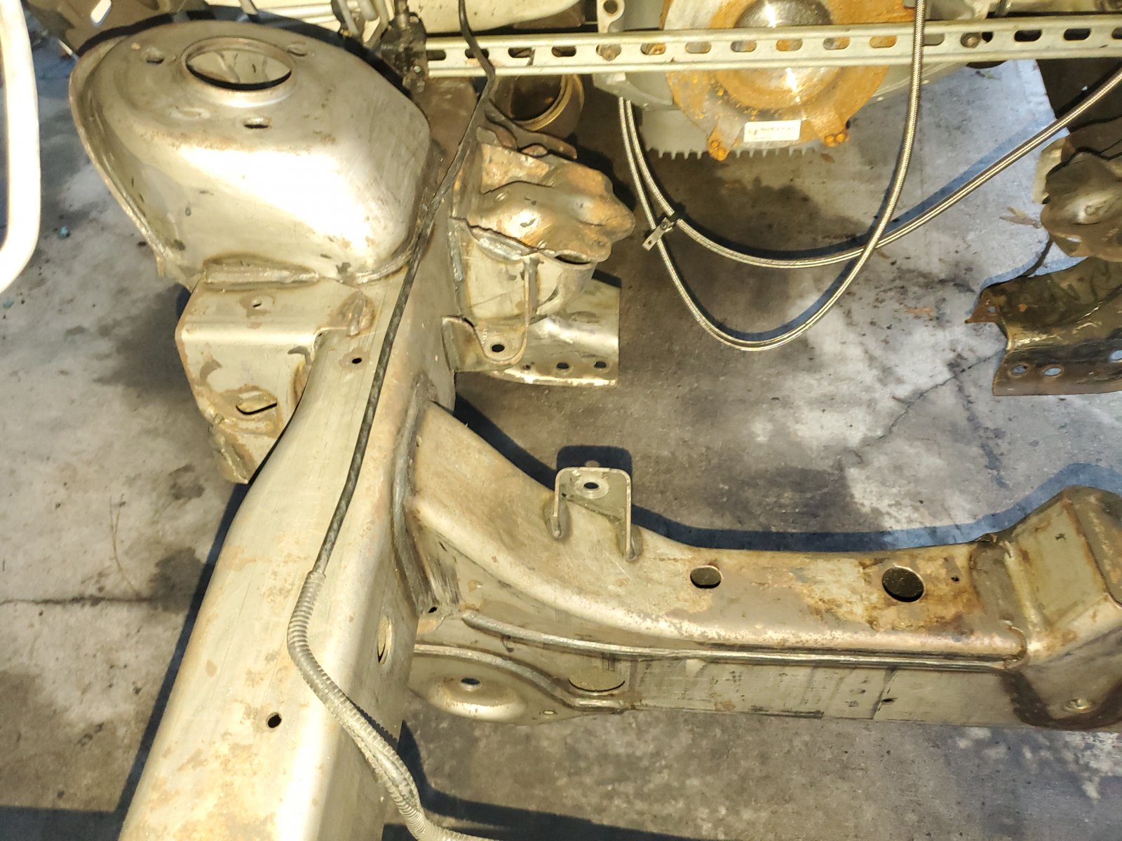

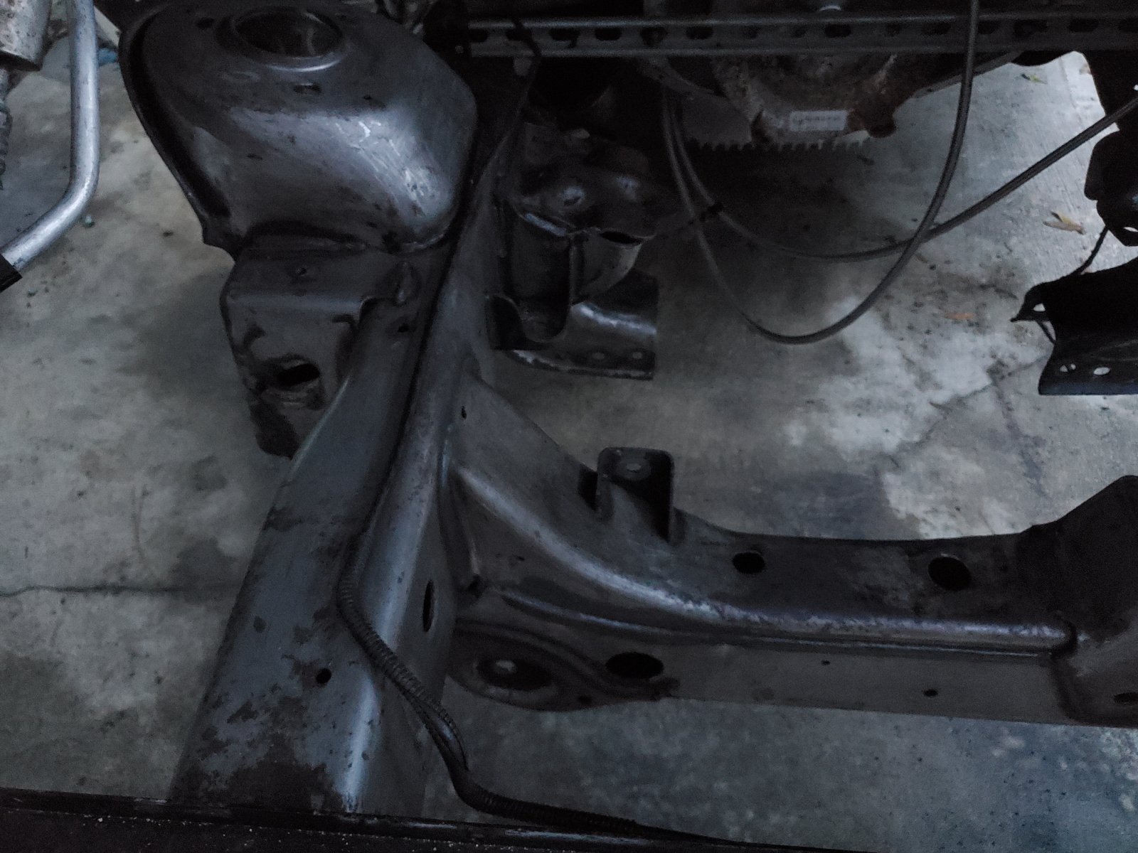

there so many places that there was already rust under the wax that im going to wire brush to clean up before coat. its like 90+ degrees so it doesnt help with the wax as it stays pretty pliable, doesn't "chunk" off, maybe cold (real cold) weather would make this a lot easier. very little of it is smooth but just scrape off as much as you can then cut the wax down with some solvents - using laquer thinner is working pretty well.
removed all the control arms/spindles, shocks etc.... figured it would be a good time to do all the bushing and ball joints anyway so i ordered new arms and spindles (aluminum)

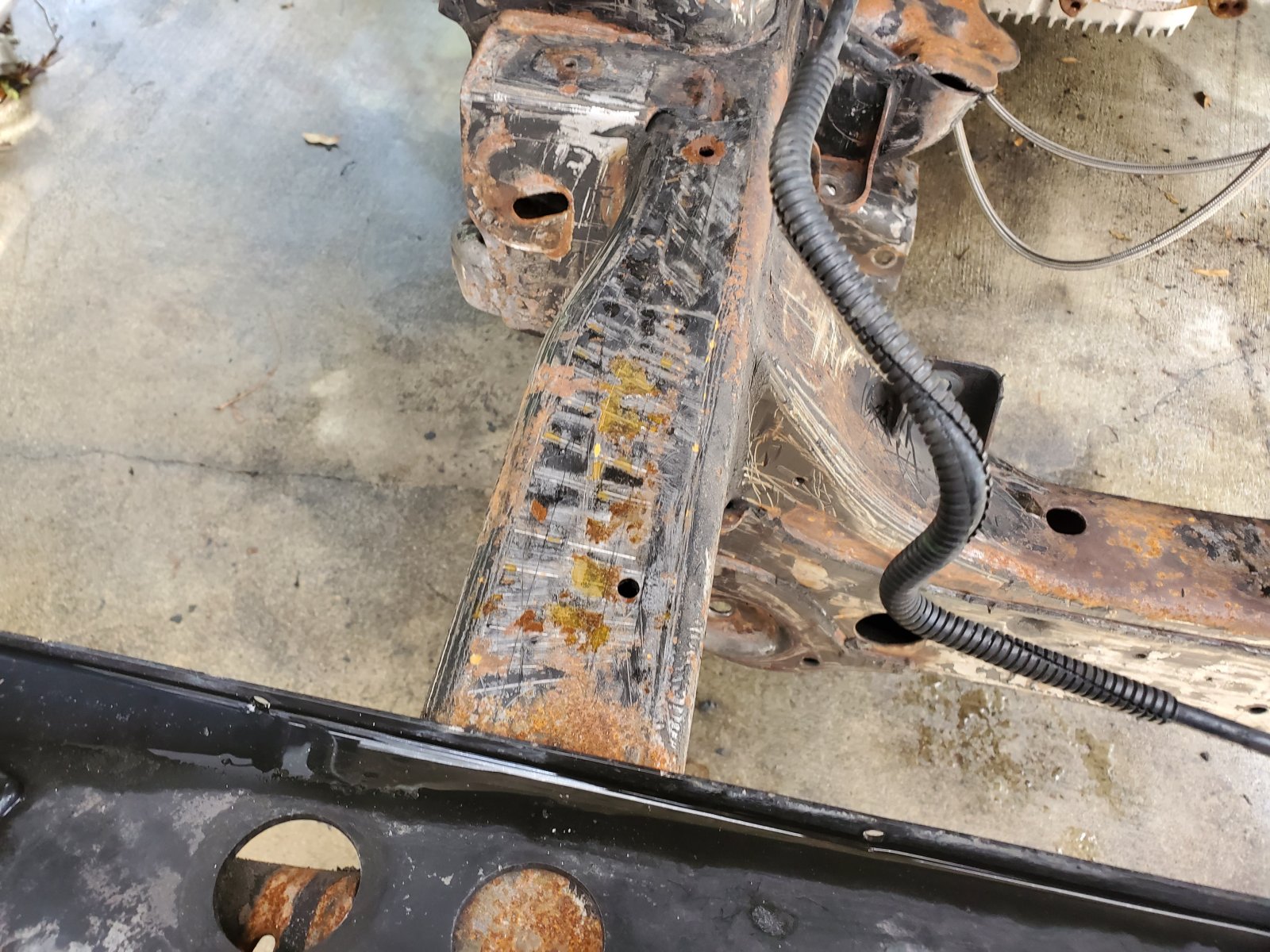

some surface, along the crossmember where power steering fluid has leaked, under the radiator support nothing to bad but is annoying
engine sposed to be back this week so need to get this crap done =\
