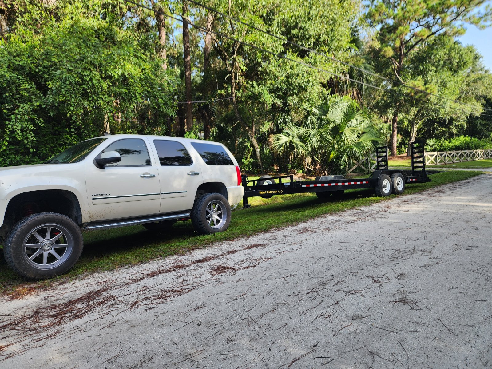

im just dragging trailer across state
bofadeez will be loaded on it and we're going to see @pwtr02ss
the trailer probably weighs more than both of them
