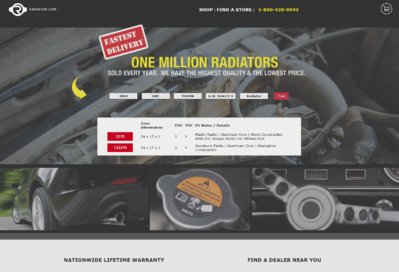

calls for a 34 X 17 x 1 if you have eoc (engine oil cooler) get one with eoc (oil cooler lines on the drivers side), you can still use the same radiator even if your truck does not have eoc it's just a extra feature is all. otherwise there should be no confusion.
these guys are everywhere, not the cheapest but they have good radiators and lifetime warranty
