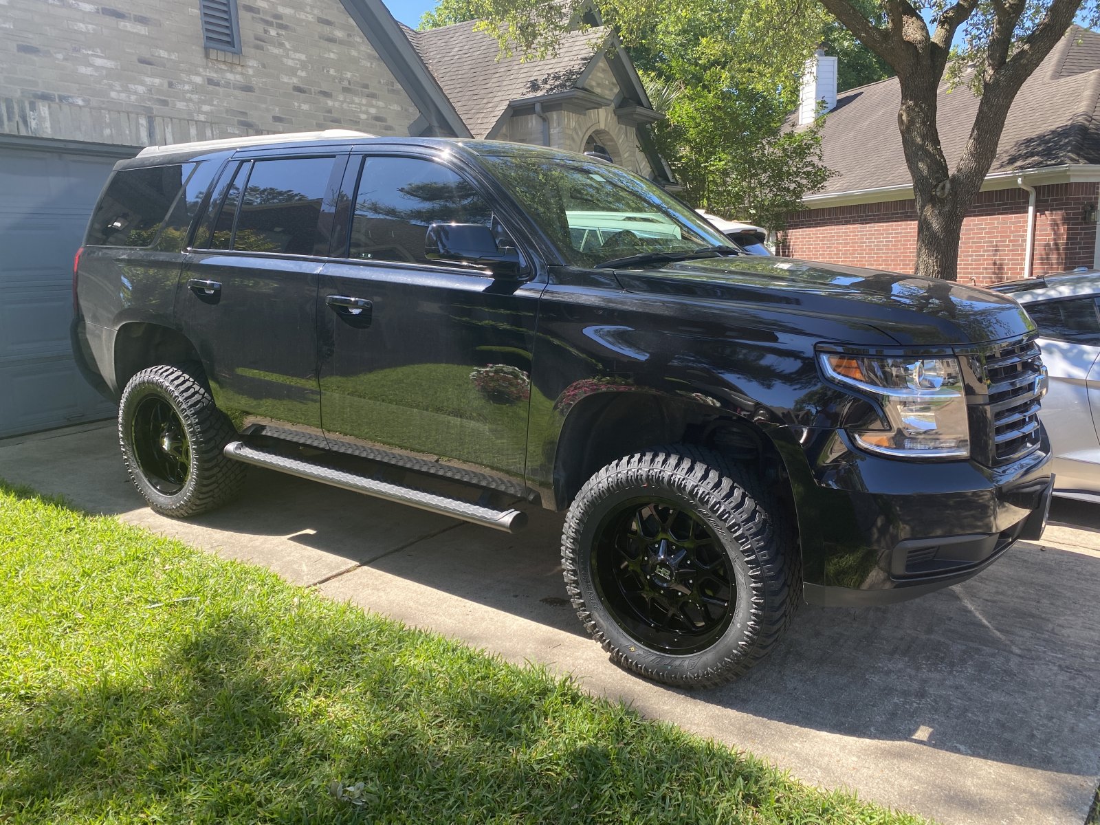

Thank you for the response! Okay, that's understandable now. Any way you could provide a picture of how it looks?
TahoeLife_00795
Apr 26, 2020
Michigan
The lift is 3.5" - Bilstien 5100 lift struts at 2.5" and a 1" upper strut spacer.
2" Hubcentric Wheel Spacers
305/55r20 wrangler Duratracs
full

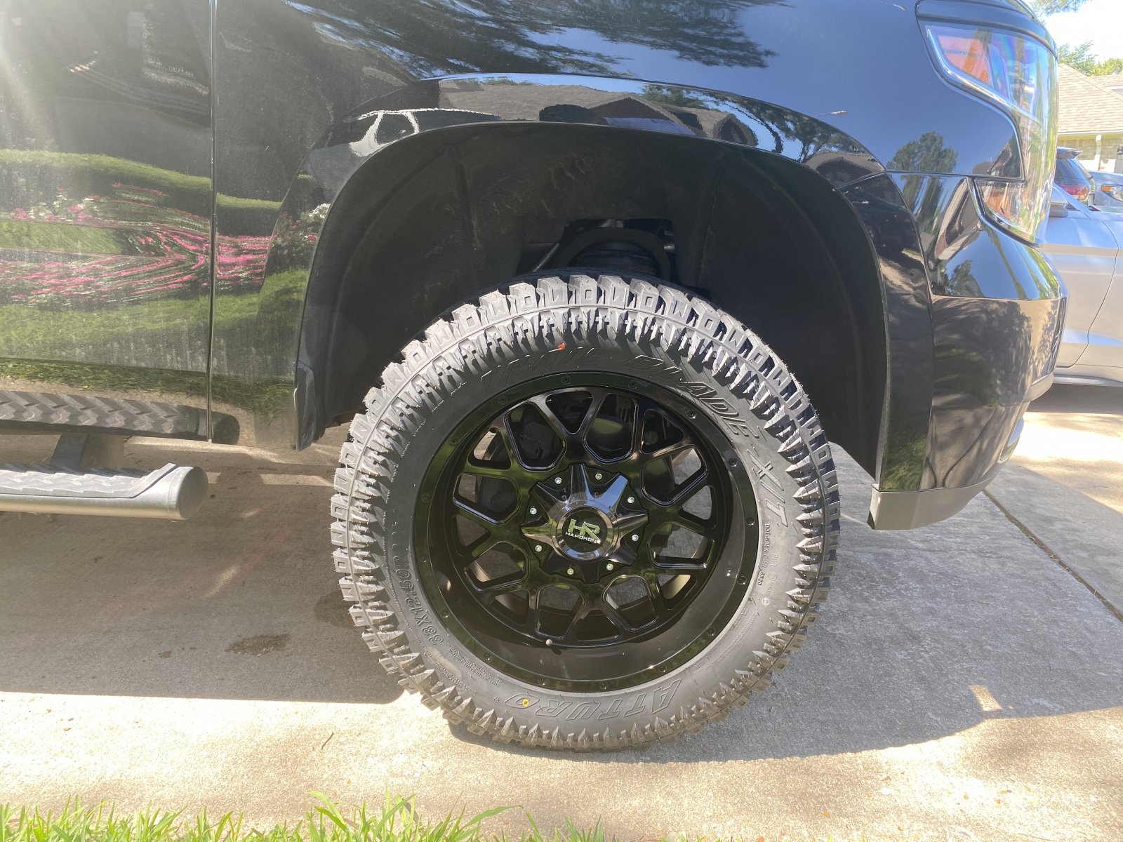

Oh my, she's a beauty!! I really like that setup. How does the drive feel? Thank you for providing a picture for reference. Did you have to replace anything else for the lift to work? Like brake line extension, upper control arm, etc... Anyway you could provide a link to where you purchased? It would be highly appreciated! That setup is EXACTLY what I am looking for! :cheers:
Bigmac18
Oct 27, 2014
168
120
i replaced the upper control arms with tubular arms made for a lift.
I pieced it together. I think everything was from ebay.
1" Motofab upper strut spacer
bilstein 5100 lift struts set at 2 1/2
New Upper Control Arms Link

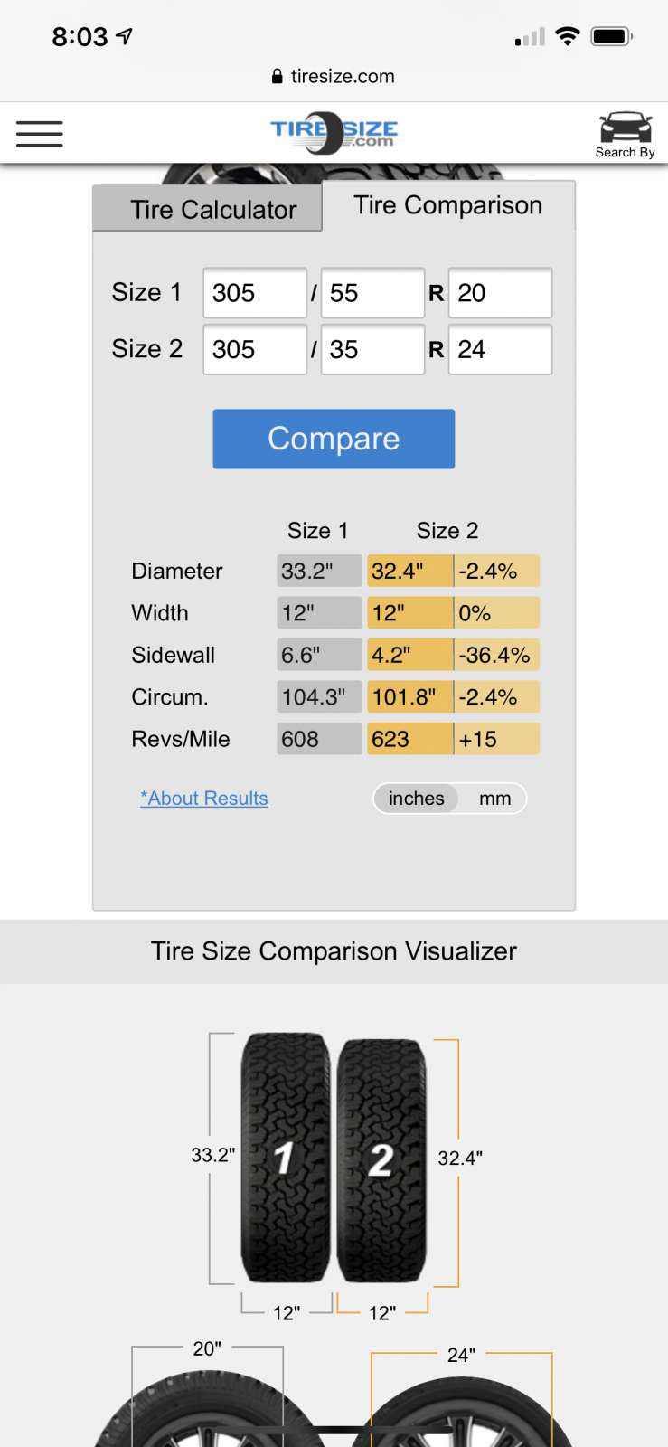

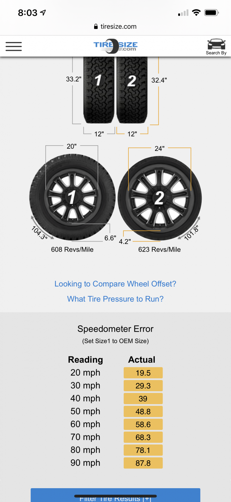

I have 305/35r24 on my '15 Tahoe. That equates to 32.4"x12" There's not much more room in there on stock height. May have some rubbing issues with the 33x12.50r20
