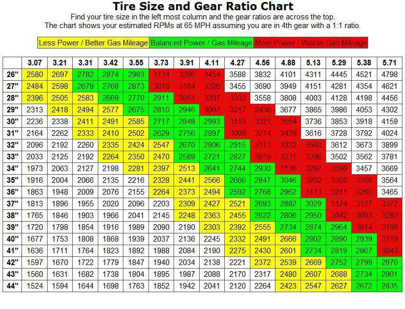

If you look at a gear ratio and tire size it's pretty easy to answer the question.
