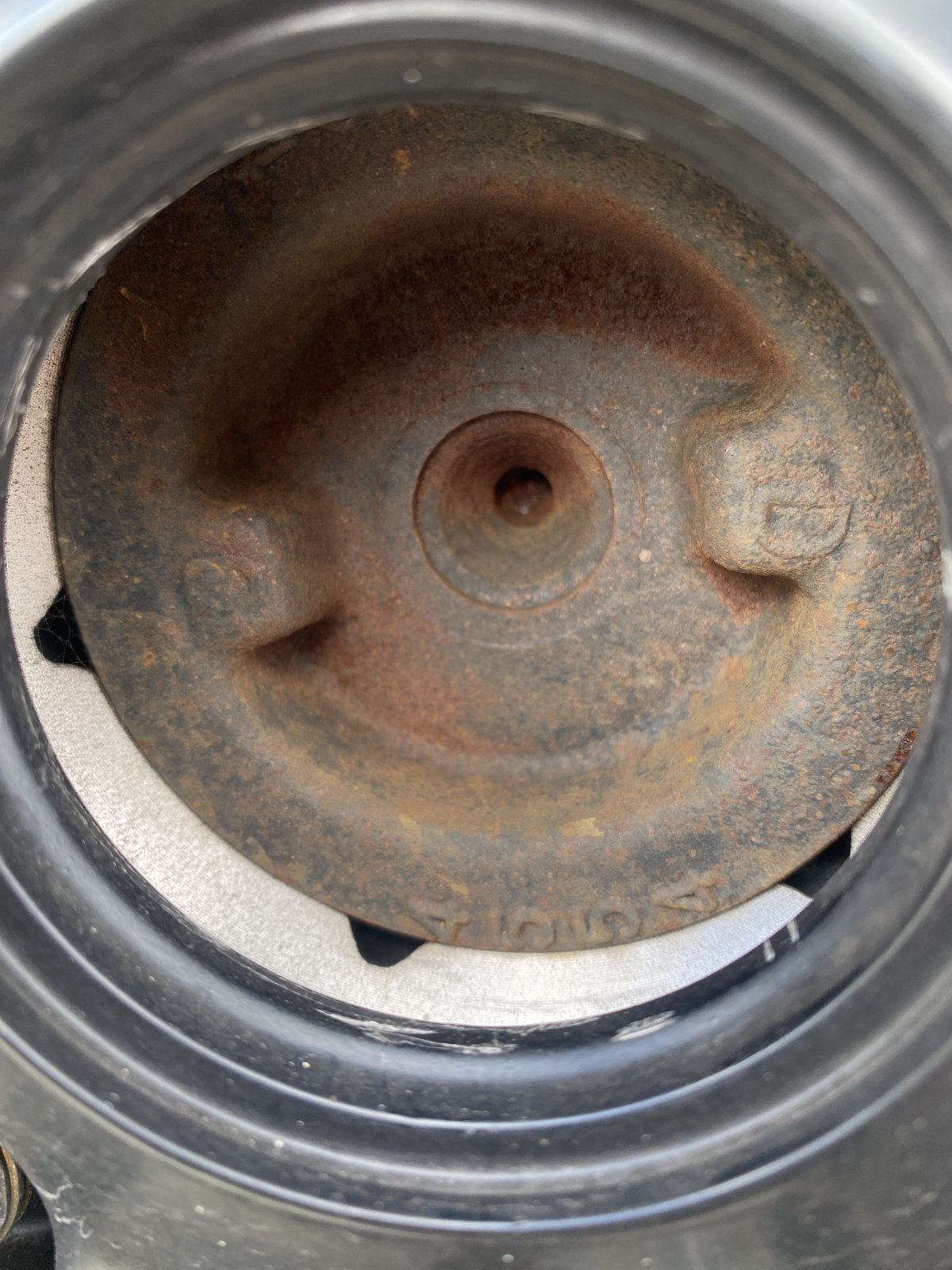

I'd be curious to see a picture of the Mopar wheels on your GM.

I haven’t measured the center bore of these rims yet, but will do so when I take them off to install the spacers I ordered (which is what sent me down this rabbit hole to begin with). I’ll measure my center bore of the hub too.
I would prefer everything sits extra tight, especially if adding spacers.
In any case, here are the wheels in case you are wondering which ones they are.
