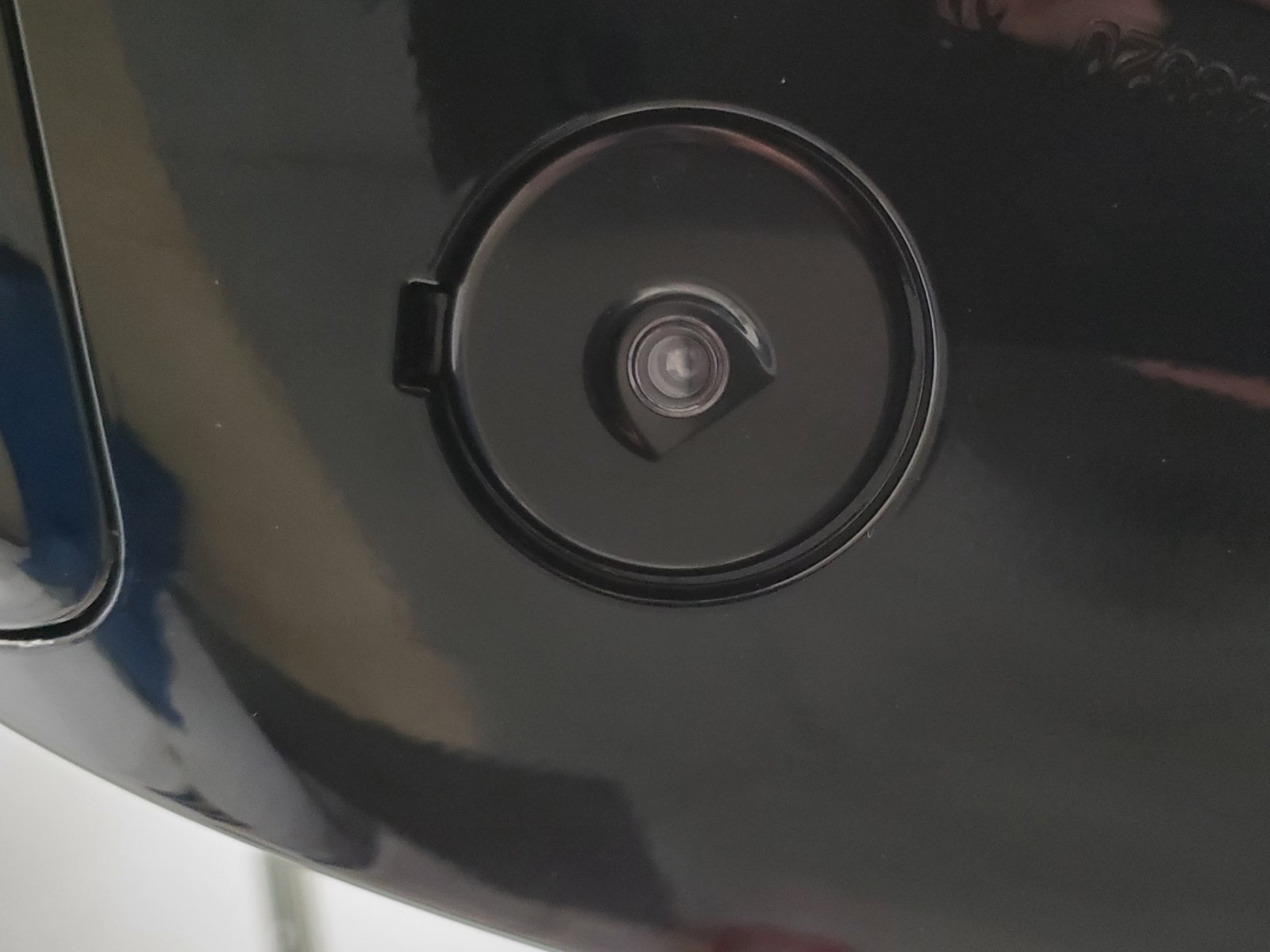

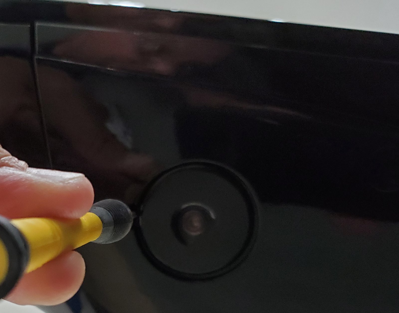

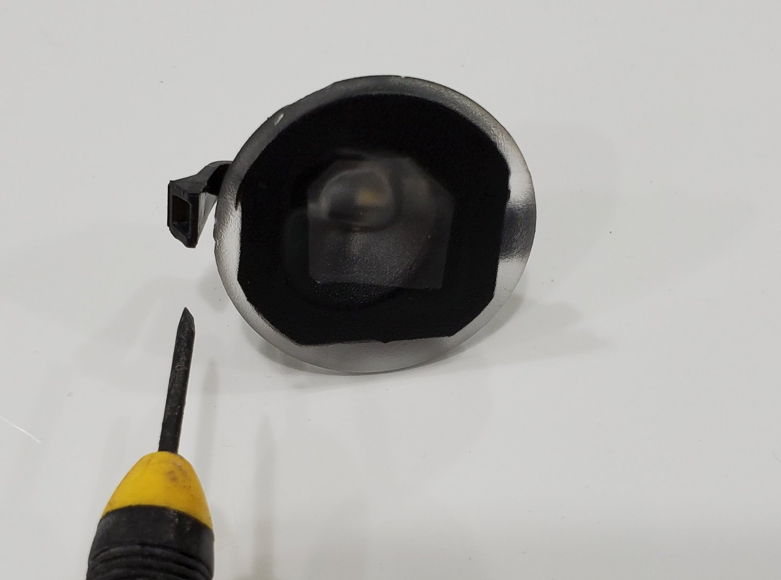

Pop one out and see

About $125 ish GM Site and eBay…..ask me how I know…..
Takes about seven minutes, a small flat head screwdriver/. Press, release and reverse steps to install. Make a note of the ordering and color codes. Two color codes per vehicle but directions are generic for all three. Same wiring only difference is what logo illuminates.

So i actually took the puddle light out and disconnected them and plugged them back in and the puddle light finally came on. New puddle lights with chevy logo due to arrive tomorrow.
