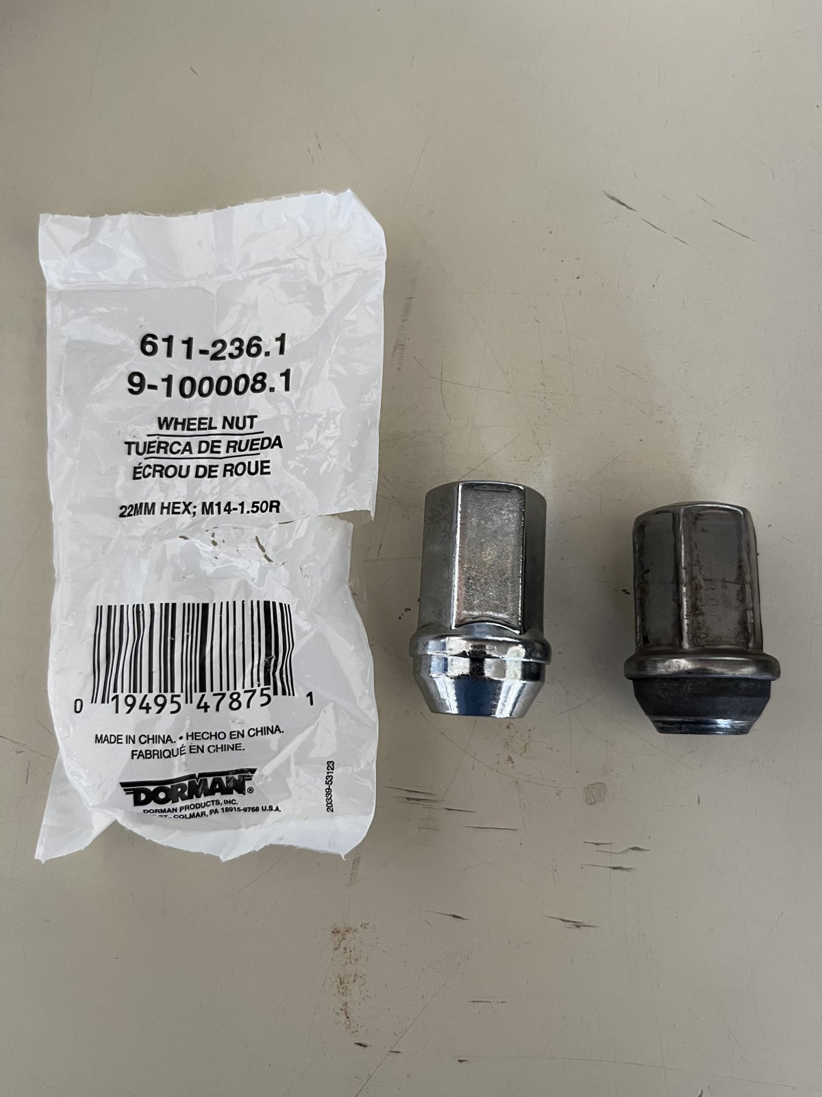

Factory one on right. Dorman on left. Autozone has them

I had the open ended lug nuts on my steel rims. They were worn and tapered a bit along with the holes on the steel rims. I bought a set of they OEM alloy rims on Craigslist and the guy gave me all of the lugs as well. They were also short and open ended but weren't as worn. The center cap covers them up anyway.
