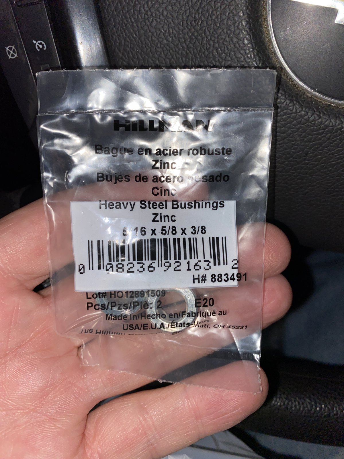

I found aluminum spacers at Home Depot that are the same size as the factory spacers. Dimensions are 5/16" inside diameter x 5/8" outside diameter x 7/16" length.
Also, the factory spacers have 2 O-rings that hold the spacer on the bolt from the inside of the center cap. I just used one O-ring, which is 1/4" inside diameter x 3/8" outside diameter.
See attached image for reference.
