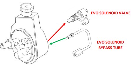

Your 2002 may of may not have had the EVO system, but it sounds like yours did. This system was an abject failure, and GM discontinued its use during the early 2000's, and in fact subsequently offered an EVO bypass tube to eliminate it on trucks that already had it installed. Look at the photo below, and determine/confirm if your original power steering pump had the EVO Solenoid valve connected to it.
