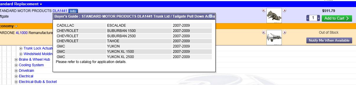

the early one's are pricey!, you'll have to look at the one in the 2009 and see if it is the old style or the new style, part of the reason I bought a 2012 was the wide part compatability/crossover years
More Information for STANDARD MOTOR PRODUCTS DLA1441
OEM / Interchange Numbers: 15810320, 25889603
Thanks for the RA look! I went there and I couldn't find the part.
I tried liftgate motor, rear hatch motor, power lift gate. Got zero hits. Never typed in trunk smh
I found 9-10 ebay listings and they all say 07-14, but I wasn't convinced.
