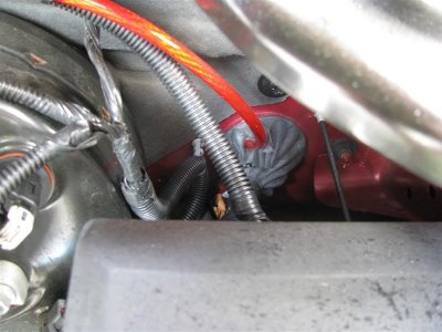

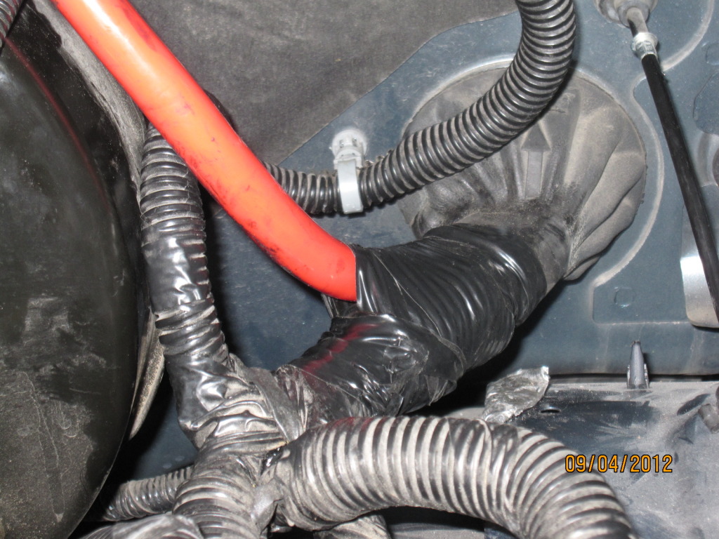

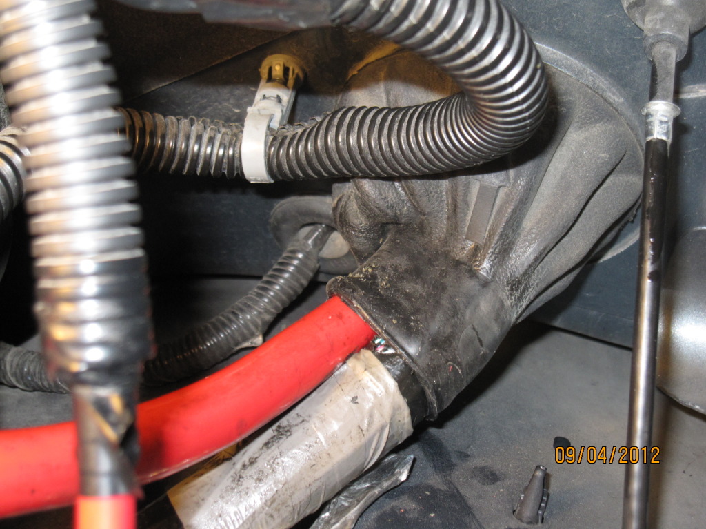

There is no open hole but under the master cylinder is a rubber boot with a few wires going thru. About an 1.5” hole. Untape and youll be able to get thru there. Il try and find a picture. Or when i get home tonight ill take one of mine.

Like these... but do it right, dont just punch a hole....

Pickups and tahoes share a firewall and there is a punch out for the plow wires on pickups, when equipped, gm did run wires through there tho even if there is no plow pkg... your wires will fit.... just lube them up a little.
