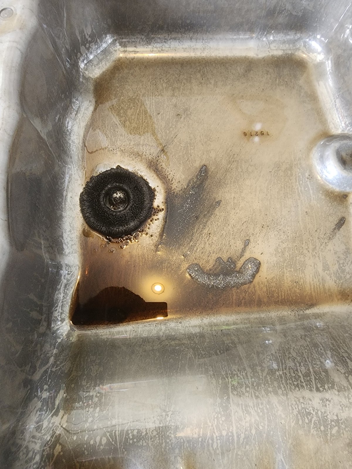

well results are in what yall thing? Time for a new tranmission? Can I just get a TCC or normal for 136k with never doing tranmission, feels alot better feel a very small.sputter still

At 135,000 miles that looks about perfect. Tranny clutches wear as you use the car and you end up with some stuff in the pan. Sorry, no experience with the TCC, I hope others chip in.

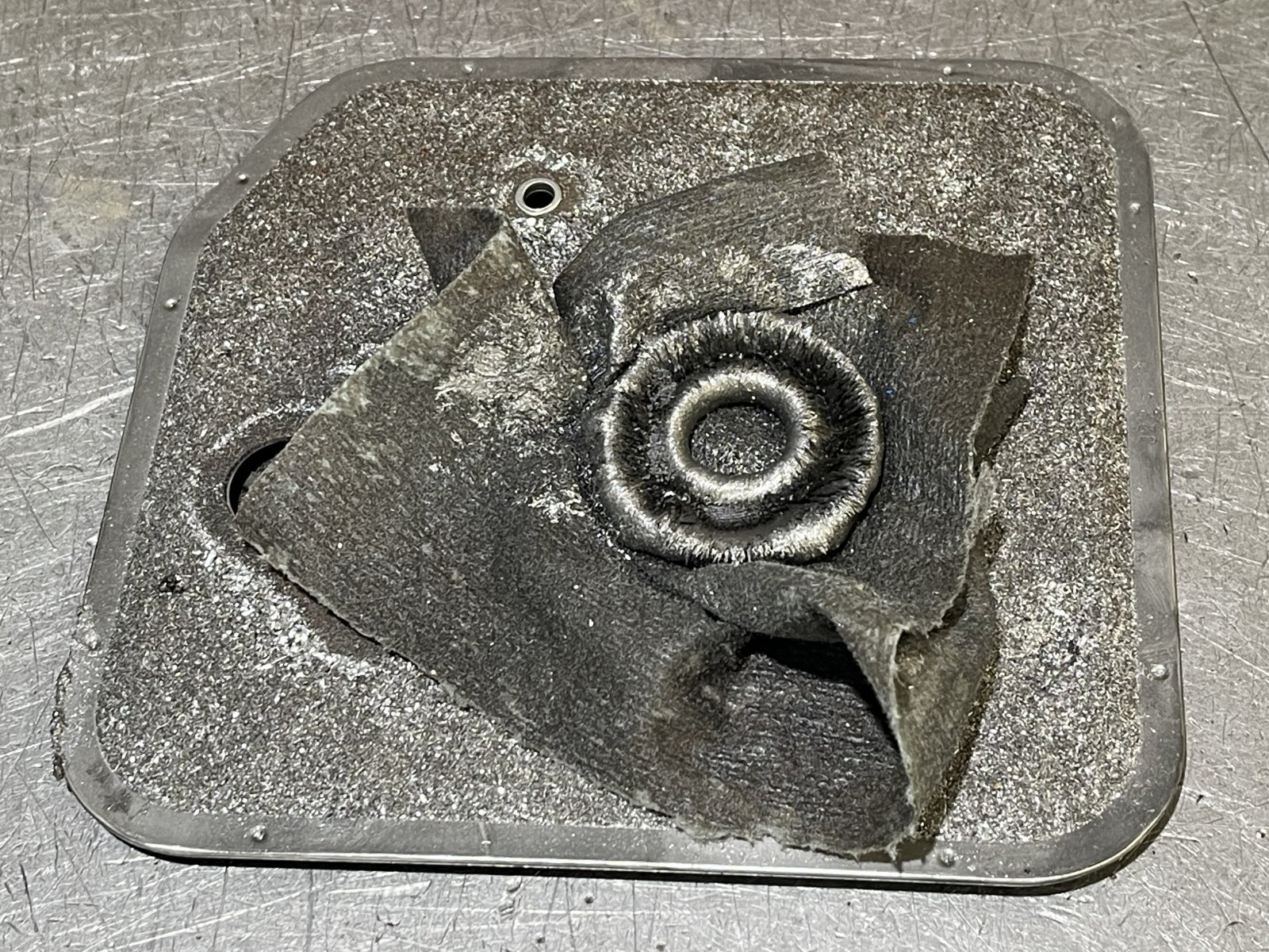

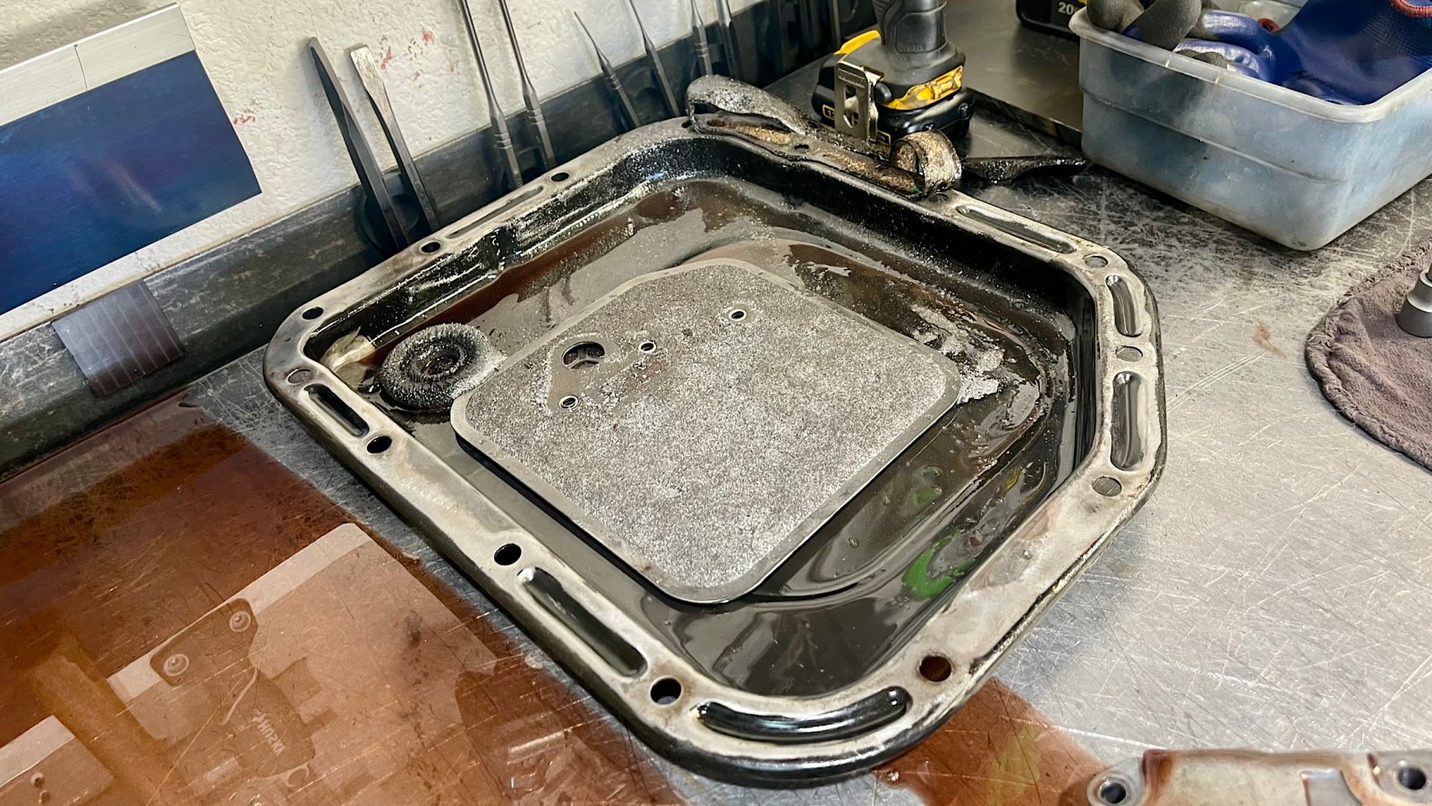

Time to yank it out for overhaul. All that fine, ground up metal is everywhere inside the transmission as well as throughout the trans cooling system. Id replace the radiator and any external trans cooler currently installed.
Here's a recent example of a converter disintegrating internally (A904 from a 02 Jeep Wrangler). IMG_1641.jpegIMG_1638.jpeg
