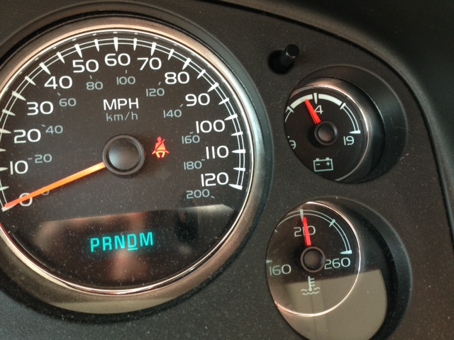

2014 Yukon XL SLT. Whenever the vehicle is driven for more than about an hour I notice that the volt meter drops a good bit below 14 volts. None of my other GM vehicles do this (Corvette, Sierra dually). I don't notice it happening on short trips, like a grocery store run. Only on extended trips. I read the sticky on steady voltage - is this what I am experiencing? It concerns me enough that I took a photo of my gauge cluster.
Should I be concerned?

I don't like it either but yes that is normal to happen. Nothing to worry about.

Normal. Its part of the charging system that reduces the load on the alternator and battery, when the battery is fully charged and you are driving for longer periods of time.

Thanks, guys. This is the first vehicle I've owned that did it. I was thinking I had a bum alternator. Makes sense that I only see it on the longer trips.
