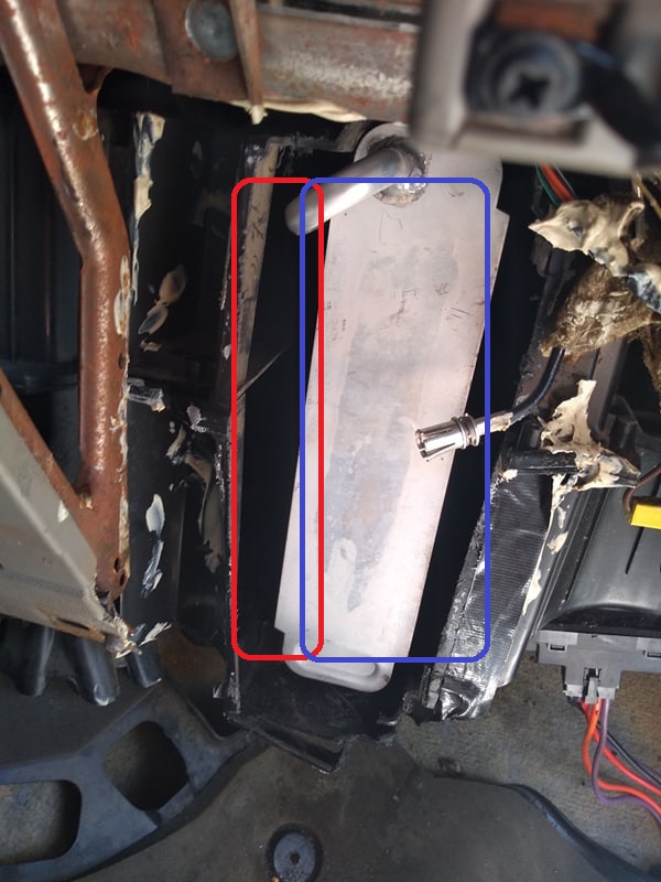

Pulled off all the garbage. They had some other plastic that was terrible at sealing. Also feel like there is too much gap around the evap. ie air flow bypassing the evap. Would some of that expanding foam sealant work good in this instance?
I would worry about molding issues if going to use foam. Maybe pickup some vinyl or plastic sheeting, or some kind of plastic laying around the garage like old oil jugs or trash can lid or something. Trim to fit and build a new cover using silicone adhesive?
The foam Im referring to is for home insulation so I would think (hope) it is very mold resistant.
As for plastic, that is what was on there. With it there was at least 1 1/2 gap for air to flow around the evap. IDK if that would be by design as I dont have another enclosure to compare to. I already taped it back up, seems a little cooler, but air flow is still quite terrible. Evap and blower look off the shelf new.

So I now have the enclosure wrapped up in Gaffe tape (much better).
I decided to pull back a portion to feel the temp of the Evap after touching the lines near the drier. Hi side is hot and low side is super cold. So thought to do the same with the evap.
So reached in and felt the evap on outlet side (red) had a ton of condensation and was much colder than what Im feeling at the vents. But also while on that side, I felt a ton of heat... hot rather. Fan had lots of flow on both sides (blue), but almost feels like I get more from opposite of blower motor; both were cool or cold.
Im curious to the the internal operation of the enclosure. Does anyone have a schematic?

Did someone cut away the plastic and expose the evaporator?
Yes sir. Evap looks new along with blower.
I have peeked inside and both doors are closed on heater core so that is fine.
My money is now on the actuator that controls the where the airflow goes.
I made adjustments on the controller and didnt see it move. It also blows out of floor and vents at all times; never changes. Im wondering if there is a perfect point in the adjustment that causes terrible air flow... also being exactly there the actuator failed.
