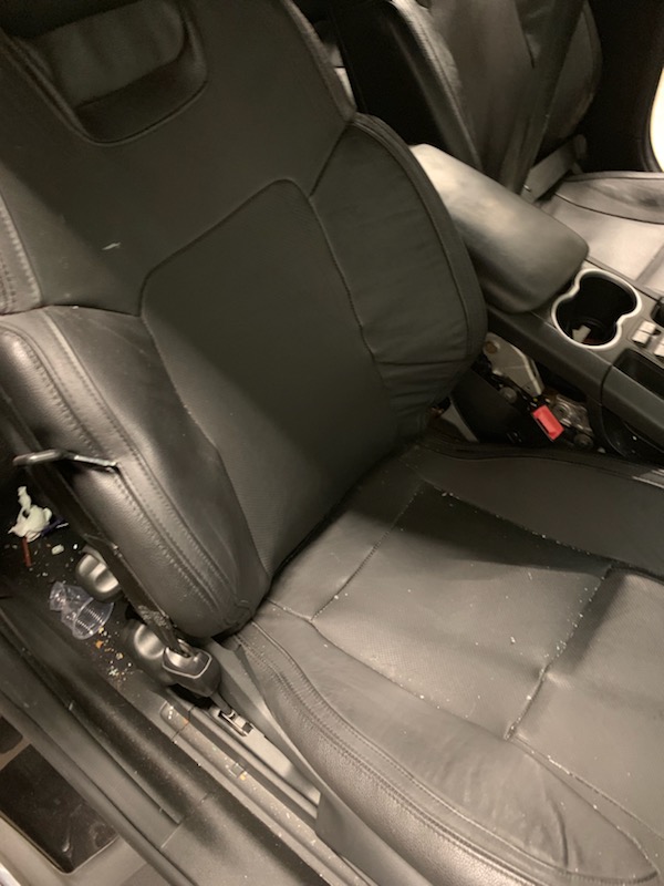

Something like this ...

Just know that the tilt/recline adjuster is a knob that you turn to bring the seat back forward or back. Really shouldn't be an issue in a Tahoe- you set it where you want it and it should pretty much stay there. But I thought it was kind of a cheesy function.
