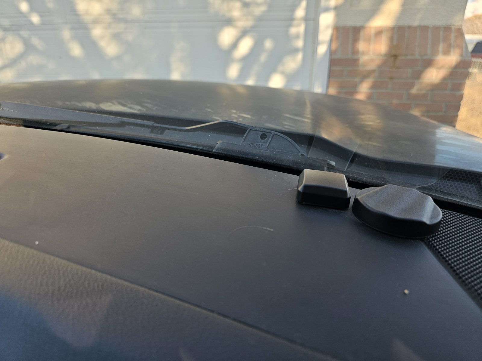

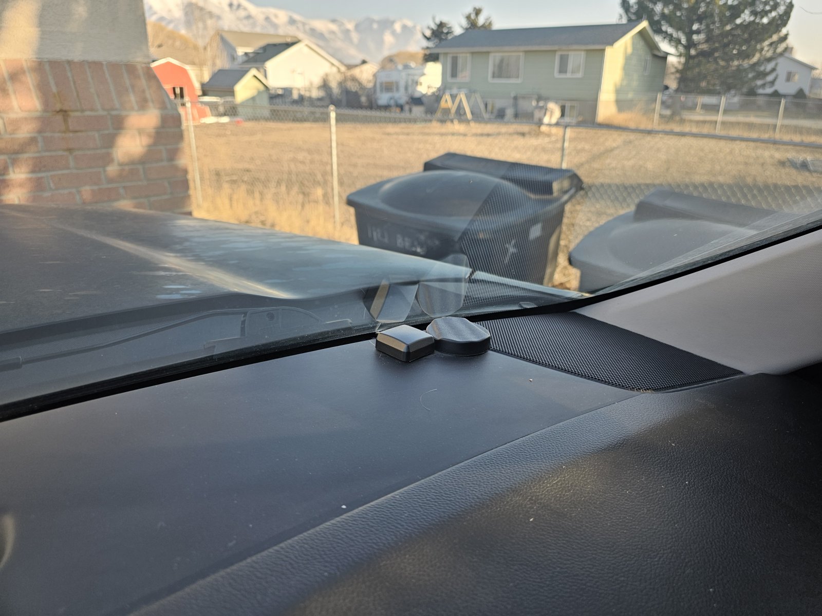

Second is these little pads on the dash under the windshield on the passenger side. No idea what they are.

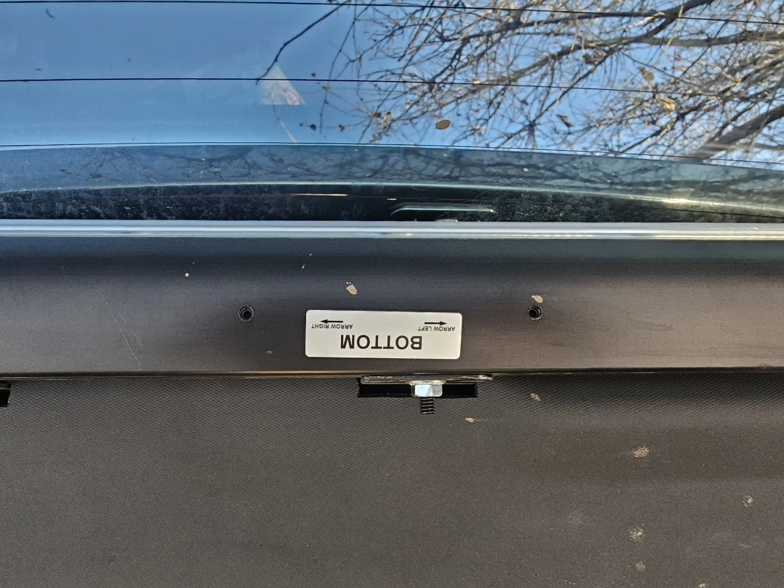

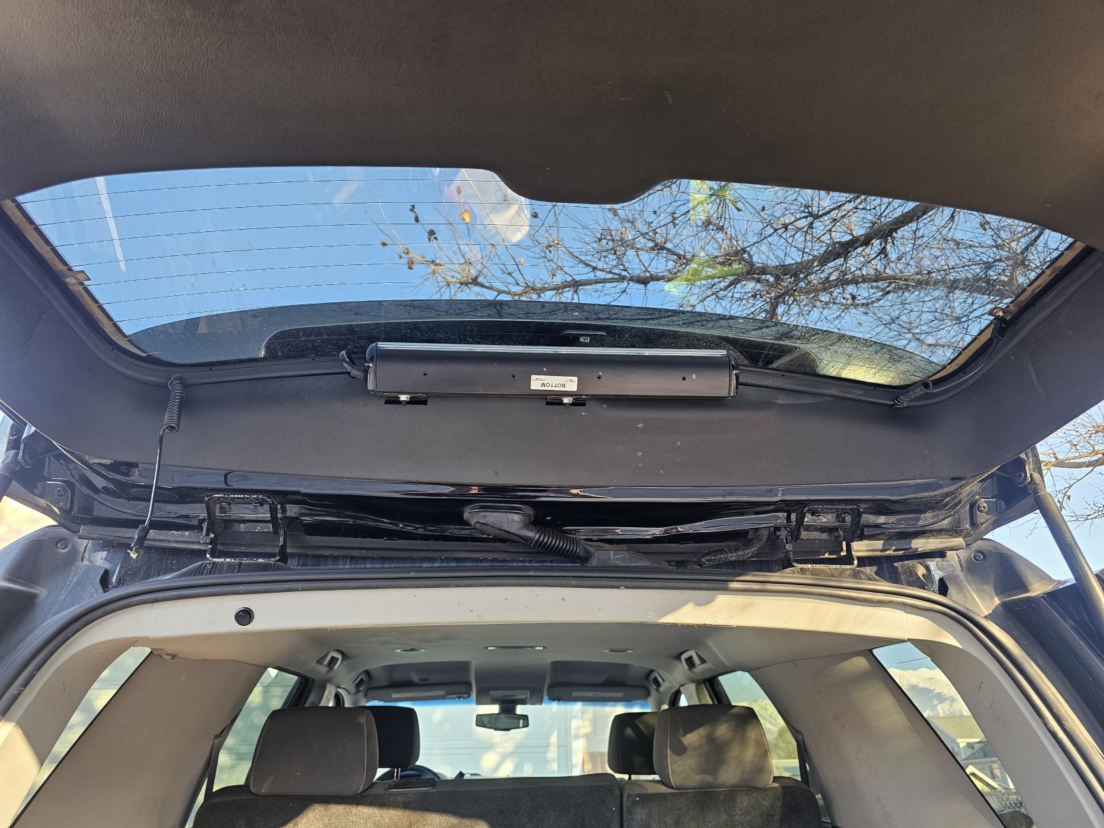

Then there is this light bar in the back window. Says "arrow left" and "arrow right" so i'm assuming it's just traffic hazard arrows.. Could i use thses? where would the ends of the wires go?

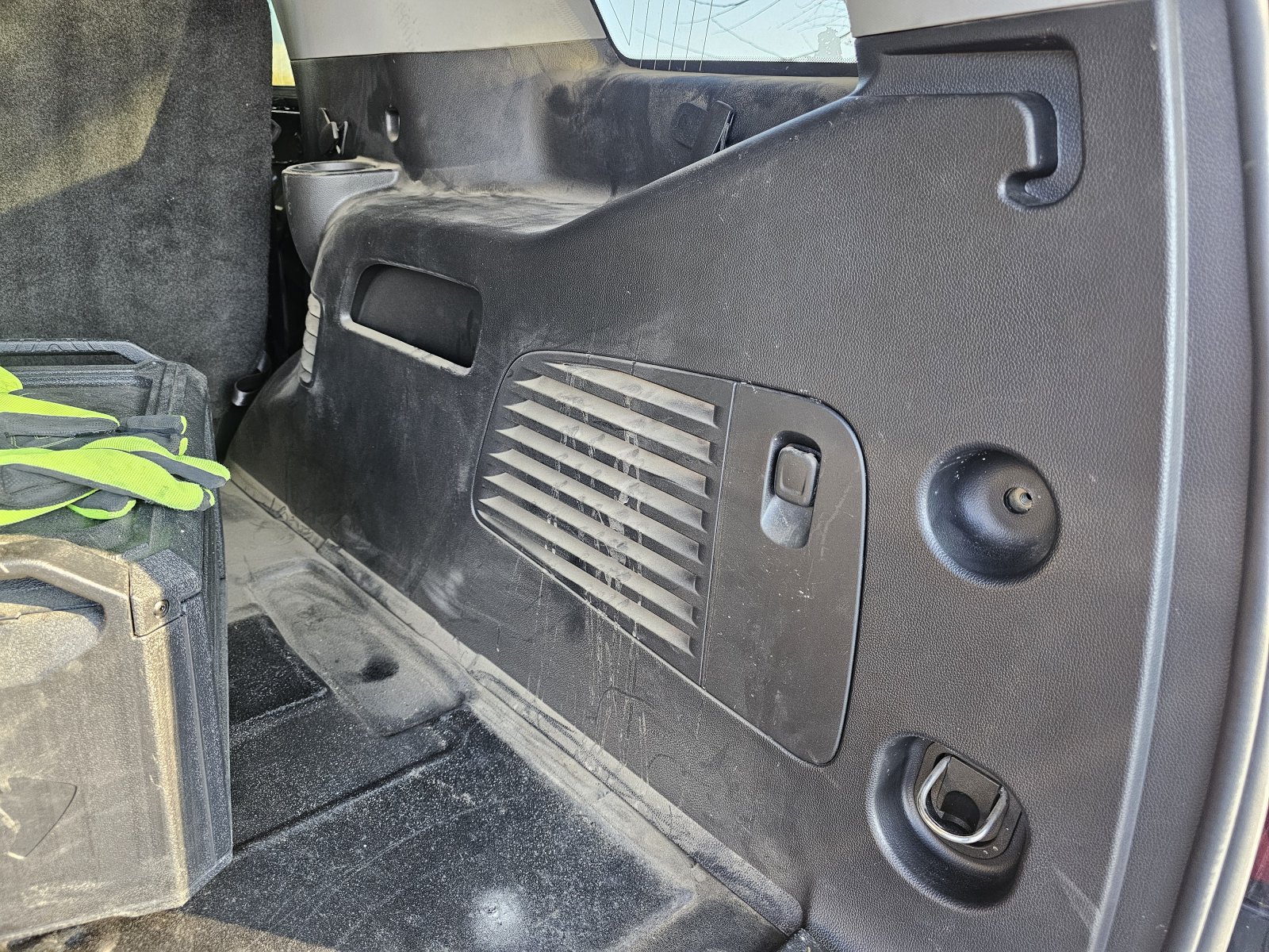

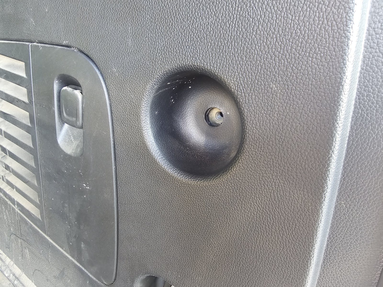

And lastly there are two empty bolt holes in the cargo area. What are these for?

The hole in the last photo is where someone has removed the bracket that is screwed-in, where a tie down or rear elastic net can be fastened (on each side).

The small square thing on the dash looks like a GPS puck probably from the Dash Camera system, round thing appears to be some sort of foam mount or support for something?
both of them have wires coming out of them and going under the dash between the dash and the windshield. And there is maybe an inch between them and the glass, so no room to put anything on it.... it's to tight to get a pic from the inside, and from the outside the reflections mess up the pics.

The wires coming from the seat belt area near where the divider used to be, could have been for a shot gun locking mechanism, that was controlled by a button on the light / siren module between the front seats. The direction arrow stick in the back window probably was hooked up to the light / siren controller as well. The antennas were probably for uhf or vhf radios, scanner, and computer ( MDT, mobile display terminal) terminal connections. The GPS puck on the dash was also hooked up to the computer as well. Good luck with your new truck. I bought a 2015 PPV as well, and I simply LOVE IT !!! ❤️⭐
