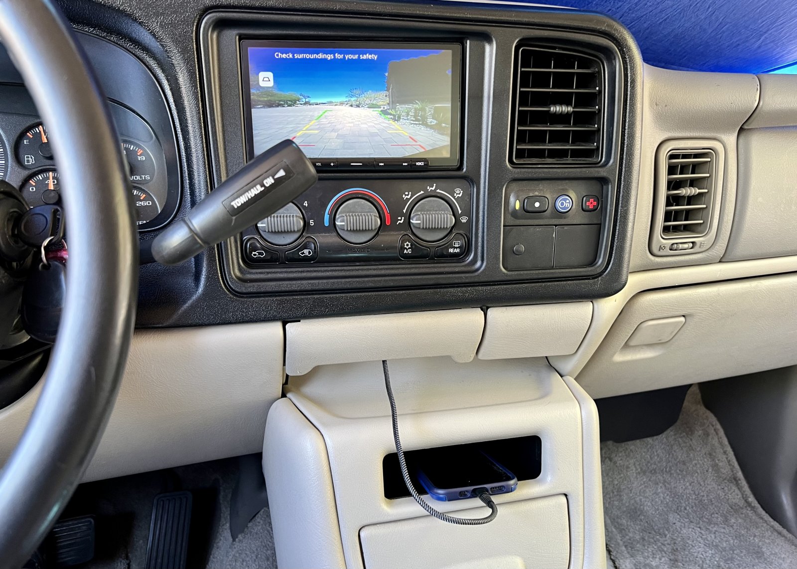

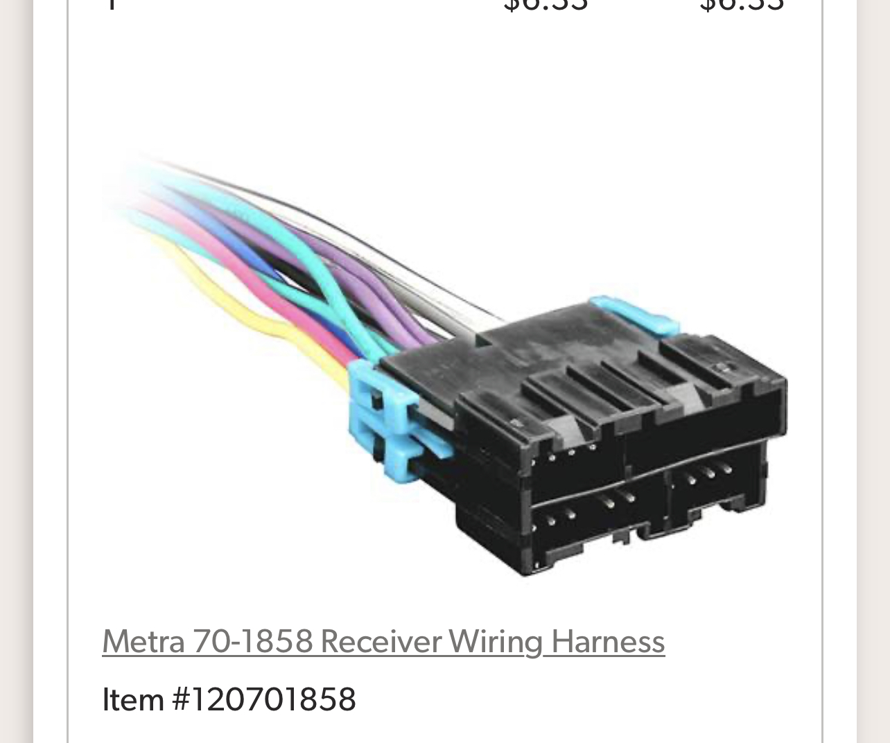

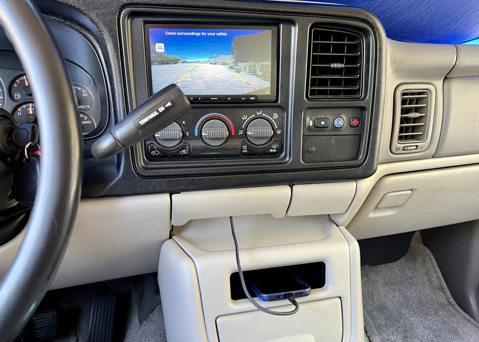

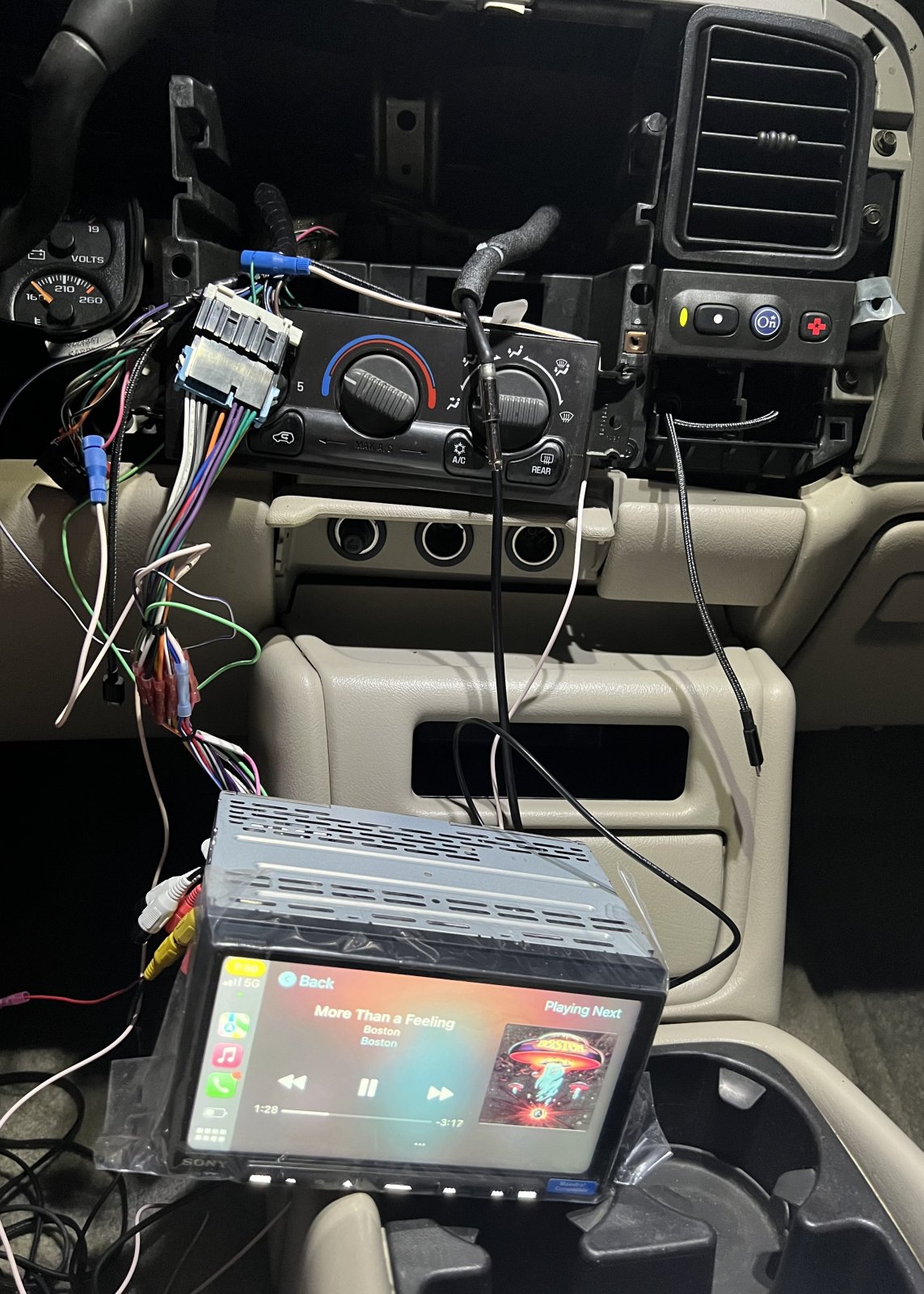

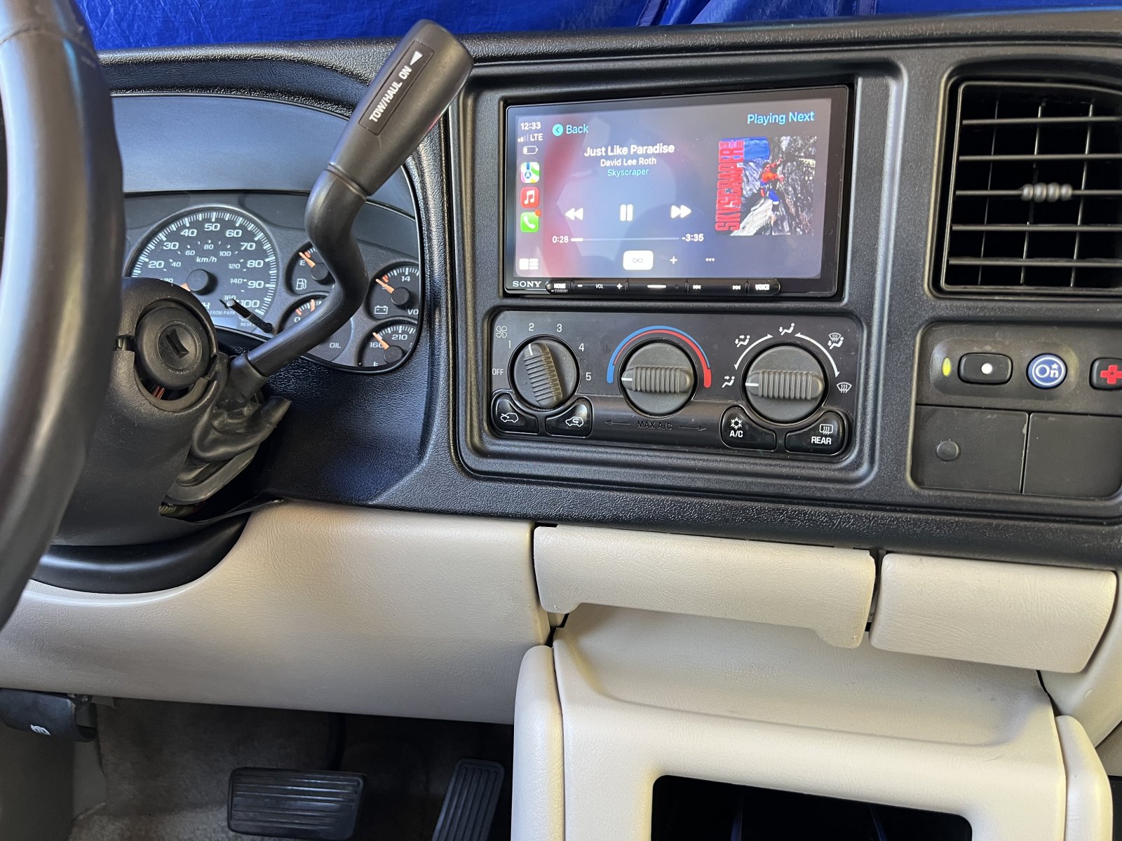

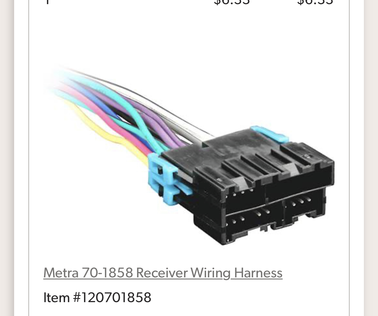

I used this one from Metra, part number 70-1858, for my recent Sony Double-DIN install on a 2001 GMC Yukon. I ordered from Crutchfield and also paid extra for the “ReadyHarness” service that pre-joins all the wires. The install was smooth and straightforward, great result.
