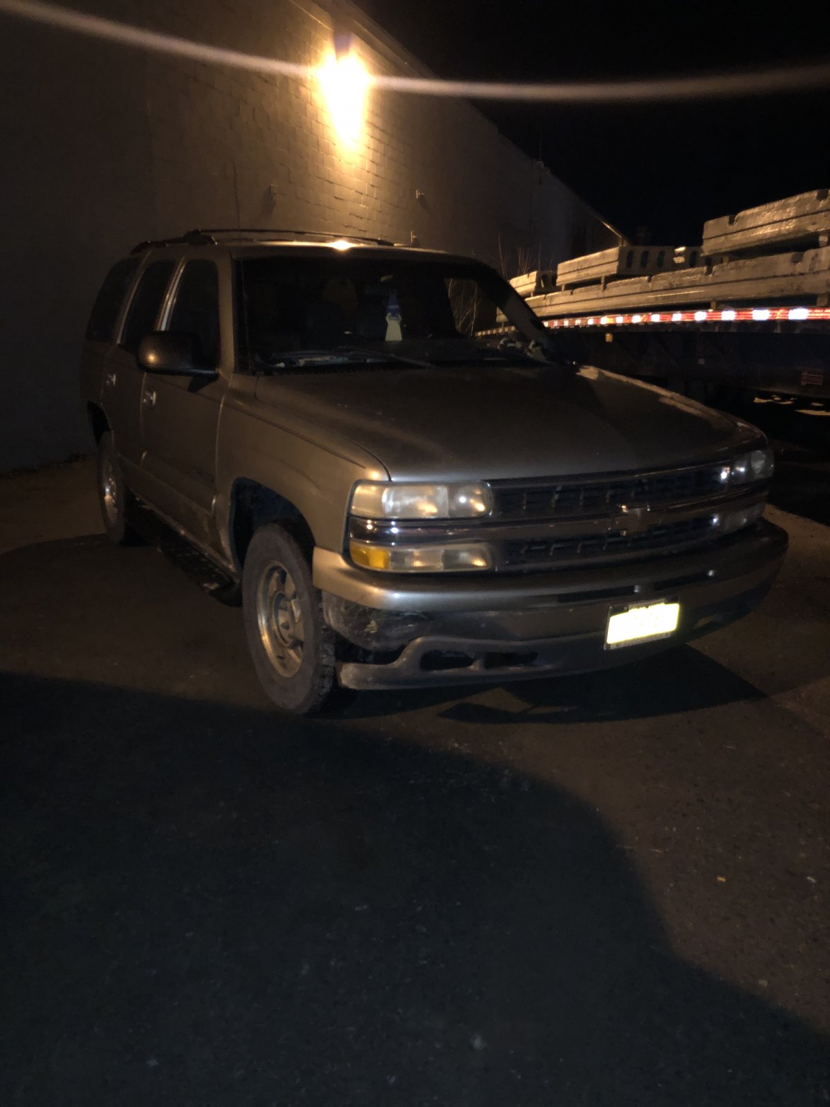

I own an 02 Tahoe 2wd. I was driving to work and less than 100yrds there I lose power at the accelerator I’m barely chugging along and my truck sounds like a combination of backfiring and popcorn popping when I press the accelerator.
I made it to work parked and on idle reving the engine it pops and rpm’s dip low. I shut Vera off and now she won’t turn over and it sounds like popcorn time at the movie’s.
All thoughts would be greatly appreciated. I love my girl I just don’t know how much yet $$$$.
