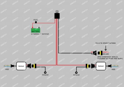

You guys are somehow not getting enough amps to fire the ballasts. Here are your only solutions.
Use a regular hid relay harness or make your own.
Wire a capicitor to one end of the relay trigger to stabilize the pulsing voltage then comet the outputs to each ballasts.
Or use a capicitor and really for both sides. This is easier done with wire and terminals than a harness. This will ensure you get full startup voltage and stabilize the current.

Yes. Just a simple relay harness. Look in ebay for hid relay harness. You will see one there.

Getting a jatronix relay and using a basic relay harness will solve startup cut out. This cost like 45 bucks but Will allow you to keep the auto headlights. uploadfromtaptalk1432609948662.jpg
