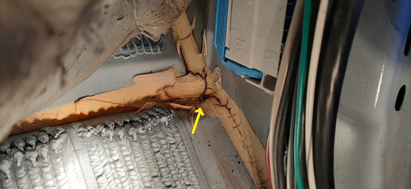

I am troubleshooting rain water leak in passenger side for a while. I narrowed down to specific internal and external water intrusion spot.

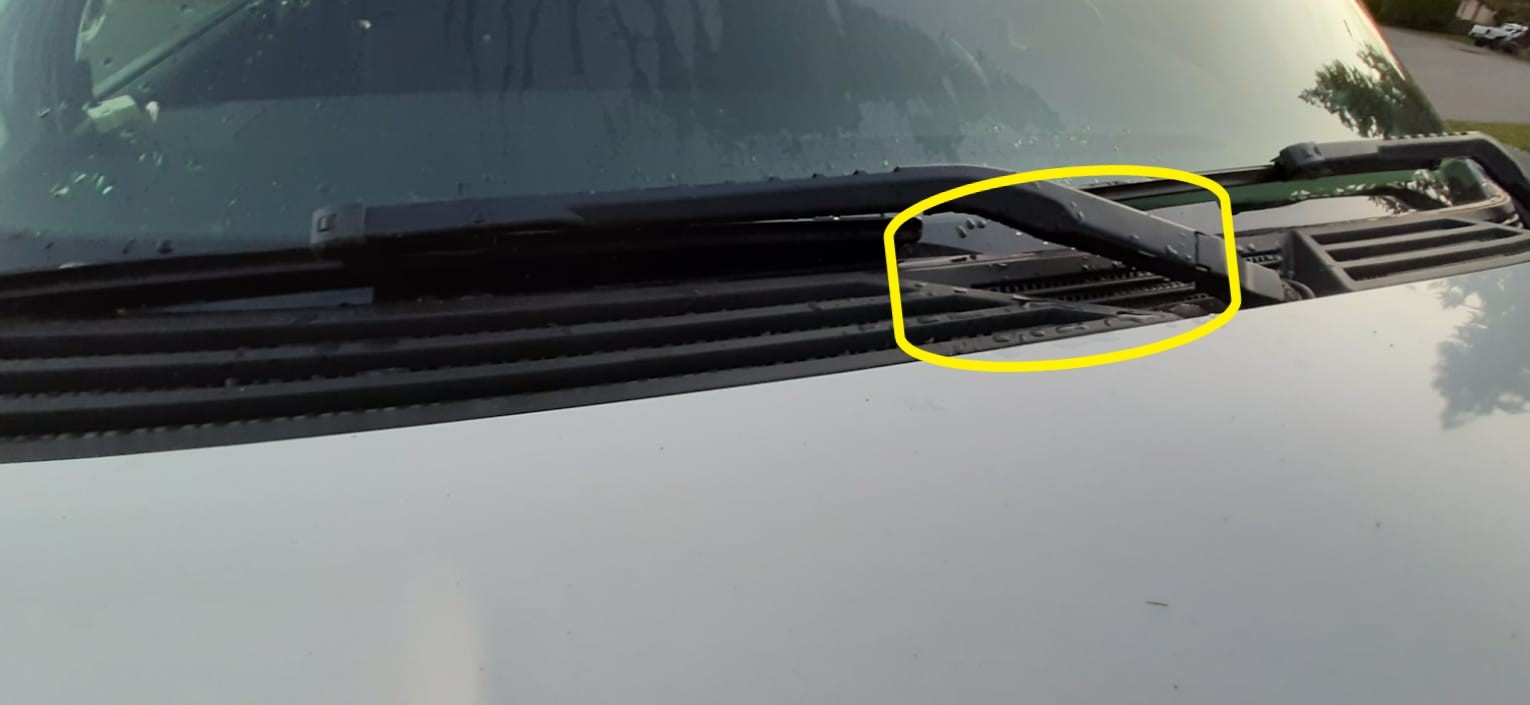

When I pour water in exact spot between two wipers into the cowl, the water seeps out of the exact spot shown in first picture 'water intrusion.jpg' i.e. passenger kick area corner, can someone guide me with what is behind the water seeping spot, which area I need to further investigate. how the water poured into cowl emerges from the intrusion spot?
btw, I already removed the cowl and re-sealed the HVAC intake service access panel. the water is not leaking through fresh air intake.

I would take the wiper cowl off and have a closer look from the outside could just be a open seam that needs some sealant.
I already opened and inspected visually the seam. But you are right, it might have invisible leaks as I found the seam sealant fragile. should I take away the existing seam sealant and reseal. what sealant I should use?
right now the suspect is 1 of 2
- bad seam sealant in wiper cowl (i am planning to lake some water by blocking cowl ends to test this)
- water flowing out of wiper cowl entering behind fender area
thanks
