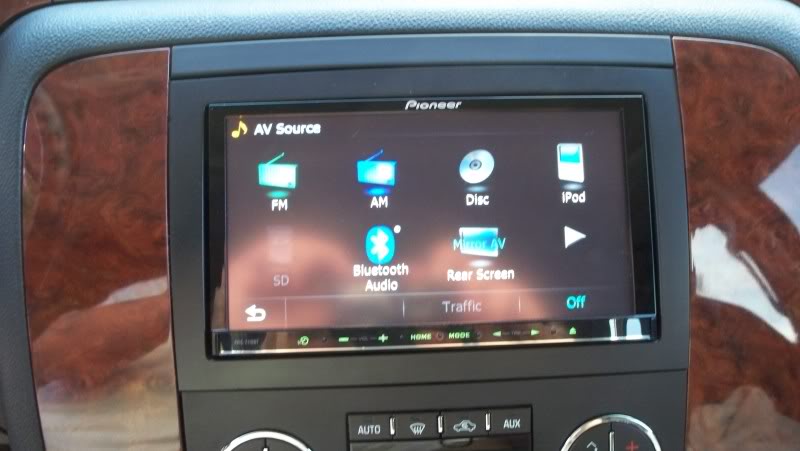

Does anyone have this unit installed. Got into a chat with a Crutchfield.com guy and he said .3" too deep?
Anyone confirm this?

Thats not true. I have a buddie that installs these all day and it does not require any cutting of the dash in the NNBS models, just unique tucking of wires will make it install like normal.
The NBS is a different story.
Crutchfield only says the Z120BT and X920BT don't fit because they add .6" of depth onto their fitment guide specs for all aftermaket stereos because of wiring, and to reduce the amount of returns due to a customer saying "you said it would fit, and it didn't."

I installed the P3100DVD and while it technically fit, it was damn near impossible to get it to sit flush in the dash with RCA plugs plugged into the back. I ended up just hacking the back out of the dash. It doesn't need to be there anyway, makes life easier to just cut it out.
I used a mini-hacksaw and it worked perfect.

i do them too and havent had one fit in
Will you clarify this statement? Thanks -Seel
---------- Post added at 08:46 PM ---------- Previous post was at 08:45 PM ----------
So it looks like I'm going to have to cut a bunch from the BACK of the dash to make this thing fit? I'm eventually going to add a lot of audio to this biotch so I want to make sure it's all going to fit.

the part u have to cut will not hurt anything. if u ever put the stock radio in it will still fit like new.
ive put in 10 or so nbs and nnbs to make every thing fit nice and make the dash kit sit right, ive had the cut out the back of the dash behinde the radio.

How much cutting behind the dash and what do you use to cut it? Are we talking an extra 10 minutes of trimming or taking more dash apart to get to it? Thanks for the replies -Seel

oo not much right behide were the radio goes u have to cut that. if u have a air saw or a hand hacksaw blade. or u can hack it and break it out lol. if it take 10 mins thats alot

My buddy is an installer. I had him install the z110bt which is the same as the z120bt in my NNBS Yukon. He didnt have to cut behind the HU. It sits in flush and yes this the best HU ever. I has so many different features (hack mods) that I still havent been able to figure them out. avic411.com is a great info source. Make sure you do the bypass before putting it in. Also if in the near future you are going to put additional screens you should buy the RCA wires and run them, that way you dont have to take it all back out. Good luck on your install.

I had to cut the black plastic in the back to fit mine...Lots of wires with the PAC On* module and steering wheel controller.
