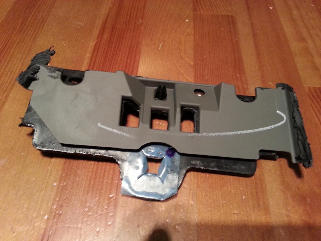

I just installed a pioneer avic-x950bh cruthcfield said it wouldn't fit ,I got it to fit by cutting behind the radio. Just want to let u know it was a pain in the ass even with cutting it wasn't easy.

It'll fit. I cut the same part out as above and works fine, no issues

I found the pics of what I cut to install my Pioneer units
