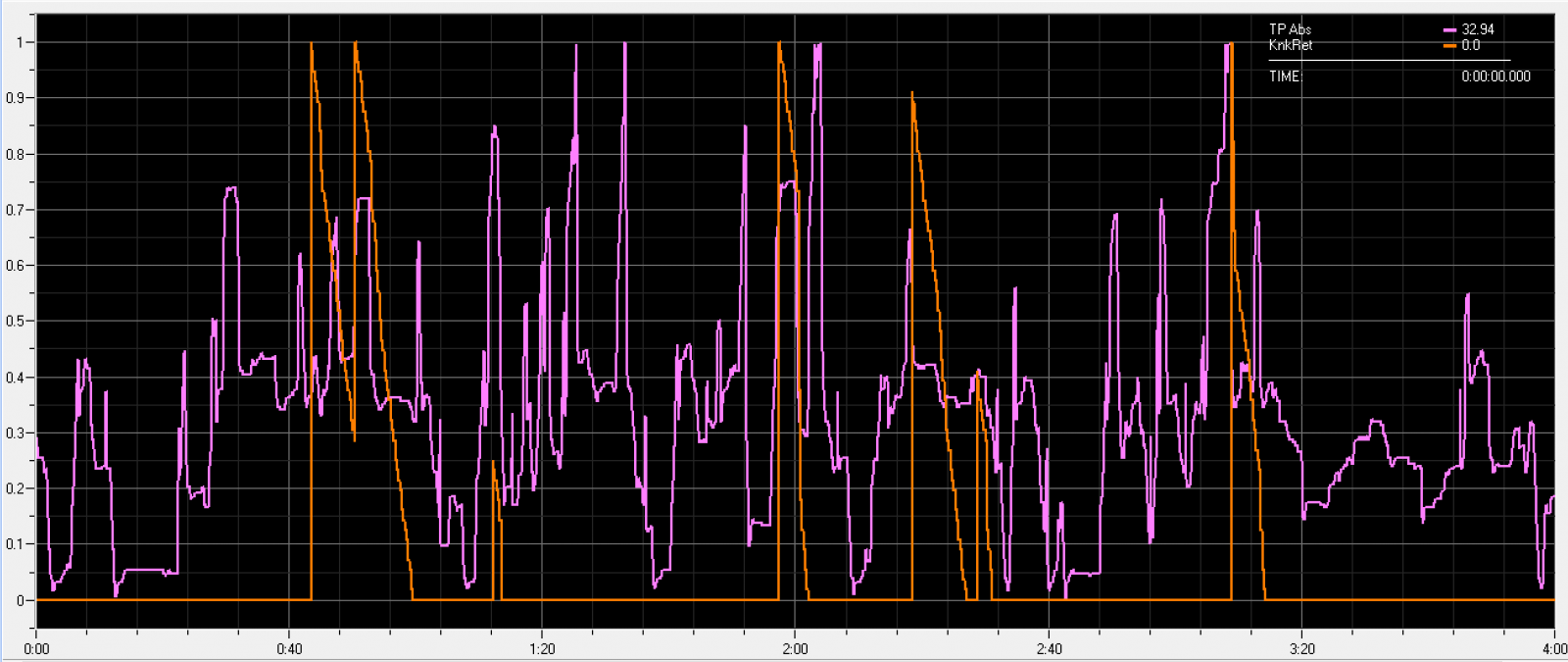

Here is the Log file with knock events
21,324
30,320

I have found logs from September 2021. I have them both as CSV as well as this zoomed out screen. I will collect new logs in the next 5 days but here is the data.
I am seeing KR events but not clear for me how to interpret them, from limited reading, KR events happen all the time or is not the truth?
Actual data is in this CSV file located here: Logs in CSV
21,324
30,320

@randeez Hey Randy, would this include torque management or actual knock detected by the sensors?
should just be knock detected by the sensors.

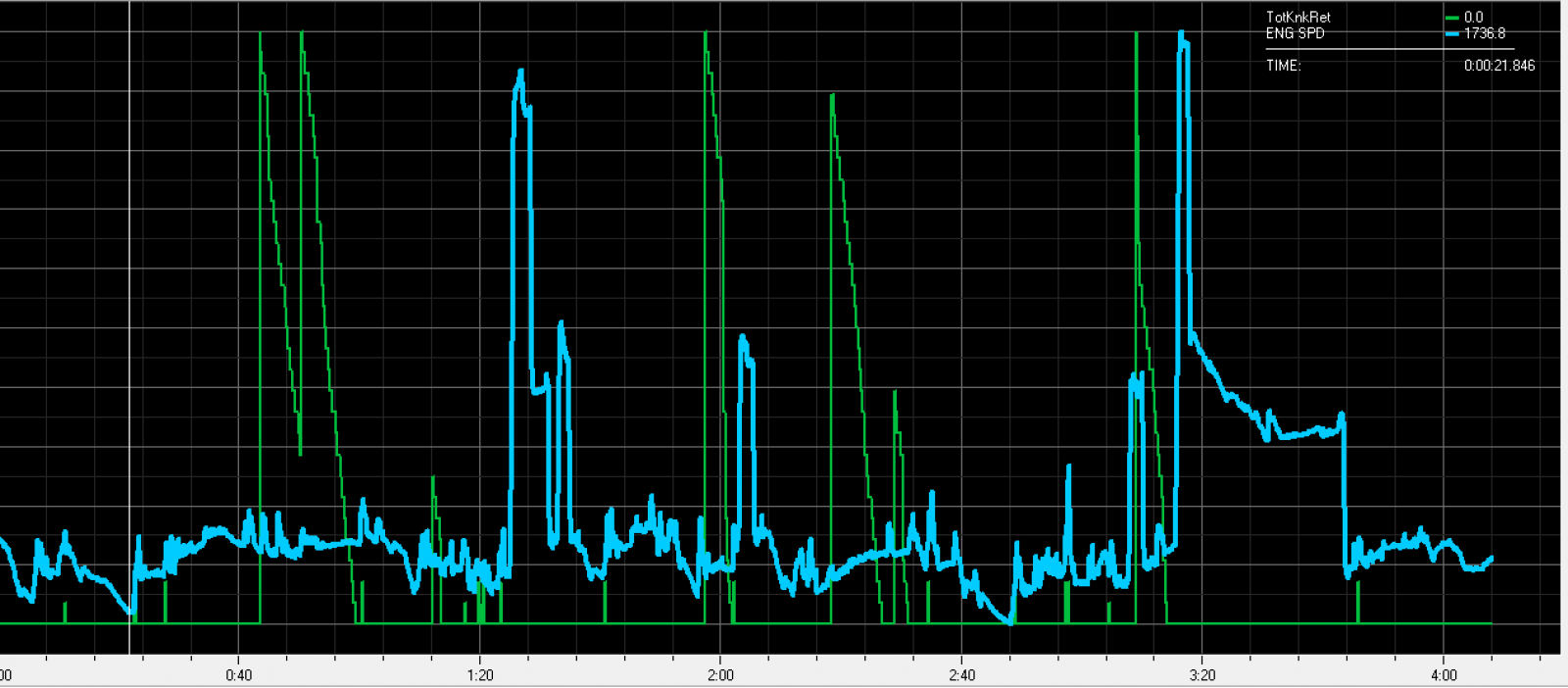

not sure what you using to log, but i would log the total timingand knock retard as well, pretty common though from what ive seen. shows a lot of knock but doesnt really pull much timing, maybe a degree
DI crap is still pretty foreign to me, l83 is like 11:1 compression, half the time the knock is caused by too much fuel as they seem to like 12.5-13.0+ WOT
but if it goes away on 93.. i guess there's your answer
30,773
48,479

@randeez here is the total knock degrees and advance plot for the same log. I spent hours reading about KR plots but still cannot determine. To me looks like I have pinging but not sure.
