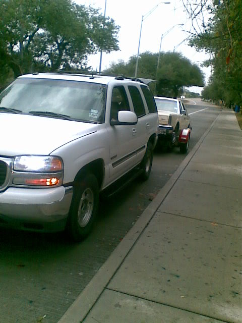

Well I just ended up wiring it into the reverse lights and now everything works out fine! Just towed my first car with it, 1982 Lincoln Mark VI. From Harlingen, TX to Houston, TX
Just went thru a bad rainstorm...
