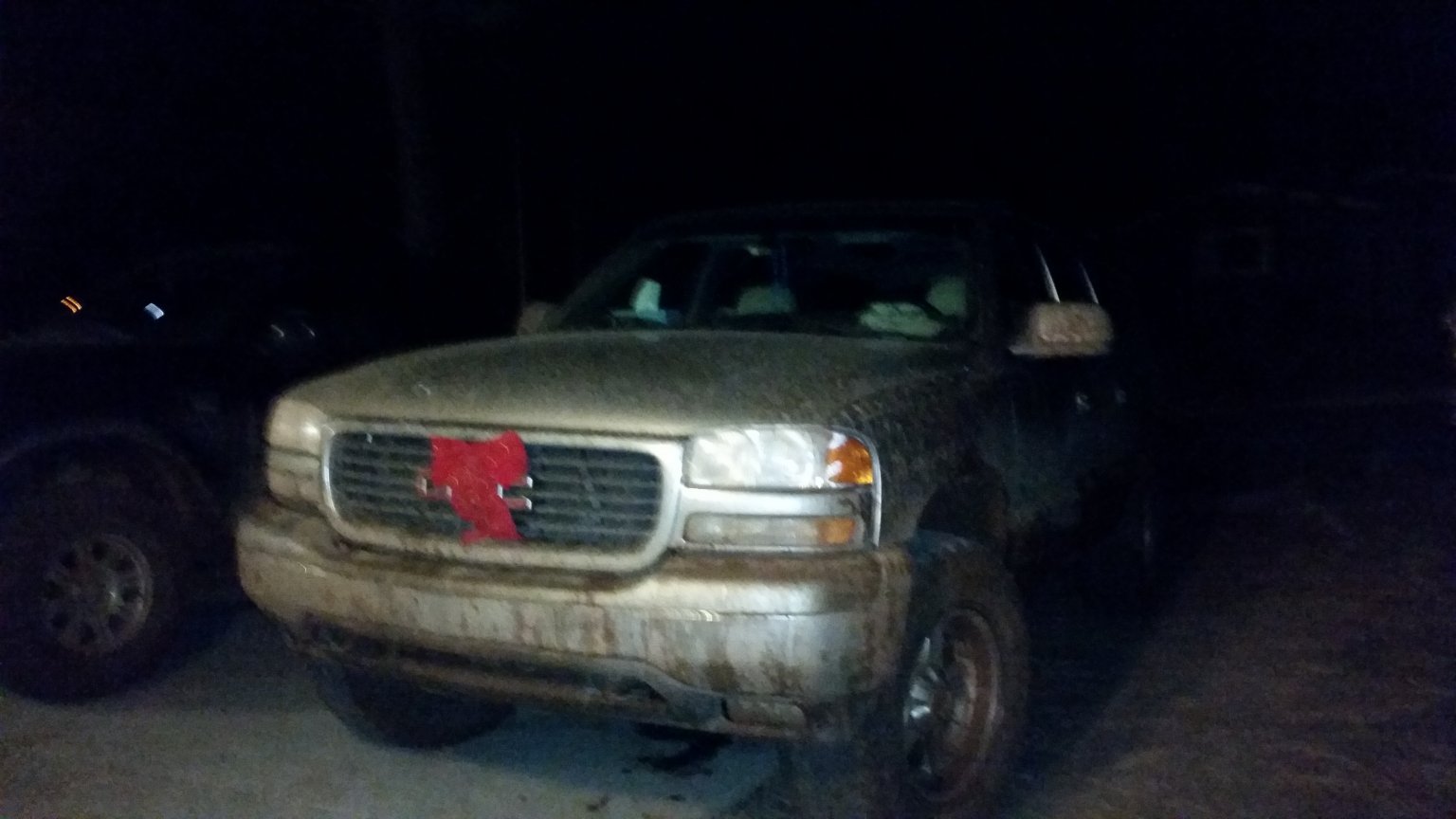

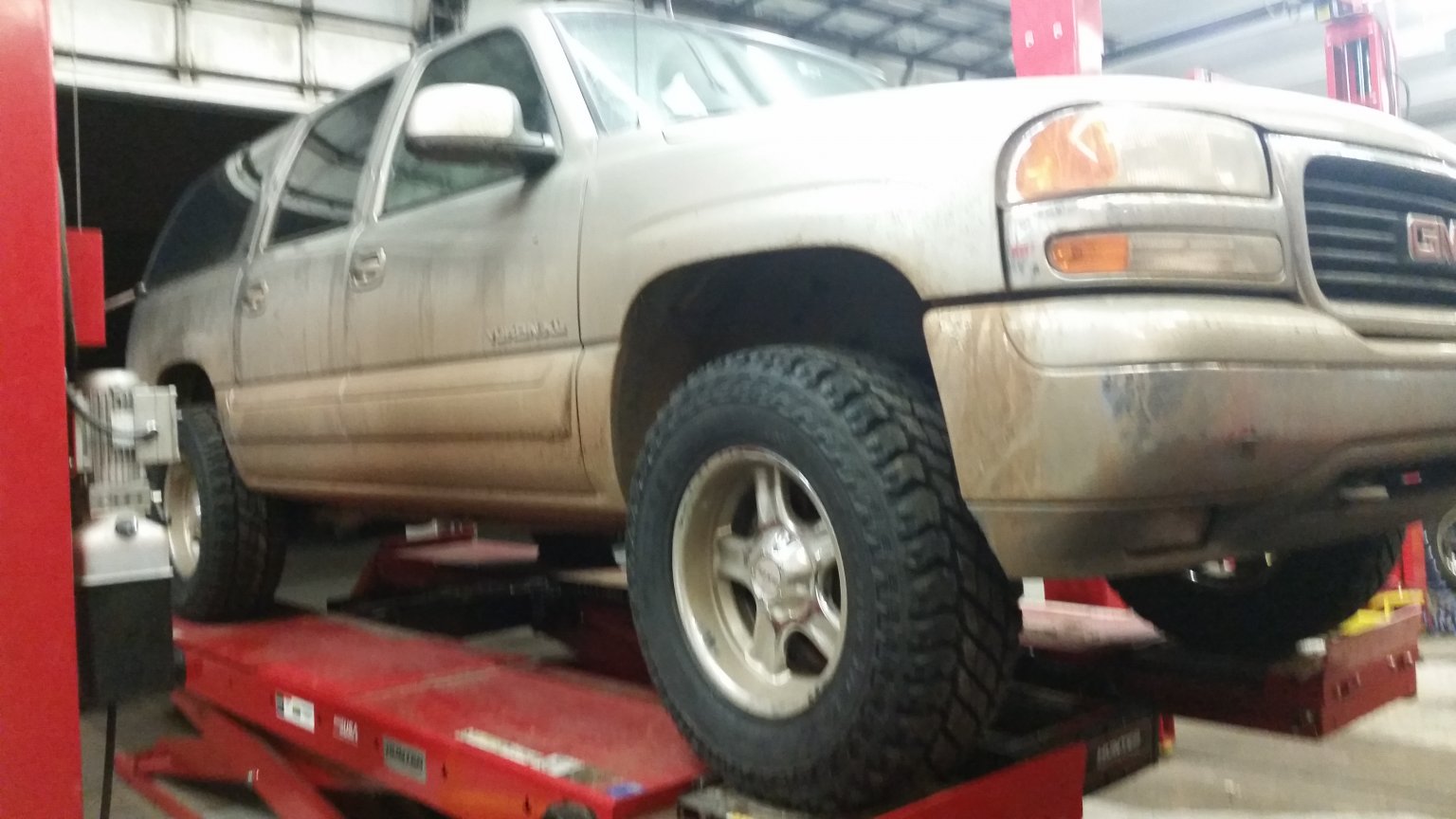

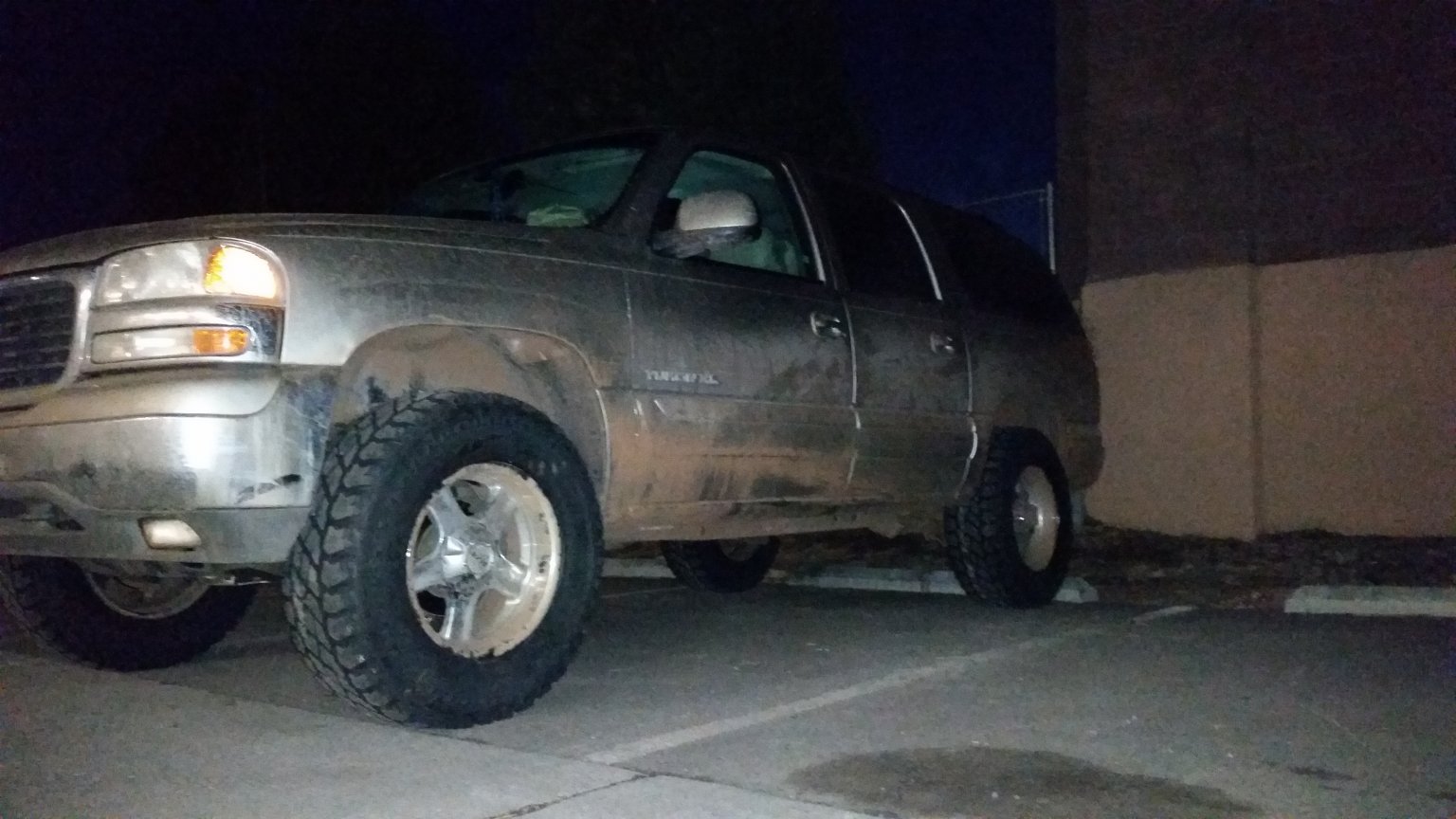

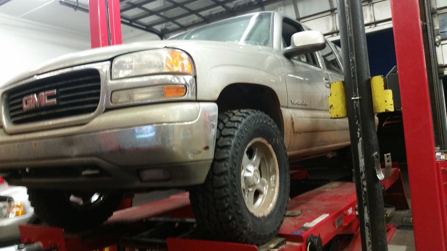

2 inch budget lift, rough country socks, 295/70R18 (34x11.50R18) cooper st maxx

Looks really good. Can you try to get some daytime pics? Are those stock wheels?
Also you said "budget lift?" Assuming that means torsion bar keys and spacers, yes?

No not stock wheels but were on when i bought it, I'm guessing -2 mm offset, yes keys and coil pucks, the pucks are 2" and the keys are all the way down, i could bring the front up maybe 2 more inches, I'd go with 3" Pucks next time

So you used 2" spacers and the keys are all the way down? ? I just put in the rough country kit with their tiny .5 inch spacer and keys are all the way down now riding level so if I put 3 inch spacers id have to have my keys a little over half way. Now I love the smooth ride with keys down especially in the sand. Won't have the keys up and big spacers. Put me back at a stiffer rougher ride.
