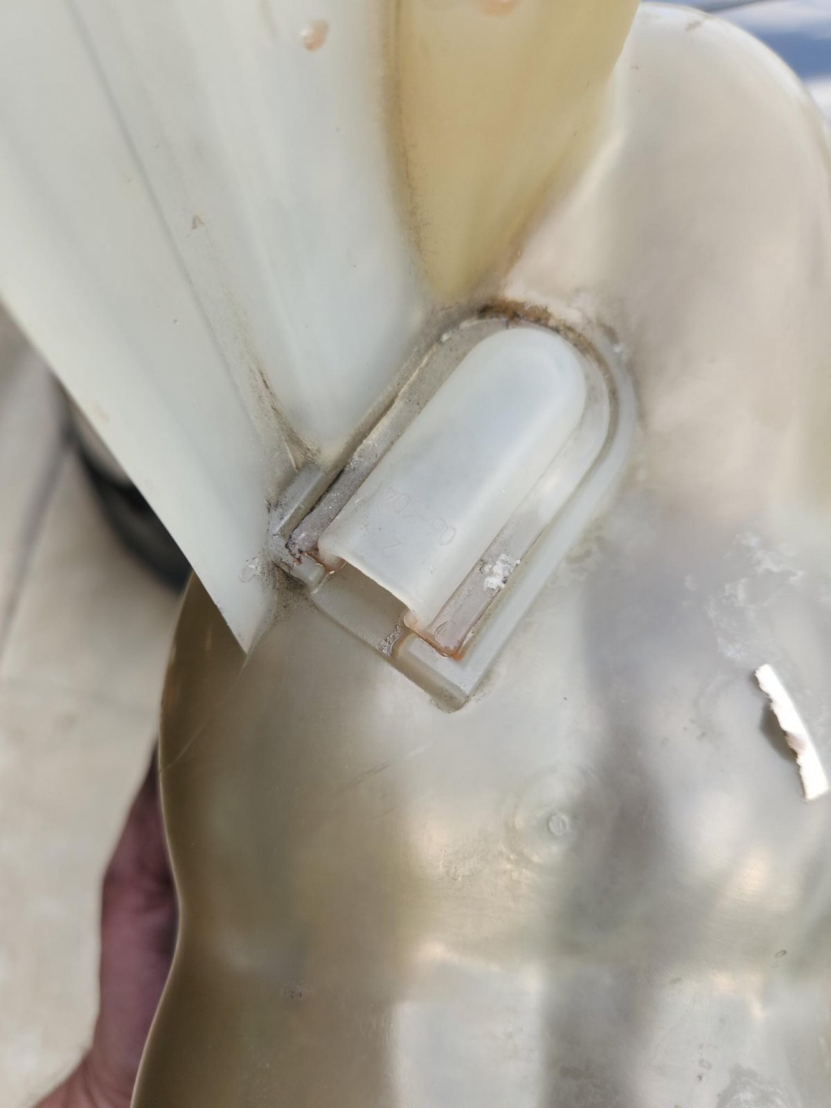

Hey Folks,
I spent a few weeks looking for a coolant leak in my 2014 Tahoe PPV. Turns out, it was the reservoir. You would think the system being pressurized at 20 PSi, it be easy to find. Oil was clean and no white smoke from exhaust. Had a mechanic tell me it could be a gasket or cracked head. To save you a headache, just putting it out there in the event anyone is experiencing the same issue. Under the reservoir, there is a 3 sided block piece that sits close to the support arm. I found it by a youtube search. Hope this helps...

I spent a few weeks looking for a coolant leak in my 2014 Tahoe PPV. Turns out, it was the reservoir. You would think the system being pressurized at 20 PSi, it be easy to find. Oil was clean and no white smoke from exhaust. Had a mechanic tell me it could be a gasket or cracked head. To save you a headache, just putting it out there in the event anyone is experiencing the same issue. Under the reservoir, there is a 3 sided block piece that sits close to the support arm. I found it by a youtube search. Hope this helps... View attachment 411659
That's the overflow drain. It should only leak coolant out when the reservoir is either over-pressurized or overfilled. Aaaaand, it will also leak fluid if I'm sloppy when I add coolant because it drains from above the cap seal, but below the threads, so pouring coolant directly on the little hole there will cause fluid to come out through that port. So assuming you're not as careless as I am when you spill fluids :naughty:, I suspect that you either have a hidden crack in the reservoir or the coolant cap on top is leaking under pressure for an undetermined cause.
Yes, but if you notice the discoloration around it, it's weak in that area. Since I replaced the tank, no more leaking.
I'm pretty careful with filling it. This wouldn't show any coolant anywhere. Until I seen coolant on the ground under the right front bumper. I felt under the tank and there it was, seeping out. All seems good now since I replaced the tank.
