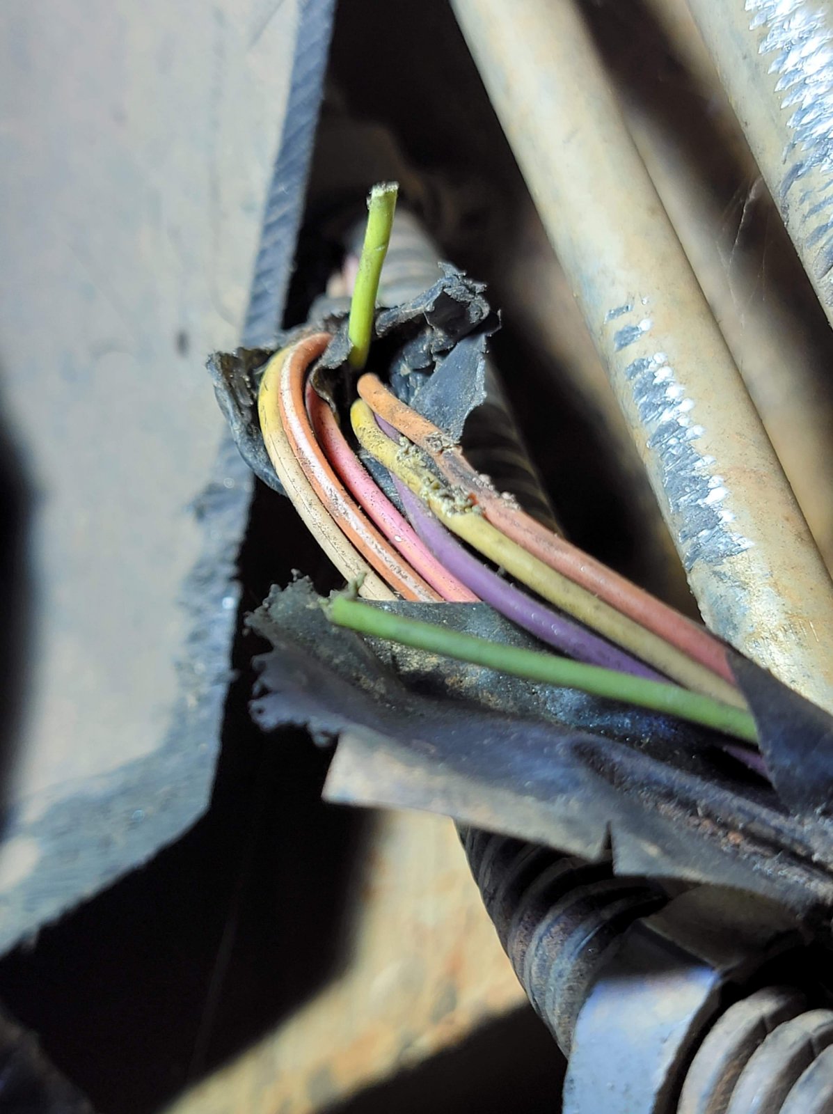

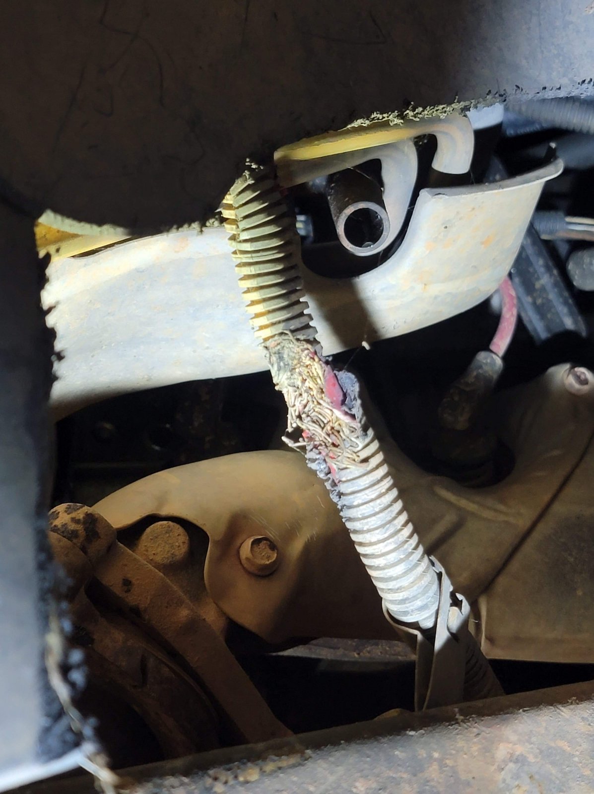

Turns out it wasn't tune related. The main power wire and o2 sensor wire were cut when the guys stole my cats which I was told it was reading lean and dumping fuel due to those cut wires. It is doing better on fuel I will say but now I can tell it needs a fresh set of plugs and plug wires so diving into that next.

Thieves suck, sorry you had to go through that.
Yikes, how could they have missed that?
