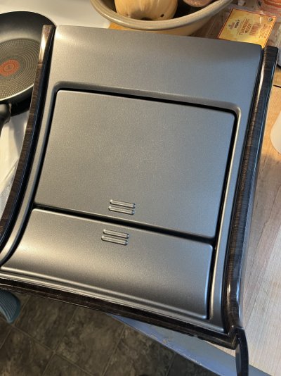

I stripped and painted the dreaded peeling interior pieces on my 06 Yukon Denali today. Stripped with denatured alcohol, adhesion promoter and painted with Dupli color BGM0344 Gunmetal metallic.

I did the same to my 03 about a year ago and it’s held up pretty well, also did the dash bezel to match, taping around the Denali wood grain pattern section was a bit of a paint to get right but well worth the effort.

I agree huge pain to tape it up!
