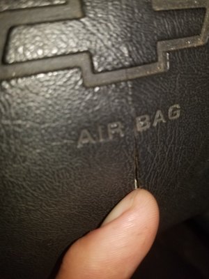

I unplugged the seat left the air bag plugged in it still says service air bag but it's not draining the battery just the big black plug when plugged in drains it but the seat works as it should, with the service air bag can a damaged horn button cause that to come on? I noticed today right below the bowtie on the horn button it is cracked when I can see inside to the air bag?
I'm going to take the side off the seat and unplug the control and leave the big plug hooked up and see if it still drains the battery

your air bag cover is cracked, that can cause the horn to not work.
you have working radio and info buttons on the steering wheel? if you still have the stock radio the clock spring can cause both the dead controls and the air bag light.
both sides of the air bag you'll see a small hole, push a nail in both sides and the air bag unlocks, you can then unplug it and the horn wires. to replace the air bag.
the clock spring is under the wheel so that has to come off.

Be sure to disconnect the battery and let the truck sit for 10 or 15 minutes before doing anything with the airbags. You don't want them deploying when you're working on them.
Sounds like it's time to get a code reader that reads airbag systems; that can point you to the right airbag system/circuit to work on. Otherwise you're just groping in the dark.

The horn actually does work and I will be replacing the horn cover so I will probably take the wheel off and replace the clock spring any way, hopefully I can find some diagrams showing how that thing is replaced and what it looks like
