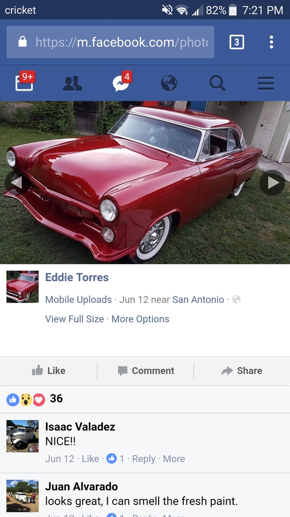

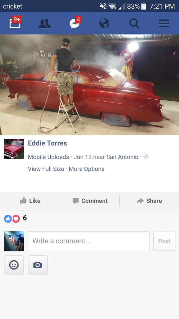

My buddy painted this in his open air carport
