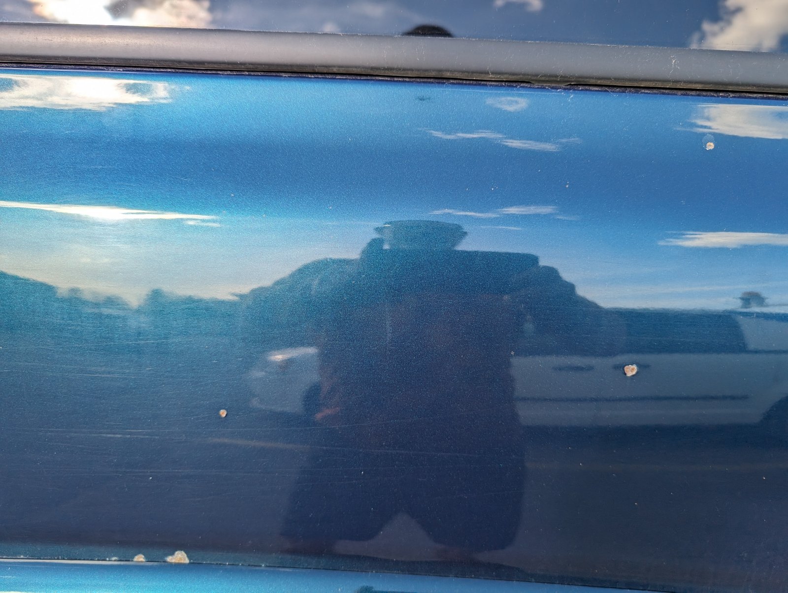

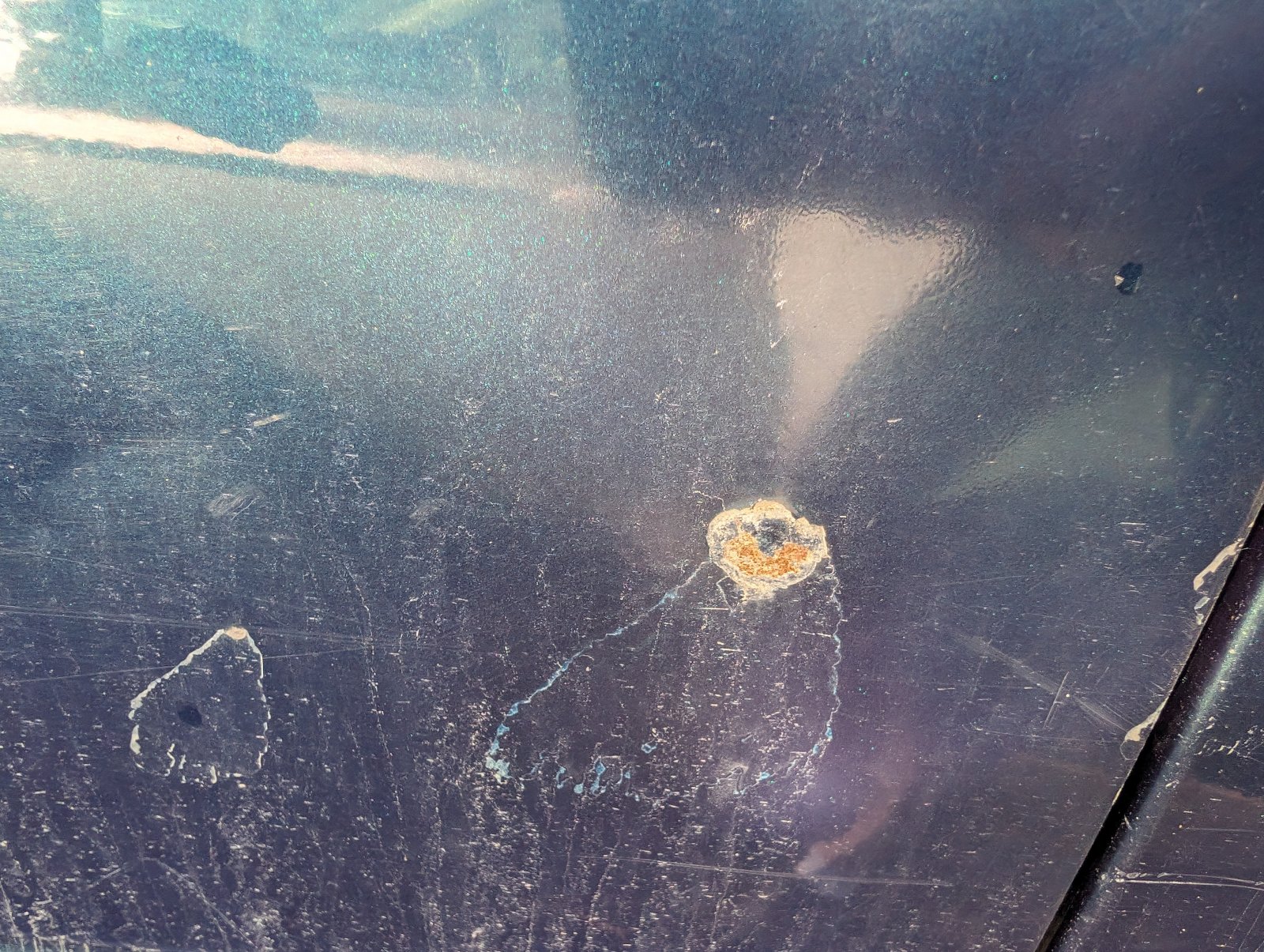

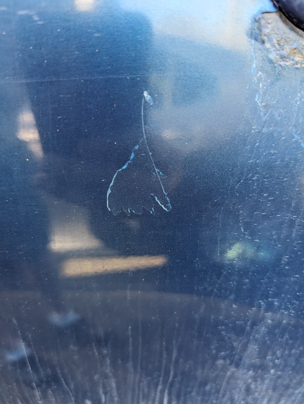

I have a 2005 Suburban LT 4x4 finished in Bermuda blue metallic.
It has some damaged clear, large stone chips.... I'm looking for suggestions on repairing the spots so
1. They don't get worse
2. They don't look worse
3. And from 20ft they look better.
Any suggestions or ideas?

Have a paint shop do a hard blend and repaint those panels and buff the entire suv. A hard blend will get the paint as close as possible to the existing color (paint fades over time)
