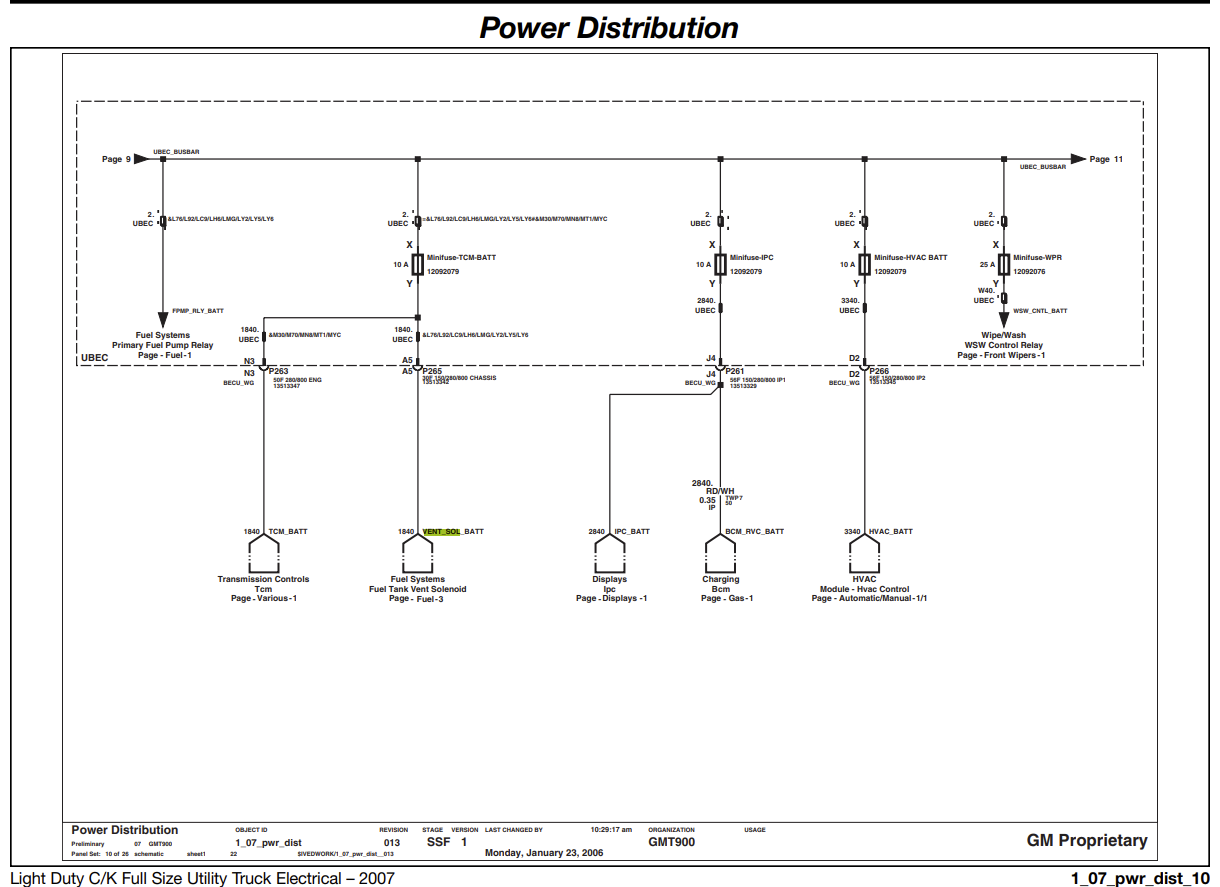

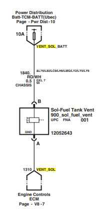

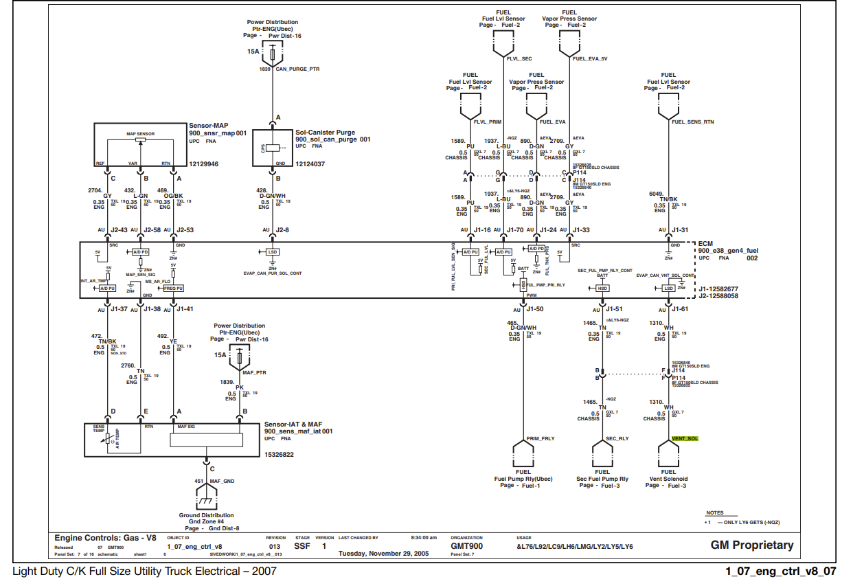

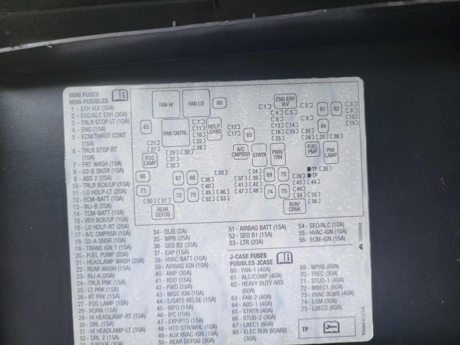

Hello gentlemen. My 2007 yukon denali is throwing out a evap code P0449. I'm told the first place to check would be the fuses. Can anyone point me to which fuse it may be on these pictures of the cover? Like what would it be called? Thank you for your help. Cheers
