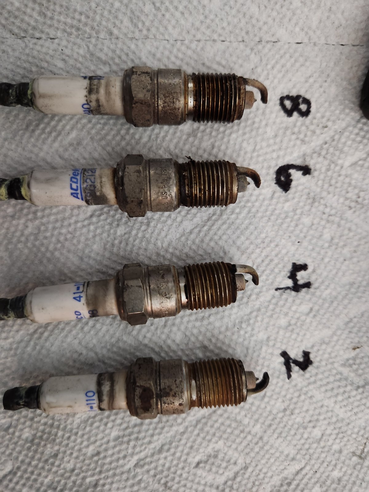

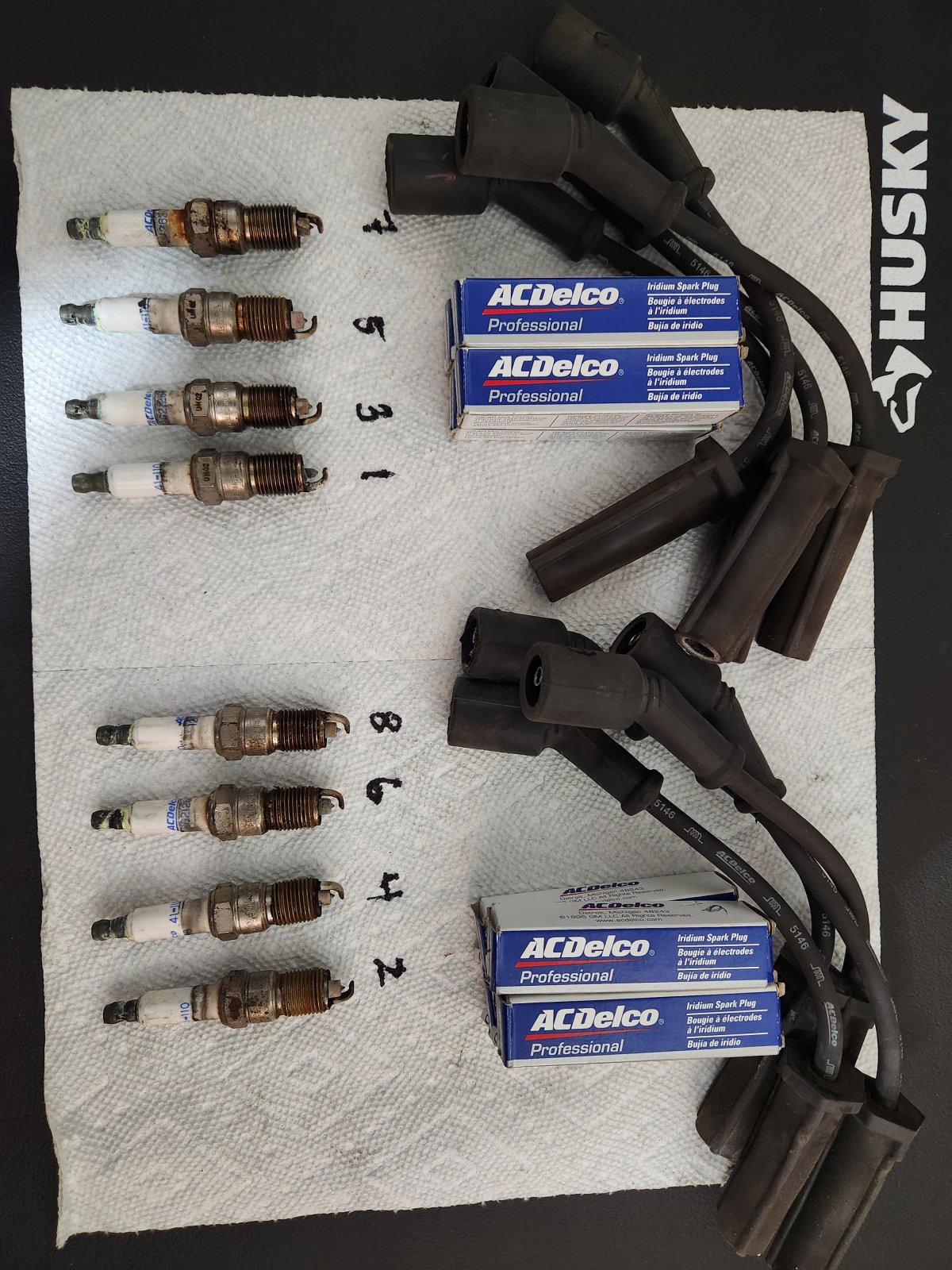

So just to report back, I changed out all 8 plugs with ACDelco 41-110 and ACDelco 748UU wires from AutoZone. As suggested, I also swapped coil #7 and #3 in case the miss returned I would know if it was the coil or if it was something else. Even though the plugs had 10 years on them, I think taking the 2nd battery tray off to get to the coil bolt I dropped thru the hole in it accidently when I was swapping coils took longer than doing the entire driver's side plug and wire change. Passenger side obviously took longer but removing the airfilter and it's entire housing helped open up the area to reach in from the front to get your arm in there while standing on a milk crate.
