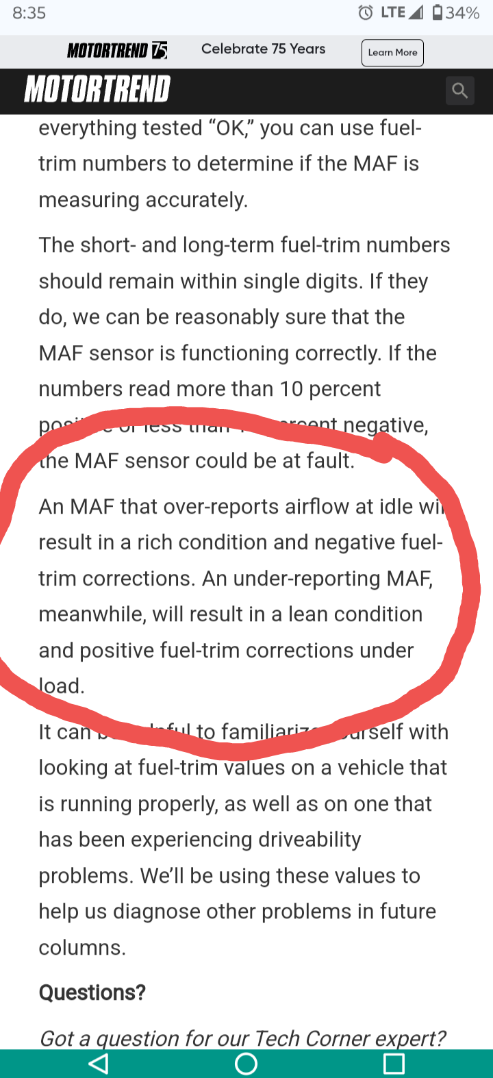

Now, I thought underreporting caused lean conditions and overreporting caused rich conditions. Is that correct? Or I got that reversed?
Seems the opposite of OP's situation?

Ok, looks like we're correct:
I believe I mentioned that an issue with the MAF would cause both banks to be lean or rich, which is not the OP's case. But definitely MAF values seem out of range and need to be investigated further...
And the rule that there could be more than one problem always seems to apply on these types of issues. I guess try to solve the problem by taking it step by step, fixing known problems first.
