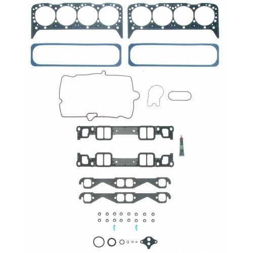

Still out there a little. So for my '96 vortec I need which one? the first one you posted or the one I posted because when I look at a replacement manifold I only see 2 square cut outs in the center of each side and the gasket has three squares Or Am i going to have to tear it down first. Kinda wanted to get everything on hand first.
The one you posted are the better option. I ran those on my Vortec headed old school small block Camaro and I run them on my Vortec headed TBI Tahoe. The three big holes you are referring too go absolutely no where ... they don't do anything.

Yup, they're all right. Our vortecs have 6 ports on each side. The three in the middle aren't there so it doesn't really matter what gaskets you use as far as that goes.

The set here I am getting has the one with two small holes but I should still be good right?
Just don't want screw it up. I need to get this SUV on the road and get back to work. Of course I won't know the extent of damage to the engine until I get it apart. My head and manifold bolts will be replaced to per the service manual. I hope for me it was a head gasket that popped.

Don't worry you'll be fine, those are exactly the same as the ones I installed. They will work just fine. That's a pretty extensive kit! Reminds me I never replaced my EGR gasket...
