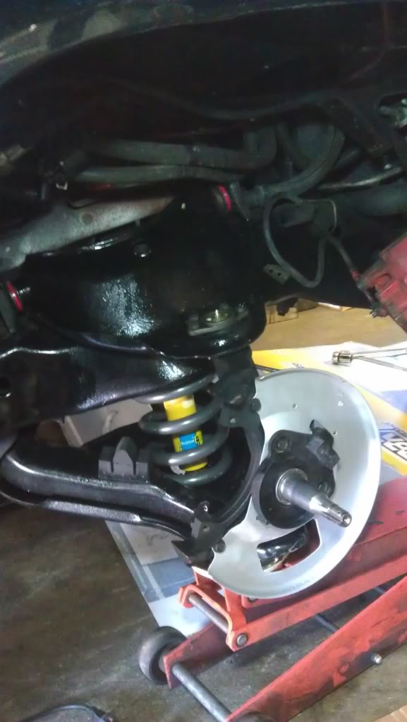

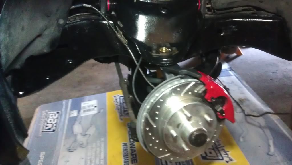

Could you please tell us why u changed this parts?
I see you used the red energy suspension bushings, how does it feel?
You used the moog problem solver, why?
You replaced the uppers and lower arms, why?
Great work
Great work
Thanks, Its All Depends On How You Drive Your Car, Im A Very Aggressive Driver, So im Always Speeding & Hitting Tight Corners! I Dont Like Any Body Lean! The Polyurethane Bushings REALLY Tightened Up the Front End! I don't Recommended Them for A Daily Driver. The Reason I Changed These Parts!? Beacuse They Were 13 Years Old!!! & I Plan To Keep This Car Till It Breaks Down! With 3000 Miles On The Clock It Wont Be For a VERY Long Time! :D

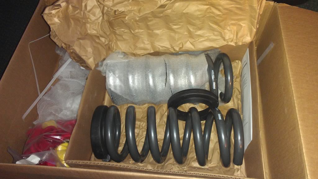

Thanks! Im Down Man! I Just Need To Fix my Hesitation Problem! I Cant Seem To Find The cause Of It! !! Then Im Ready! :D .. 2" Belltech Coils Up Front & 2" Shackles In The Rear Stock Hangers...

Damn OTSS u dont post much but wen u do its damn worth it... U and I both have the same driving styles... I like 2 get my LIMITED sideways as well... But she is my daily... Still looking in2 different bushing options... I hear those energy polyurethane bushings squeak like a mofo... Keep us posted on any squeaks or problems that may occur...
retorq
Mar 4, 2010
3,018
11
Kingman AZ
They will squeak if you don't grease them when you install them. I've had mine in for about 5 years, no squeaks.
