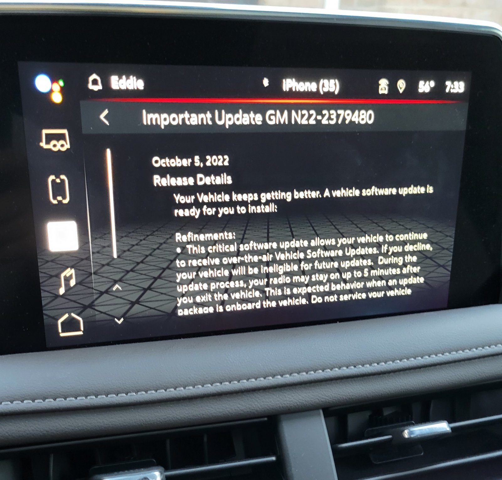

Just got a notification yesterday for an update have anybody else got it does it change anything at all?? I want to know from someone before downloading it…
972sparky
Mar 15, 2022
79
75
Looks like there is more info about the update if you scroll down. I think it has to do with being able to get future OTA software updates.

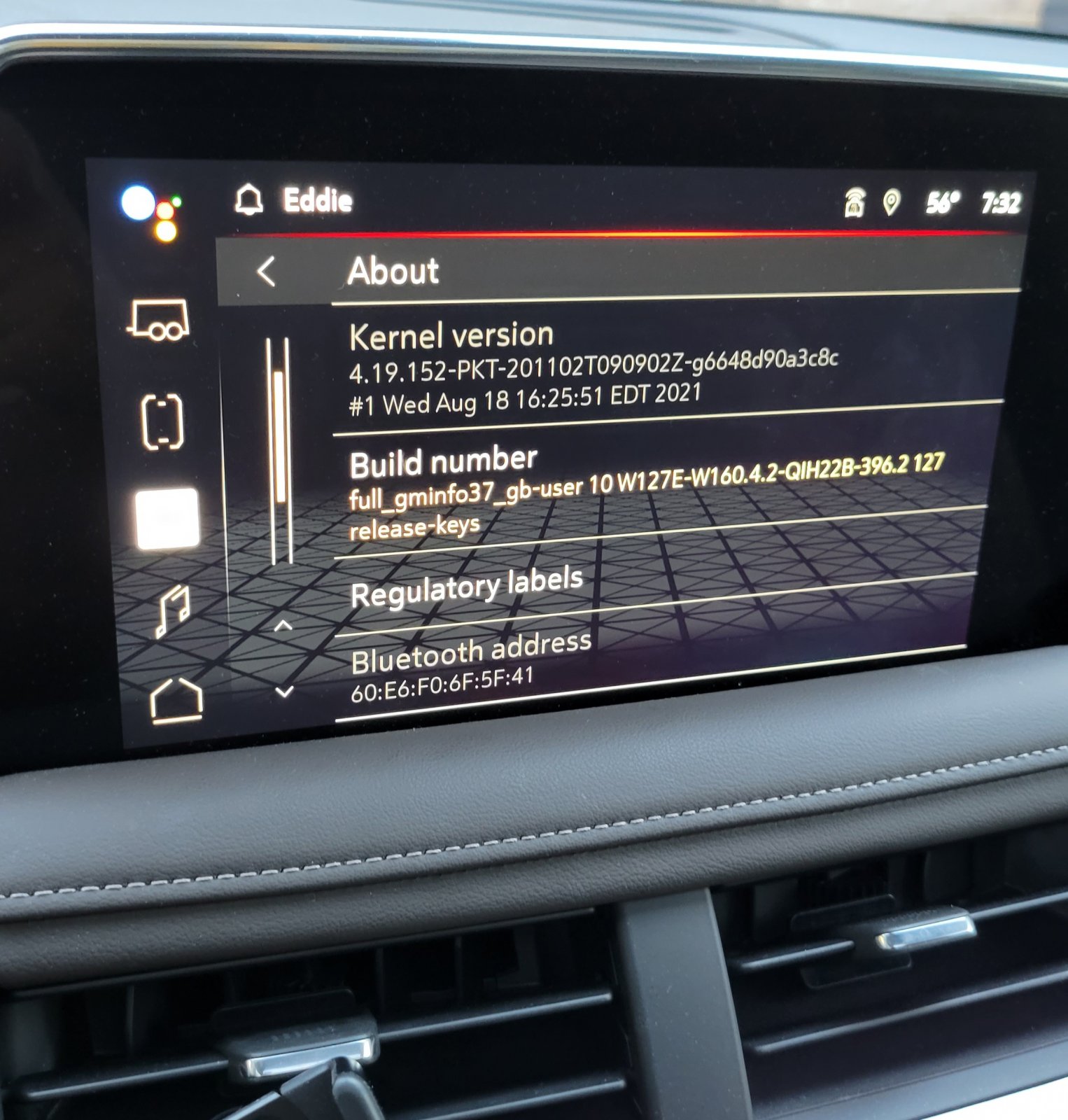

What year is yours? I’ll have to check on my 21 Tahoe.
If it’s a 21, hopefully it’s the V160 software version for the infotainment system. I’m hoping that fixes my turn signal noise disappearing while it’s flashing occasionally.

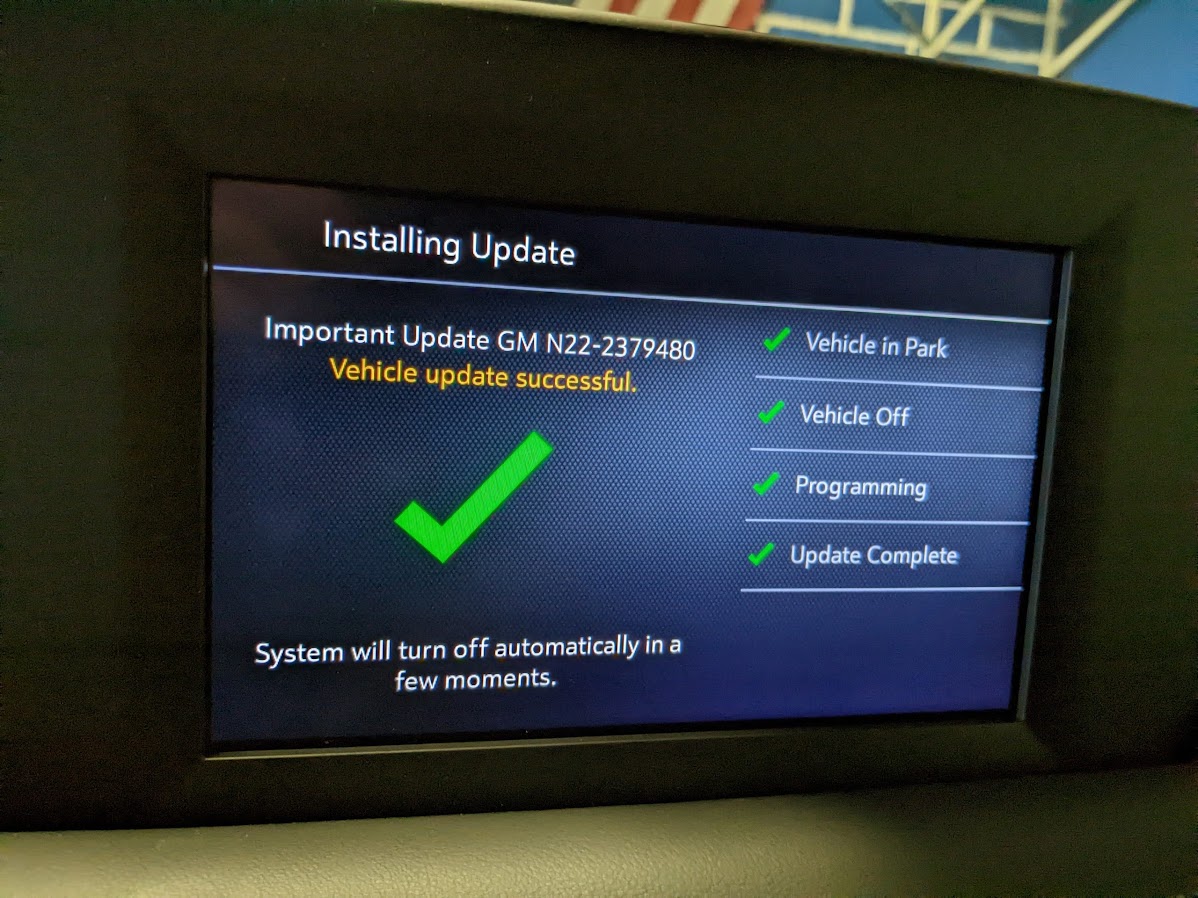

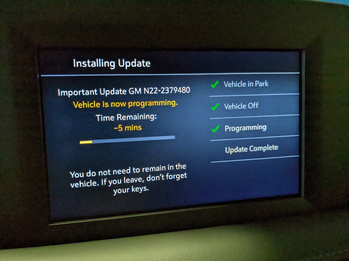

Just started the update this morning. I’ll post here what I find out.
selectsplat
Dec 22, 2021
220
235
Update completed successfully in about 5 minutes. No noticeable differences. Everything still works. Couldn’t find any release notes. And don’t see any new functionality.

Same here i did it yesterday all went smooth and no issues or difference all works good ..

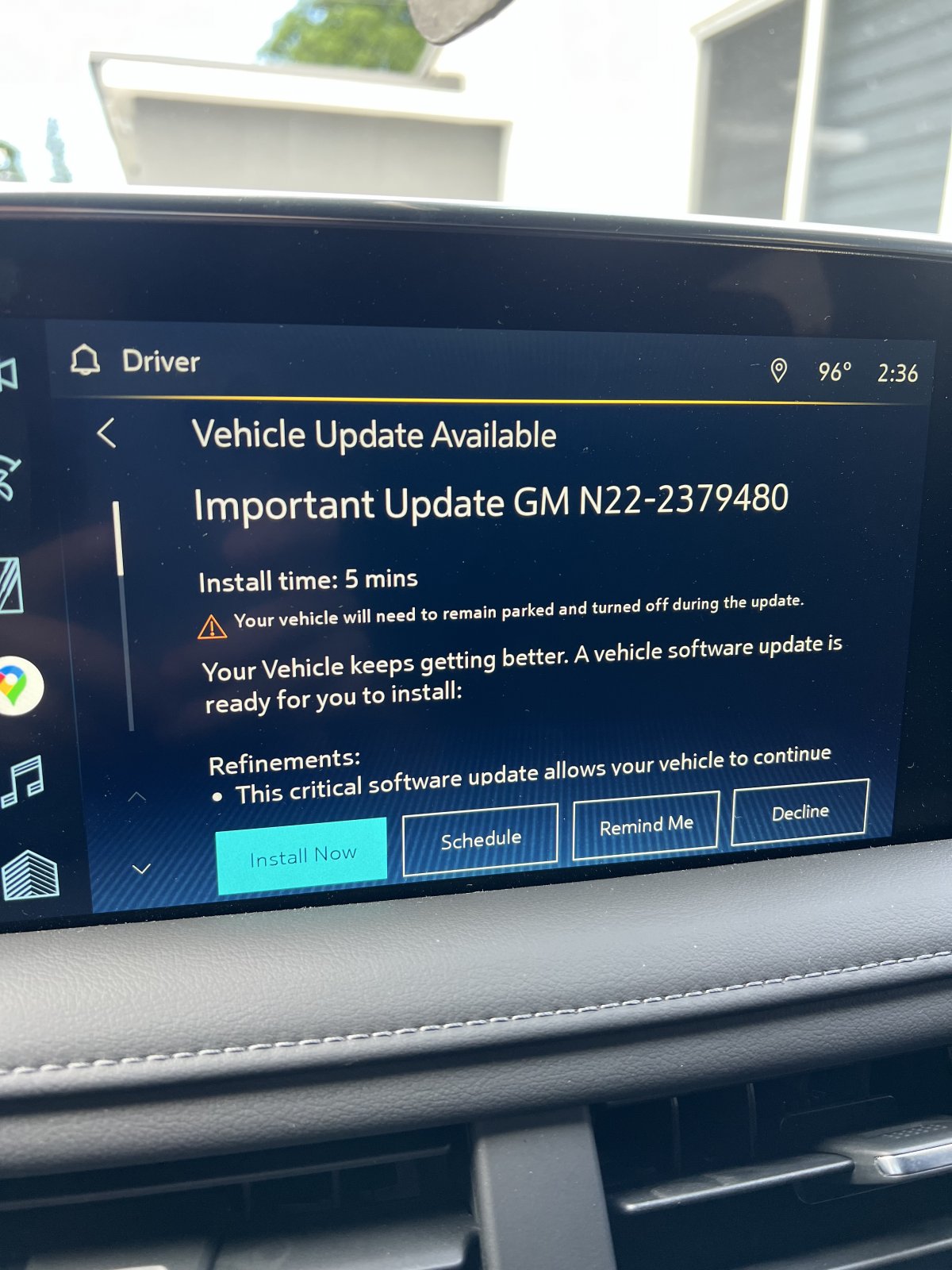

I was driving my '22 Tahoe over the weekend in the grocery store parking lot, car shut off while driving. Attempted to put in park and wouldnt go out of drive, got in neutral and attempted to start again and the starter ran for 15ish seconds without beginning to run. Then I was prompted to do the update. A few minutes later I was able to get the car into park and move to a space so I could do the update... Really glad I wasnt travelling at a high rate of speed or in a busy road before the vehicle just shut off by itself....

Our 22 mentioned to my wife that it wanted to update, so today (when it was parked in the garage) I did the update, took a few minutes, but I haven't tried driving it again yet.

I did the update on MY 22 yukon, but the android build is still on W160 since I received thr truck on December 2021

Dealer updated mine yesterday...is on Build W165 now...monochrome google assistant icon and google maps icon now, play store and podcasts still google colored.
Was seamless, didn't forget any of my account info, carplay connections, etc...This is the 3rd Infotainment System upgrade dealer has applied to my vehicle...I always ask them to check for any updates at each oil change.
(I was expecting it to be W164, as that was the latest communicated, but apparently there was a new W165 version out).
Currently at 8500 miles on the clock, my plan will be to ask for updated calibrations at every service interval until warranty is out...
