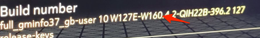

Sorry if its been answered, but how do you check your build number?
WalleyeMikeIII
Feb 22, 2022
2,765
2,631
Sunny and Snowy Minnesota
See Post #15.
You access that screen via Settings --> Vehicle --> System
In that example, that is build W160.
