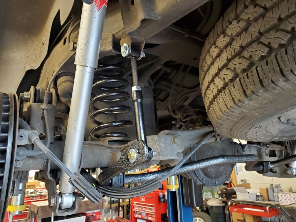

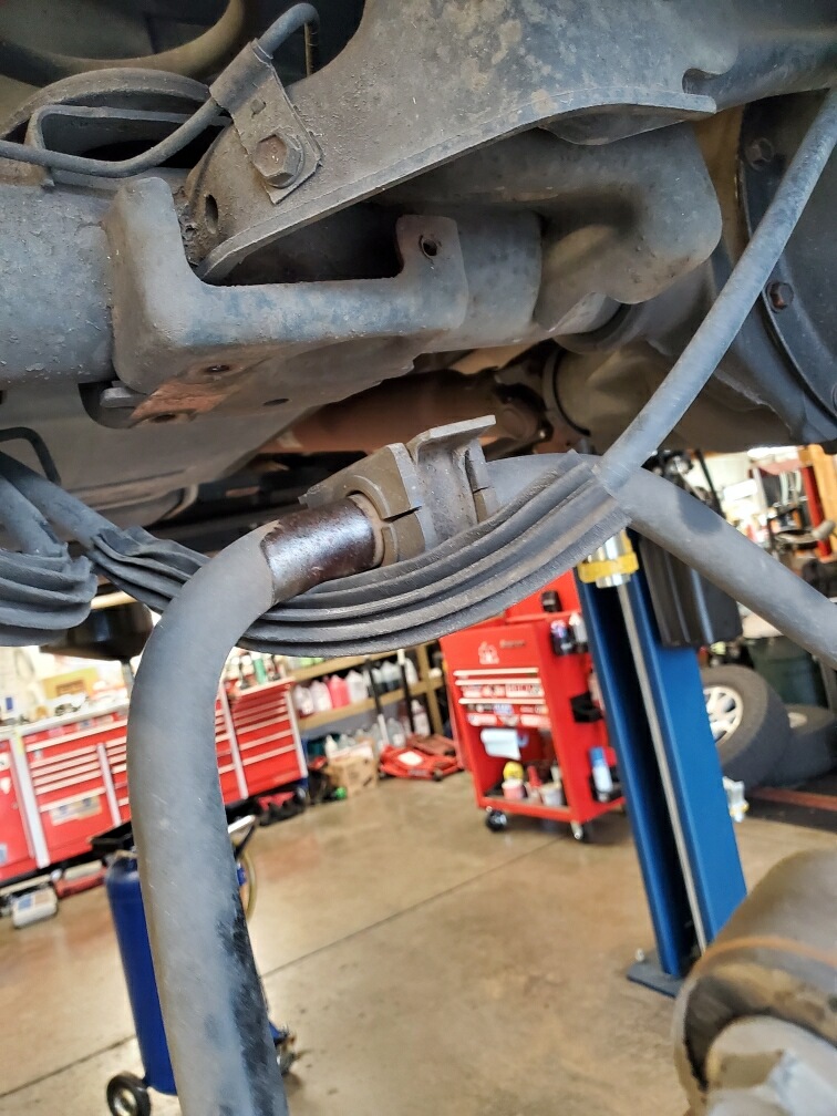

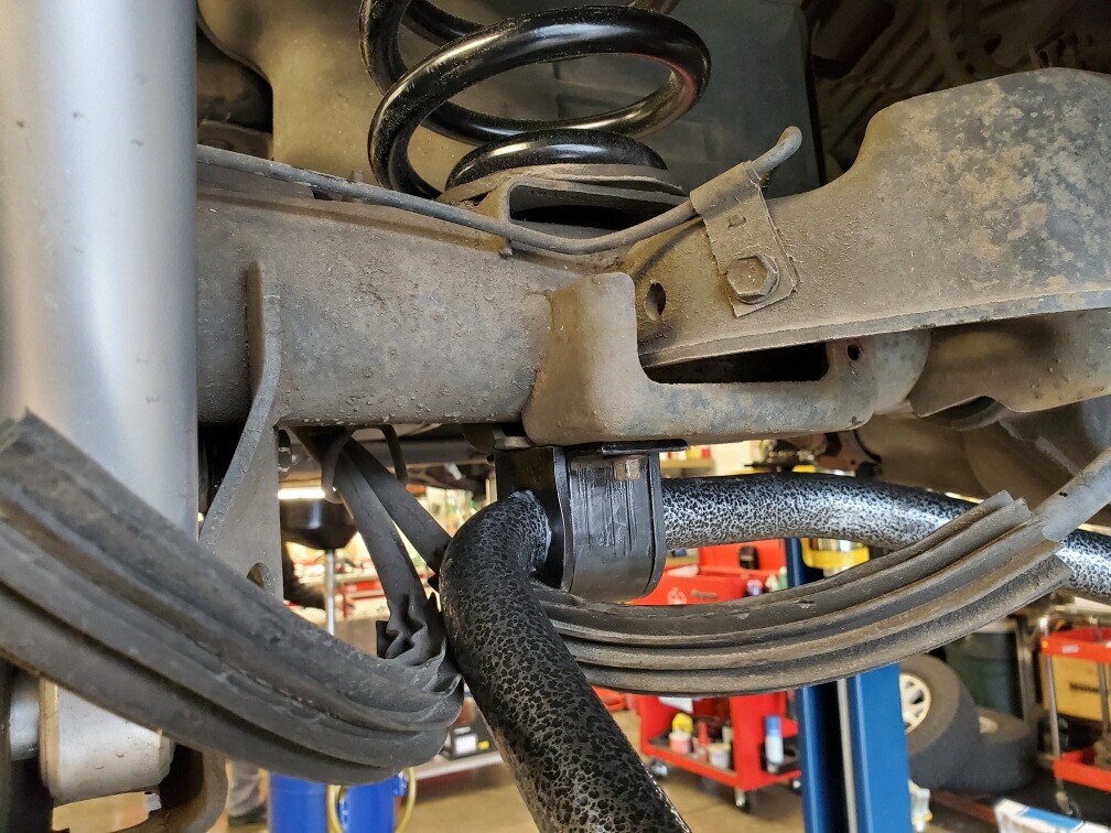

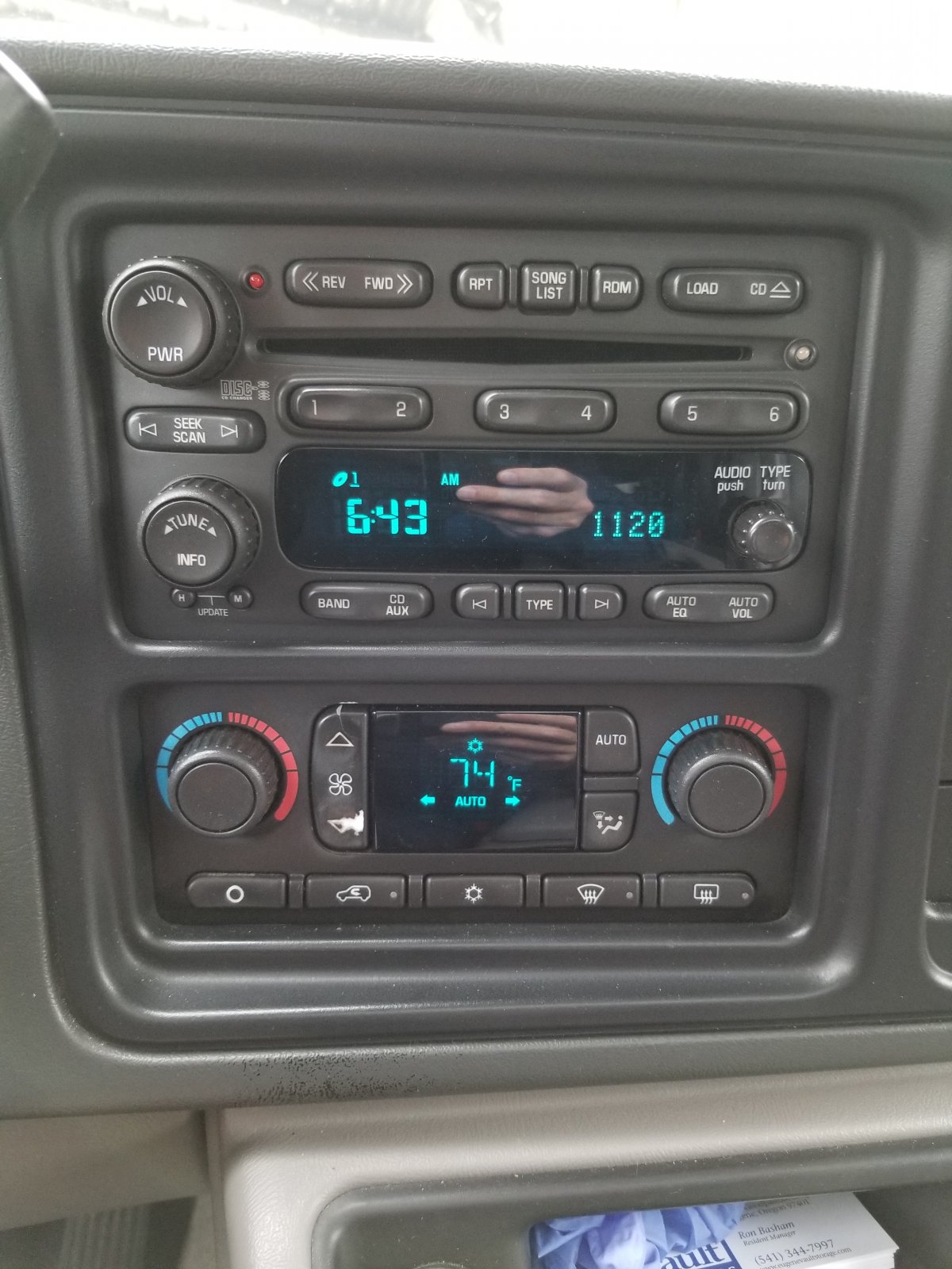

In one of the sway bar pics you can see the new rear coil springs. Here is the radio pic as well. Had to reset the clock, so that is the incorrect time that I took the pic.
I took it out on a road test today and there is a 45 MPH curve outside of town. I waited for the exact right time for traffic to clear and turned out and took off. I went thru that curve at 75 MPH and then turned around and went back thru it at 80 MPH.
That vehicle felt FLAT going thru that curve. It was an AMAZING feeling.
So sway bars are def worth it eh!

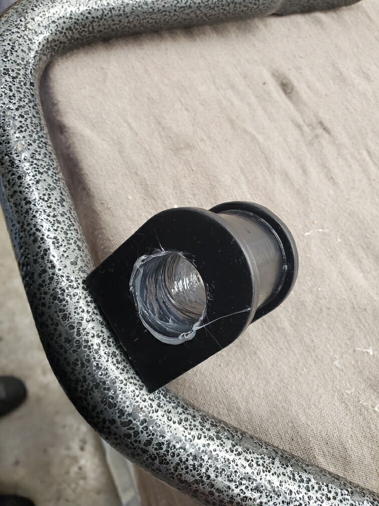

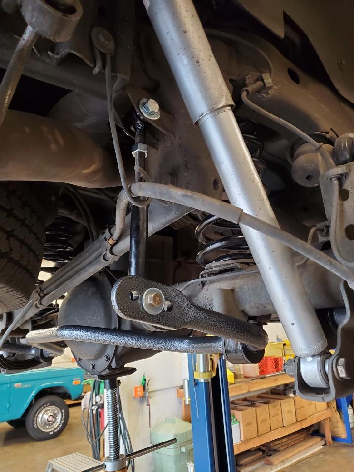

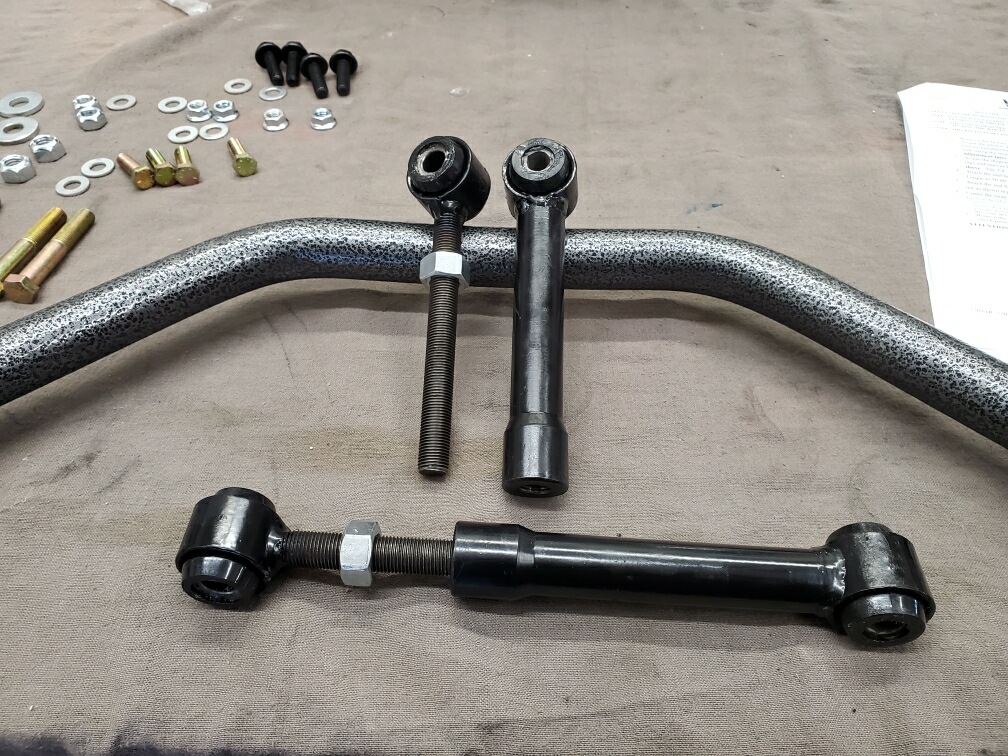

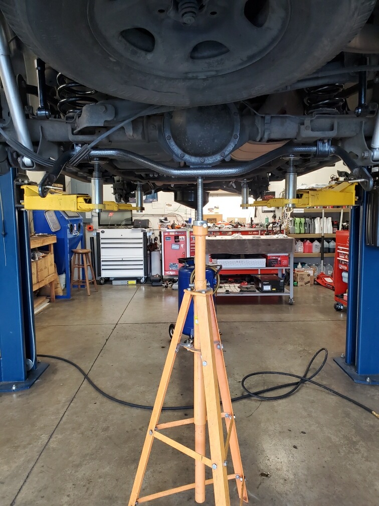

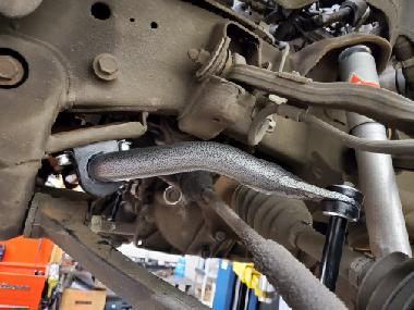

Ok, fortunately I was able to get my friends to allow me, with their help, to use their shop lift and tall jack stands to do the sway bar work. I just did not want to crawl around on the ground. They charged me some money for shop time and lended a hand when needed and helped with pics. I chose the mid range stiffness because I felt at that setting I would feel a "seat of the pants" difference over stock and could always adjust later if needed. The kits come with complete instructions. Follow them. I had AC Delco lube that I used for the door seals, hatch seal and the sun roof seal. I used that for all bushings. I can tell you that the seat of the pants feel is noticeable even with turns at lights and turning in to home driveway. Anywhere you turn you can feel it and the best feeling is at high speed in a curve. It's like the body leans just a hair but the frame down is stuck like glue to the road. The feedback feeling in the steering wheel is great.
