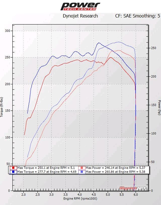

I found this article from an independent website that installed the JBA shortys on a 2008 5.3L pickup...
https://www.offroadxtreme.com/engin...ust-system-give-this-5-3l-v8-a-power-upgrade/
They dynoed it before and after the install of the shorty headers and aftermarket muffler and the results were pretty impressive I thought.
"When we ran the 2008 5.3-liter V8 Chevy Extra Cab pickup on the dyno before the installation, it recorded a peak hp rating of 246.1 at 5,370 rpm and peak torque of 250.1 at 5,100 rpm.
The after-installation run on the dyno showed 260.9 peak hp at 5,380 rpm and peak torque output of 277.7 at 4,690 rpm. That is a gain of 14.7 peak hp and 27.6 lb-ft of peak torque. However, as with any truck application, we’re more interested in gains in the low- and mid-range. The dyno chart below reveals healthy gains in these areas as high as 45 lb-ft of torque at the critical 2,500 rpm point. A power gain such as this down low will substantially help the truck’s acceleration and improve performance during normal driving conditions."
As with anything the peak numbers are one thing but the power curve and where you pickup gains is also very important.
They don't mention any tuning so I wonder what kind of gains might be had above their numbers with a proper tune.
