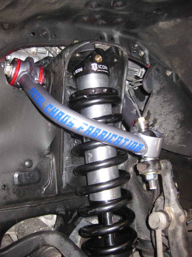

Uniball UCAs are better than just Moogs. Icon, Total Chaos and Camburg offer upgraded UCAs. They also offer extended length coil overs. I have the Icon coilovers/suspension and Total Chaos on another rig and they are awesome. Here is a picture of that setup on my FJ.
[/IMG]

Zed71, Nice looking setup there. I have looked at the Chaos UCA's, but after dropping $1000 on camera equipment and another $1000 on shocks, struts, tires, etc, I can't fit them in the budget right now. I will keep those in mind.
