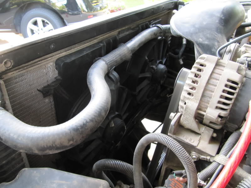

heres a pic of mine..for some reason they are on all the time..jenna what pin does justin use? the harness is from nelson, only cuz i bought it with the fans for cheap, and his is pin 41..

I thought it was pin 42 that was turned on for the electric fans. I had mine turned on just havent bought the harness yet so im stilll running a relay on my ls1 fans. I found me some 05 fans for 125!!! gonna go pic them up tuesday.
