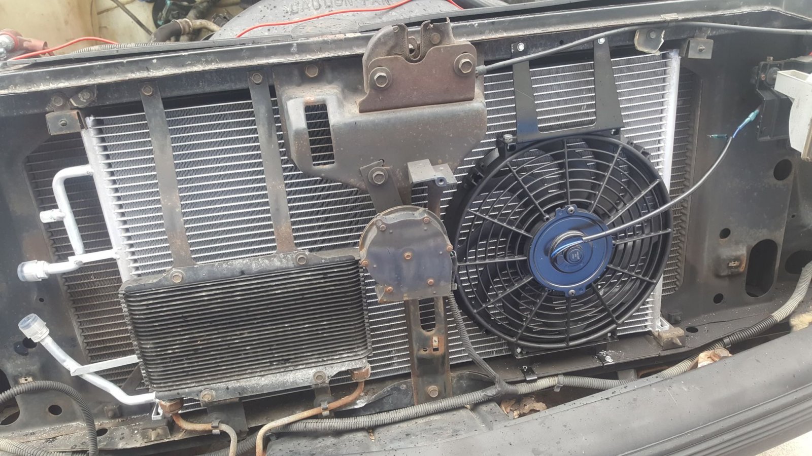

Making progress with the A/C system. Condenser and condenser fan is now in. Just have to wire it up and install the rest of the A/C lines.
