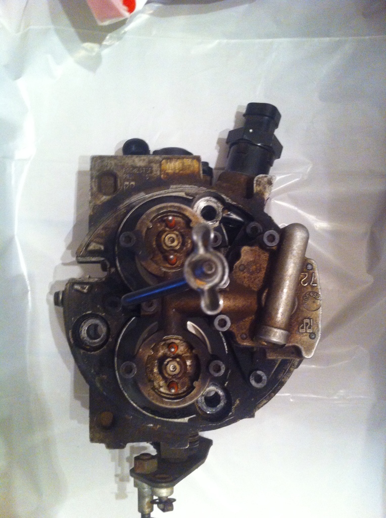

Sooo I got the TB rebuild done, unplugged the battery while I put it on to reset the ECM, plugged the battery back in after I was done and did a IAC relearn before cranking it. Immediately obvious that the passenger side injector was leaking, so I cut it off and redid all the o-rings in the pod. Cranked it back up, no leaks. But it runs like ****. It stalled the first time I put it in drive. However, after re-cranking it it did start to run better and it didn't stall the next time I put it in drive. Its been suggested that I run it 30 miles or so after a re-learn for it to get perfect, so we'll see. I needed beers while doing this and since my rear bumper is removed I don't have a license plate, so I'm not driving it tonight.
TB Before:
TB After:

Oh yeah I blasted and q-tipped the hell out of all ports, LOTS of **** came out.
Buttt, it seems to be running better, but the same problem exists...although I was unable to get it to stall. It did run perfectly smoothly going down the road and I can feel a power increase, but at idle once warmed up it still has the same problem. When I got back from a test drive today I left it in gear for a bit and videoed the tachometer and then cycled through gears. You can see what I'm talking about, every time you see the needle move the truck shakes. I'm really not sure where to go from here.
