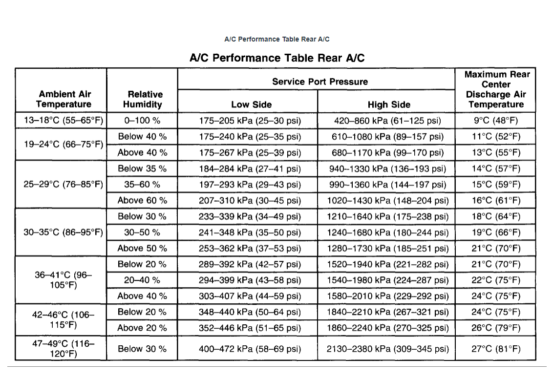

Donal

Yes, thank you for the table... but my question isn't about line pressures. I'm asking about clutch / compressor function. Does it cycle on and off to maintain line pressure? I assume cycling of the clutch, after AC is commanded on, is typically operation.
I think I may have answered my own question... Finally found a webpage that explained fixed nozzle size w/ orifice tube requires compressor to cycle on and off.
