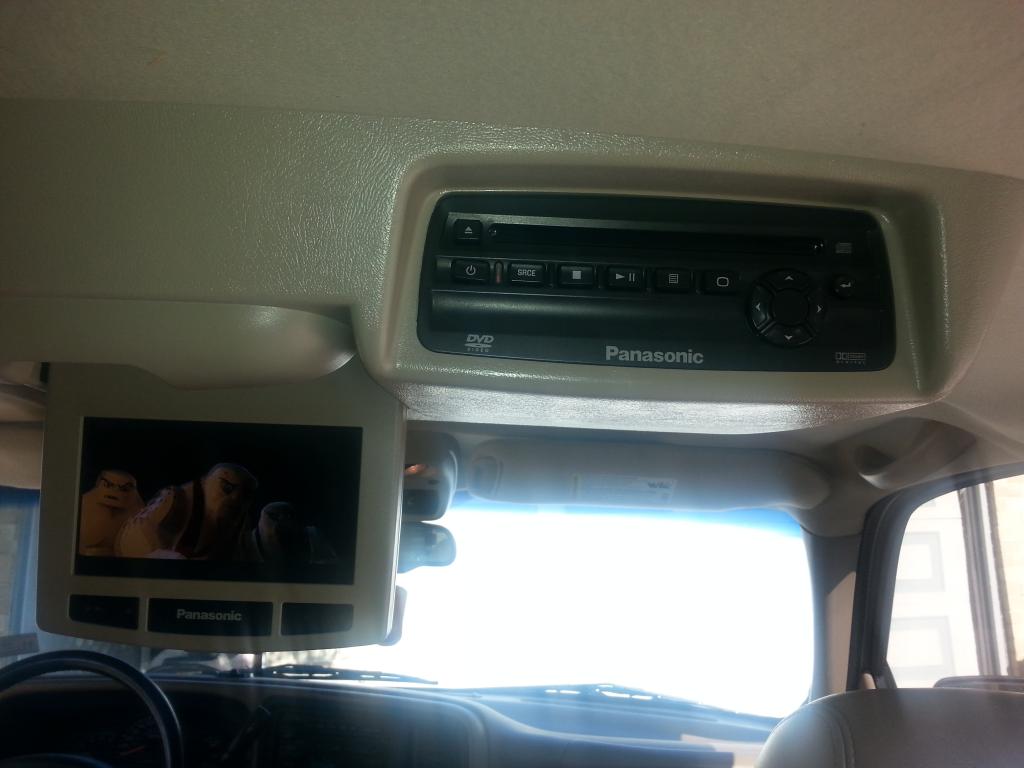

I have a 2004 Chevy Tahoe z71 with the standard Panasonic rear seat entertainment and I am NOT getting any audio through the speakers.I have turned on the DVD player in the back before changing the source on the front control module and all I hear is clicks from the speakers.the DVD player is working and the video is playing on the screen but I do not have any sound through the speakers here are a few photos that I thought might help

That silver cable has two connectors one blue the other clear.

That silver piece is probably an aftermarket RCA
Any pic of the Panasonic unit?
Do the headphones work?

Do you have the IR headphones? Do they work?

The head phones put out the same clicking sound.
---------- Post added at 05:34 PM ---------- Previous post was at 05:34 PM ----------
No I don't have those but tried wired ones

I wonder if the wired headphones is the same signal to the RSE on the radio. Possible the audio out signal could be bad. I'm still interested to know what that silver wire is, since I don't think it's OEM.
This is what that unit looks like down
This is the audio + wire from the dvd player to the RSE
and just a close up of the wiring harness in general
are you skilled enough to pot that down and see if anythings cut?

I think I'm going to take it to someone to have it looked at. I probably could but would have to have a day free to make sure I could get it all back together, unless I have a detailed writeup on how to take it off and put it back.
