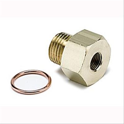

Yeah I'd hook a manual gauge before you freak out anymore. Doing it with the intake on is very simple. Was able to do it with my fat fingers. The hardest part by far is getting the hose for the manual gauge on which required lots of choice words. Get a 1 1/16in oil pressure sending unit socket(a regular 1 1/16 would not fit over the unit for me) then a 3/8 wobble socket, followed by a 6 inch extension then a ratchet, then you should be able to get it off.
Most manual gauges wont come with the right size threads for where the sender goes. So you'll need to order an adapter.

For a pressure gauge: M16-1.5 male to 1/8" NPT female:
