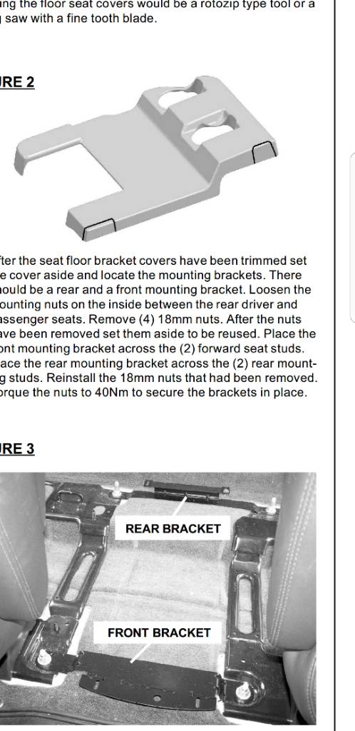

Hello.
I'm looking for the mounting brackets for the rear center console specifically the rear one. If by chance you never hard mounted yours and want to sell me the brackets please pm me.

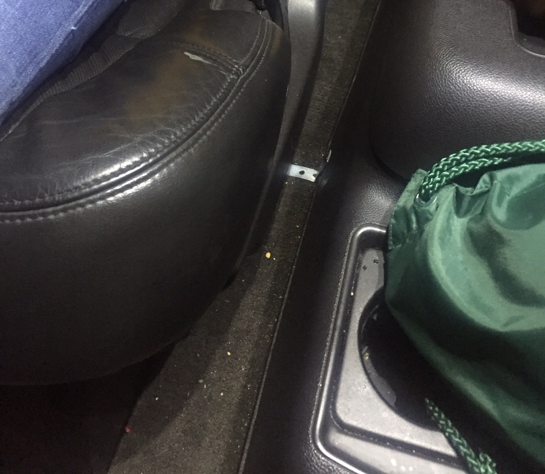

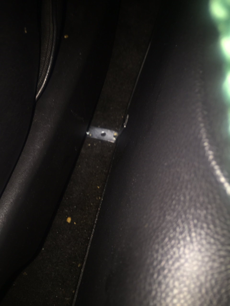

I just bought two L shaped brackets from Home Depot and screwed it down into the carpet. I'll snap a pic later.

And the console doesn't move at all. One L bracket on each side.
