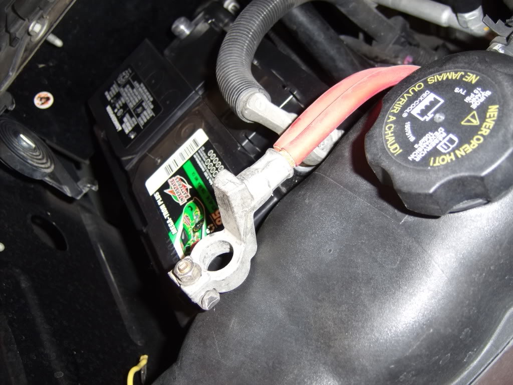

What did you do with the smaller wire that was snipped from the negative terminal? Was it just taped and left alone or reconnected?

In the BIG 3 wiring upgrade the positive battery wire to the alternator needs to be upgraded to a thicker gauge. The negative battery terminal should also be grounded directly to the chassis with the same thick gauge. You will also need to upgrade the engine to chassis ground in the same thick gauge. On the NNBS, the negative battery terminal is grounded to the engine block only, not the chassis. In the write up I change that and ground it to the chassis while also adding a separate ground wire from the chassis to engine block.
As for the positive wiring, the factory positive terminal has two wires coming out from it. One goes to somewhere under the engine block. The other is short and goes to the factory fused distribution block. The block then separates this wire into two thinner wires which go to the engine fuse box and alternator.

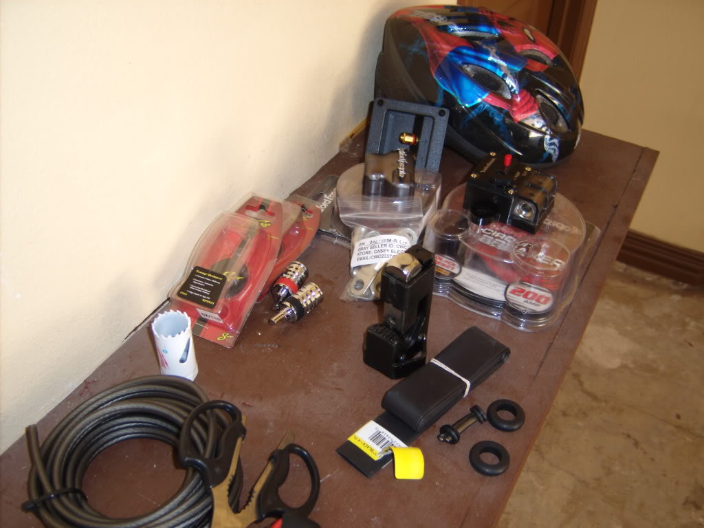

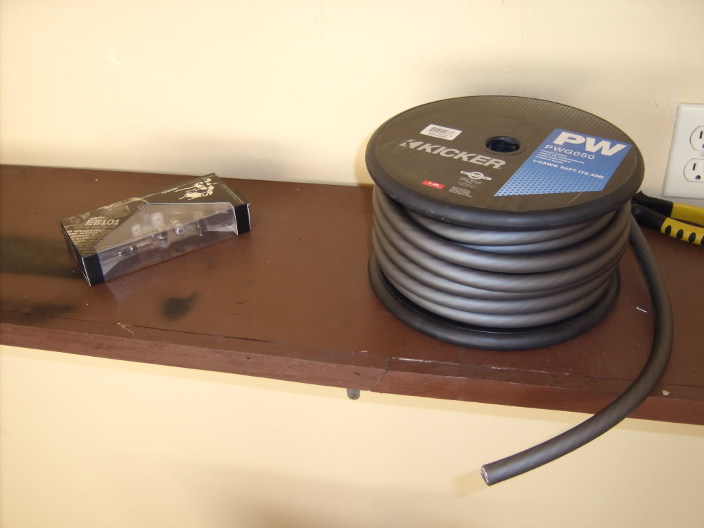

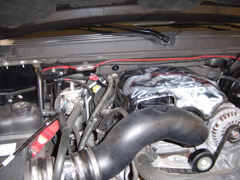

I gathered all the parts together for the build in the pic below. The retailer I bought the spool (50 feet) of Kicker Hyperflex 0 Gauge wire from through in a set of Kicker headphones for free.

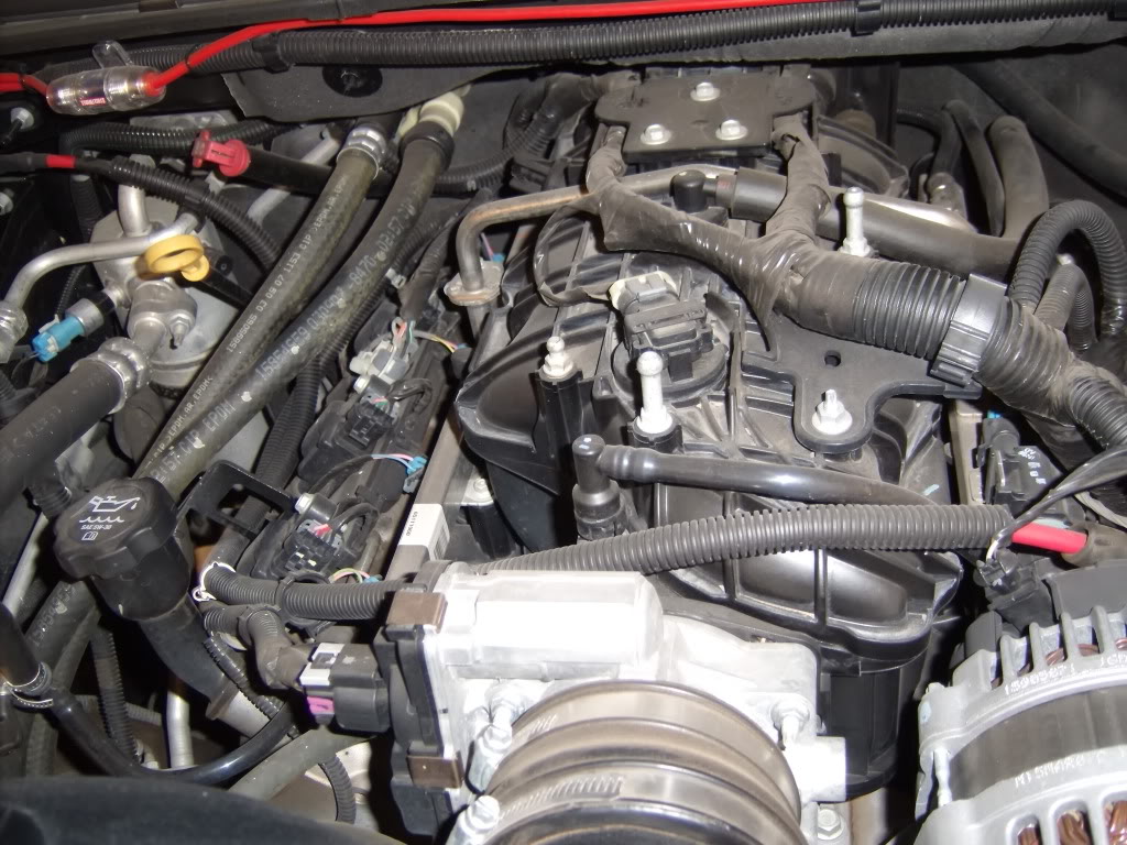

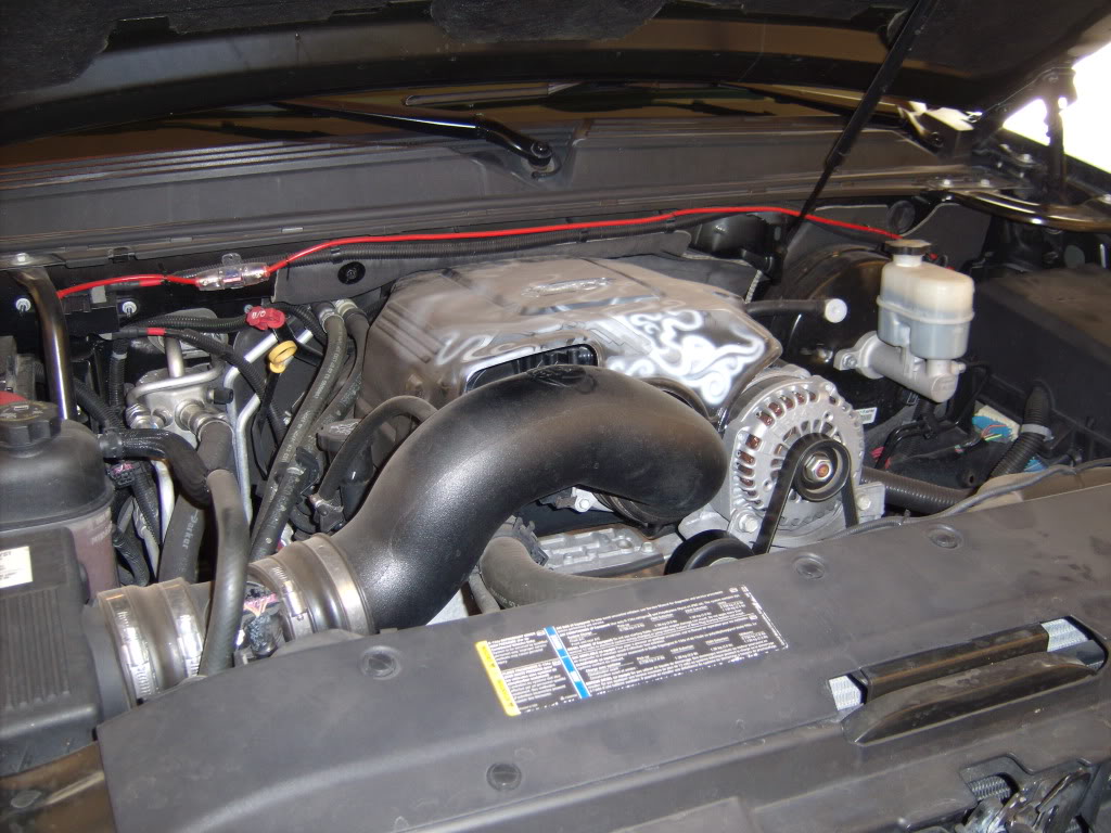

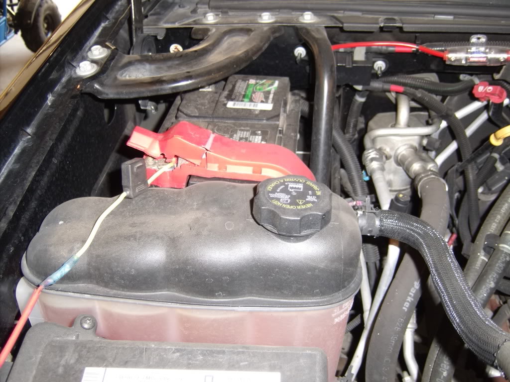

I started with a pic of my engine bay to show the relative locations and stock set up. I also have an 8 gauge wiring kit for my old audio setup in there. Ignore it because if you do not have an aftermarket audio system you will not have a wire like the red one I have running along the top. I also have the power wire for my HIDs the yellow one) showing. Ignore that also if you do not have HIDs. And yeah I know my engine bay is dusty. I have been meaning to wash it off lately but haven’t in about three months.

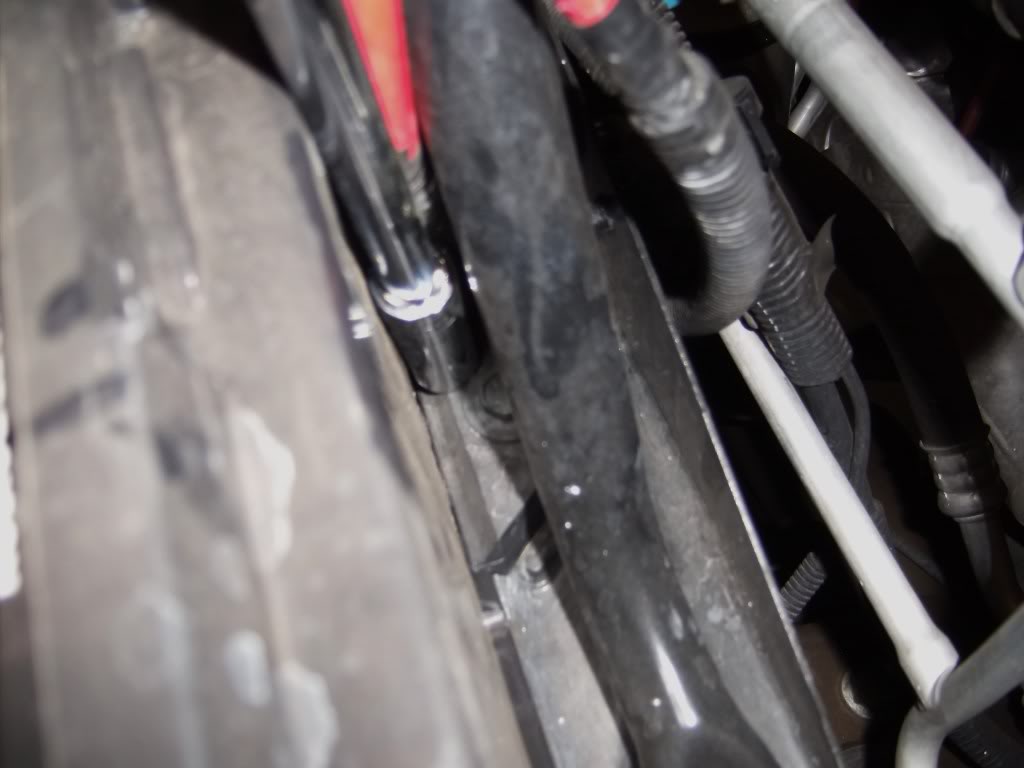

You will need to remove the battery next. Disconnect the positive and negative terminals with a 10mm deep socket and a ratchet. Then you will have to remove the fender elbow above the battery so that you can get the battery out. You will need a 12mm socket for this. There are four bolts that hold it in. View attachment 130021

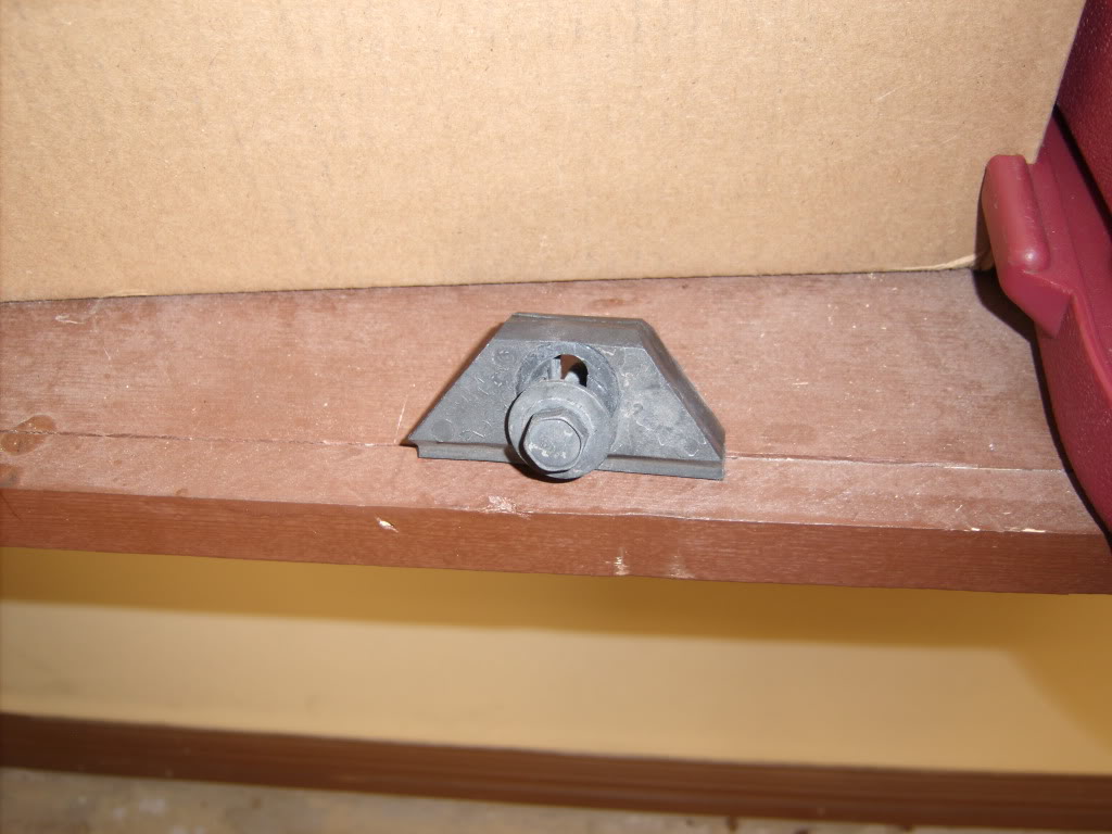

Then remove the battery base clamp with a 13mm deep socket and an extension. I pointed to beside it with the socket. View attachment 130022
This is what the clamp looks like after removal. View attachment 130023

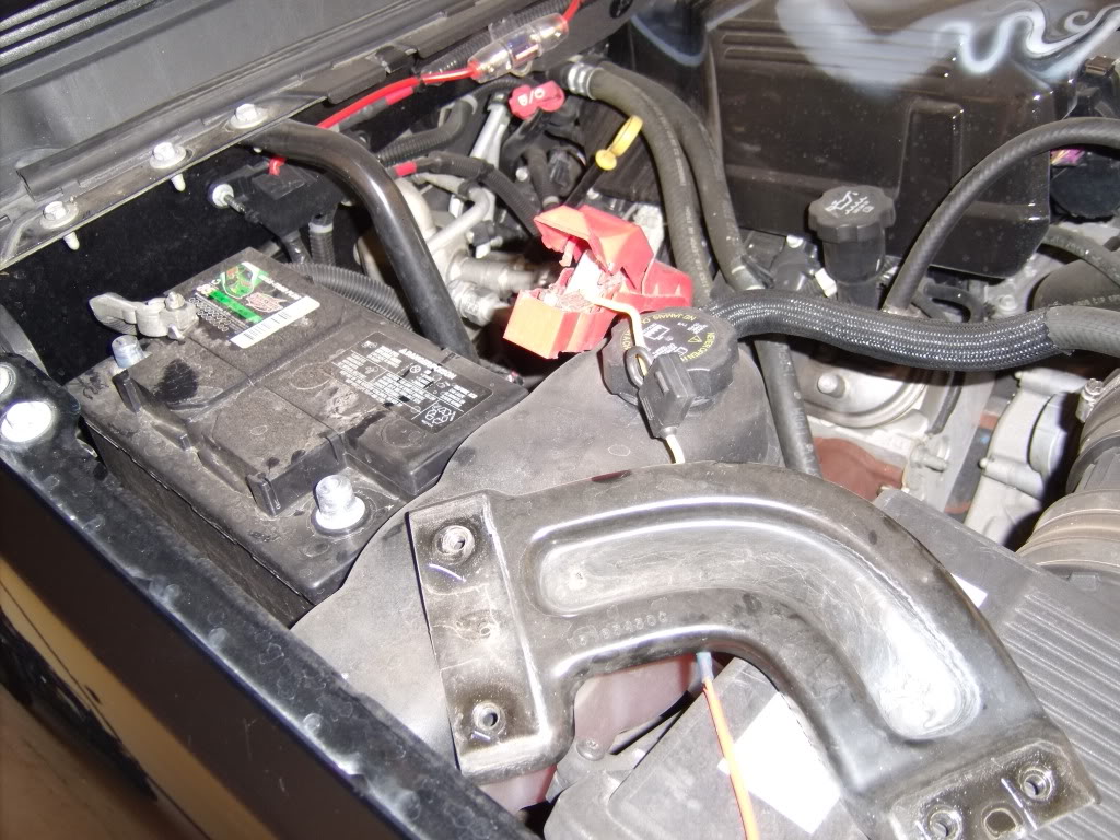

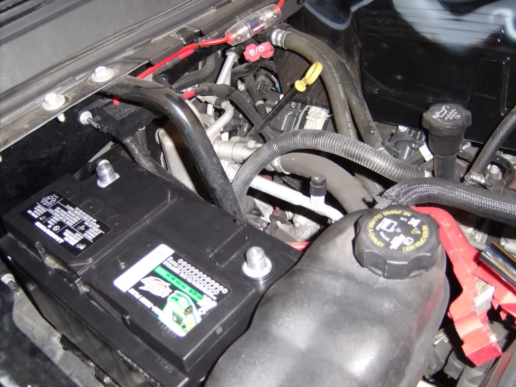

Now after the battery is out it will look like this.

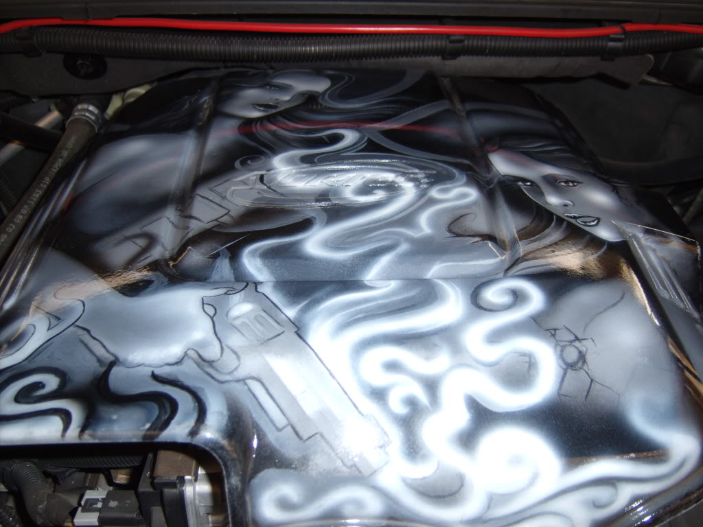

For those wondering, the engine cover has two girls airbrushed on it.
---------- Post added at 01:13 AM ---------- Previous post was at 01:12 AM ----------
[/COLOR]After I got the battery out I wiped it down and reinstalled it in a flipped position. So now the terminals face in, not out. You will have to do this if you have the stock battery (or an aftermarket replacement battery with the same casing as the stock one) because the terminals are recessed. It is impossible to install aftermarket battery terminals (which you need for such a build) while the battery is in the stock position due to these recessed terminals. This is what it looks like flipped and cleaned up. View attachment 130026

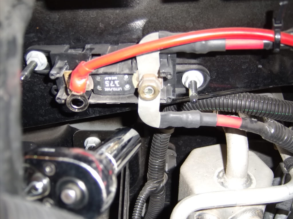

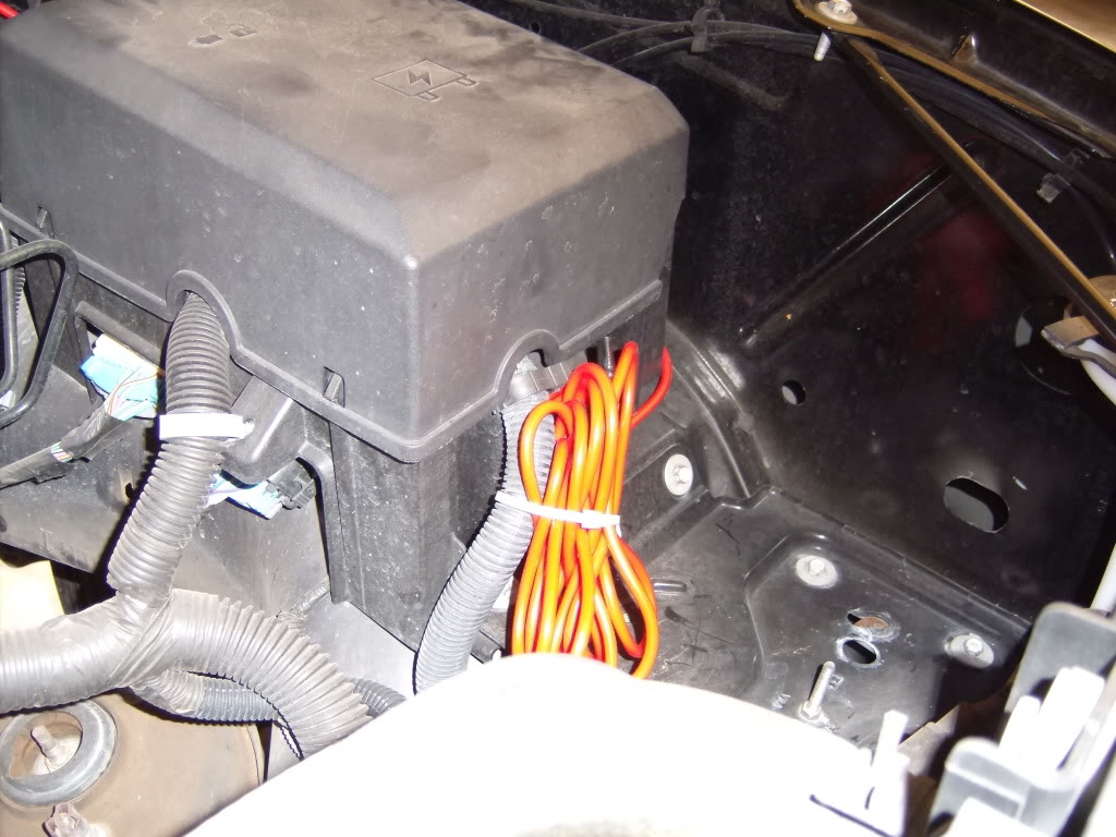

Next, you need to locate the stock fused distribution block. It is pictured in the last step to the immediate top right of the battery. Remove the cover by squeezing the sides of the cover. After removal it looks like this. View attachment 130027
Again, ignore my amp connection to the distribution block. BTW, if you are ever installing a minor system (500w RMS and under) get your power before the dist. block fuse, not after. This prevents a possible electrical cripple if something shorts out. Also fuse your amp wire right before it gets to the front portion of the distribution block like I did to mine.

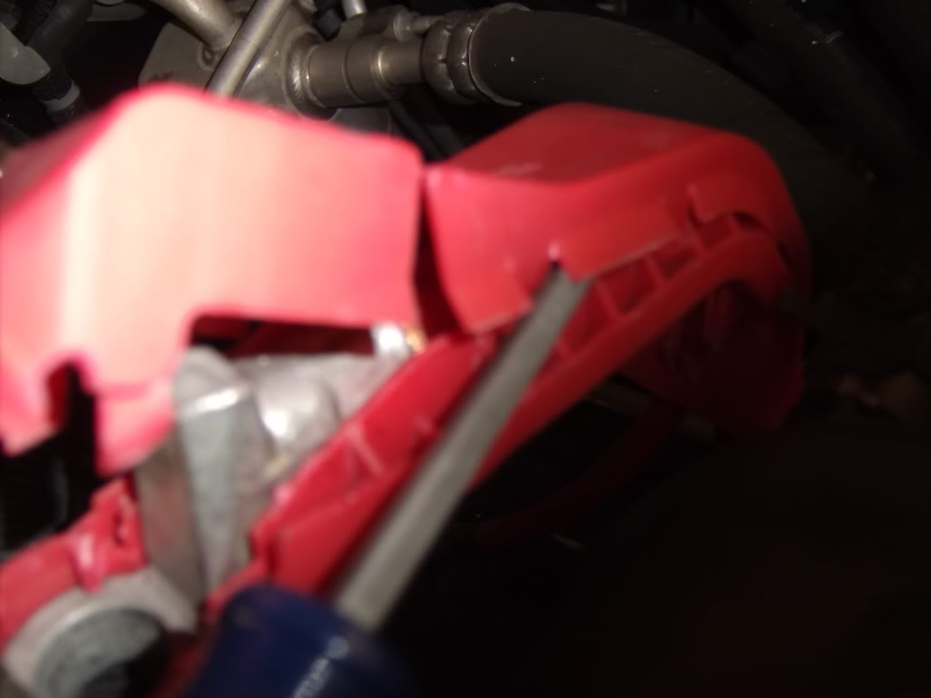

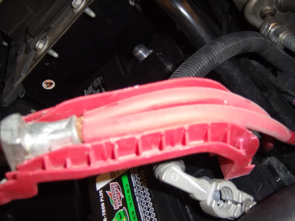

Next, remove the red plastic OE positive battery terminal wiring cover. You can use a flat screw driver to do this. Just slip it in the sides and pop them up. View attachment 130028
It will look like this when you get the top of the cover off. View attachment 130029
It will then look like this with the whole thing off. View attachment 130030

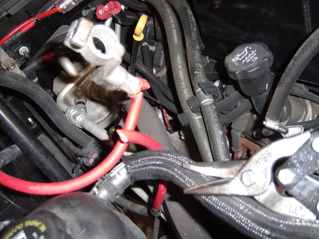

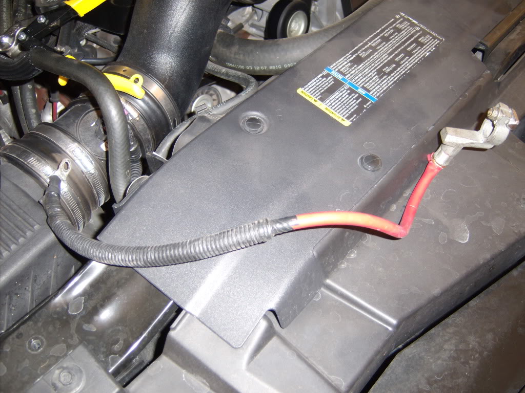

Now you will need to follow the two positive terminal wires. One goes to the fused distribution block. The other goes to the underside of the engine bay. Cut the wire that goes to under the engine bay from the factory terminal. It is crimped so well from the factory it cannot be pulled from the terminal. It looks like this after being cut with a metal snip. Exercise caution when using these snips because they are sharp enough to seriously injure you. View attachment 130031
I then removed the other positive terminal wire from the distribution block with a 13mm deep socket. Then you can completely remove the stock positive terminal wiring. View attachment 130032
The terminal looks like this after removing the wire from the above pic. View attachment 130033

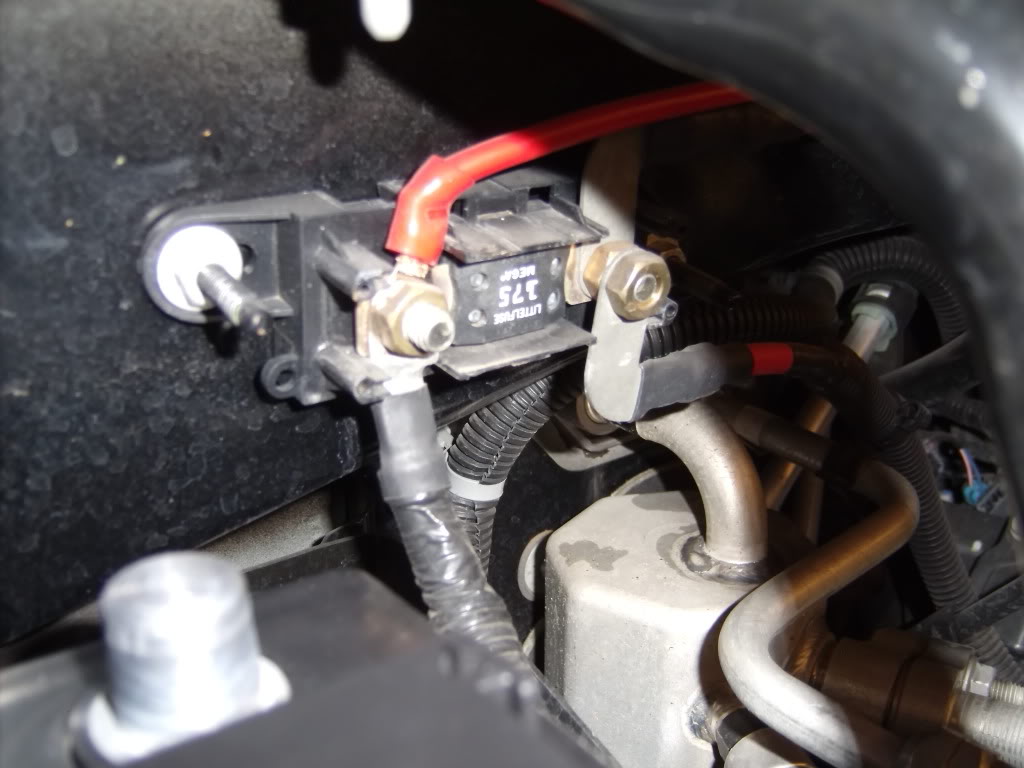

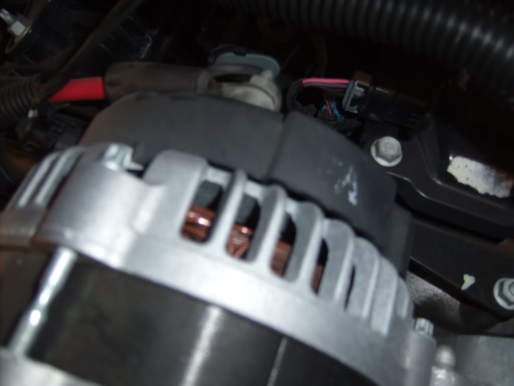

Again, ignore the red aftermarket wire. Now, use the last pic to remove the connector that goes from the distribution block to the alternator. It is on the bottom part of the fused block and you will need a 13mm deep socket for removal.
The two positive wires after the distribution block fuse go to the engine bay fuse box and alternator. The wire at the back of the alt. that goes to the distribution block looks like this. View attachment 130034

In the picture with the negative terminal, where does that stock smaller wire go?
B-Watt
Jan 23, 2022
8
Just saw this. That wire was reconnected on the aftermarket negative terminal.
